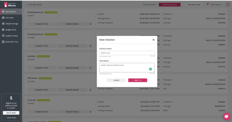

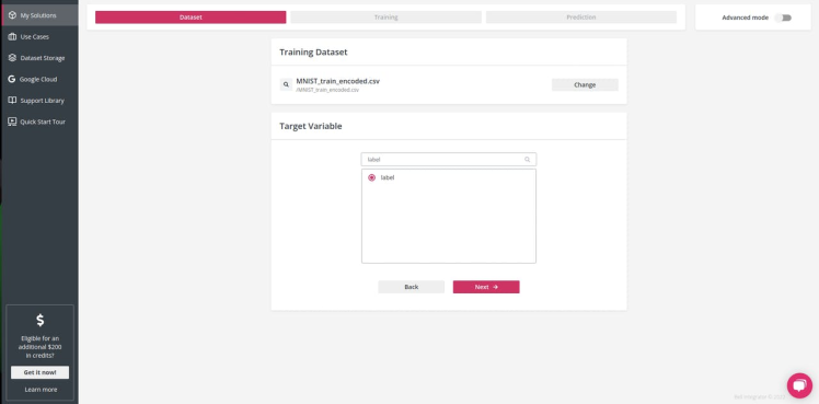

Step 1: Create a new solution on the Neuton AI platform
Step 2: Upload the dataset and select the target variable, in our case 'label'
1 / 2

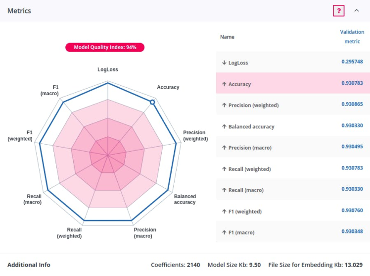

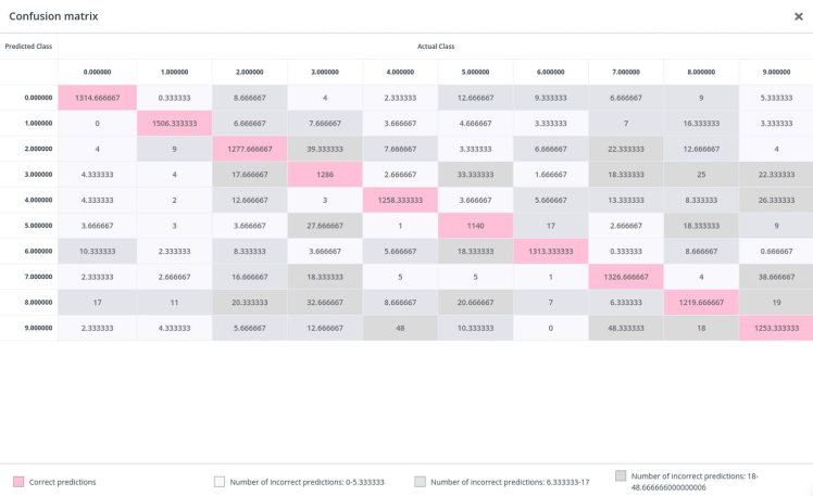

Step 3: Start the training (Since MNIST is a vast dataset, training could be time-consuming but you can stop it once you are convinced that the accuracy is appropriate). I stopped the training at ~94% accuracy.
Here's the confusion matrix which would give a better idea about our model accuracy per label.

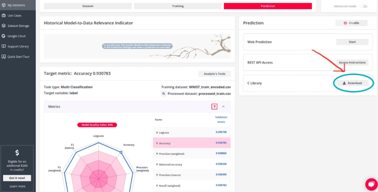

Download the model which we will embed on our device. The best part about Neuton TinyML is that it builds extremely light models, even on large datasets like MNIST. Coefficients: 2140 Model Size Kb: 9.50 File Size for Embedding Kb: 13.029

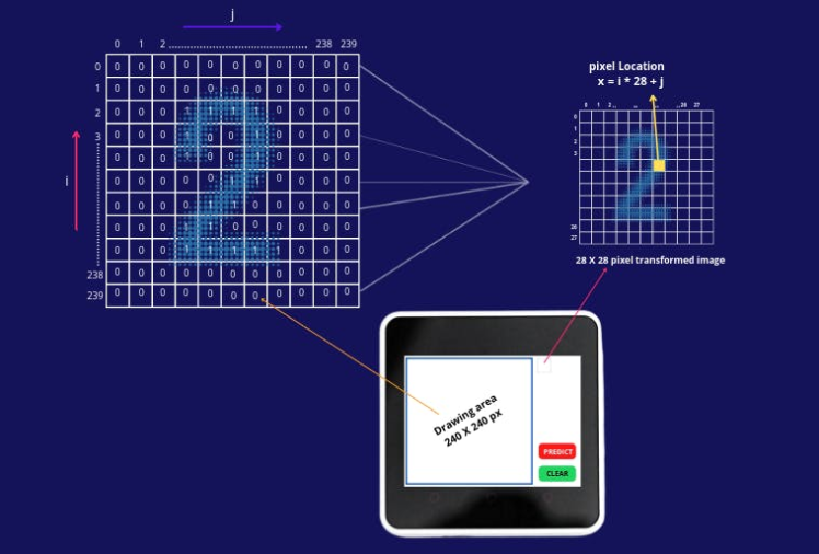

When a user drags a finger over the input area, the M5Core2 library continually draws a single-pixel under the finger. The Clear button simply sets the colour of pixels inside both the input and result areas to the background colour. The Predict button saves references to the input area, the underlying bitmap, and the width and height of the area, and then passes them to a native Neuton Inference Handler code, which processes the input image. To make the application use more comfortable, the created input area has a size of 240x240px. However, the actual input image for the machine learning model must be 28x28 pixels large. Therefore, we scale down the input area image by a factor of 28/240, no heavy distortion of the input image was found using this technique for MNIST digits.

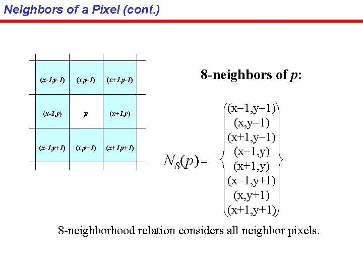

First, a 2D array with the width and height of the image area [28 X 28] is created. We then use the 8-neighbors pixel grouping technique to resize our 240 X 240 px drawing area to 28 X 28 pixels.
We first locate the TouchPoint coordinates for our LCD and translate them to get new x and y coordinates for our target image.
TouchPoint_t coordinate;
coordinate = M5.Touch.getPressPoint();
int x = coordinate.y * ((float)28 / 240);
int y = coordinate.x * ((float)28 / 240);
For the new coordinates X and Y, we set value 1 to all 8 neighboring pixels, this way we ensure the proper thickness and size to be fed into the Neural Net model.

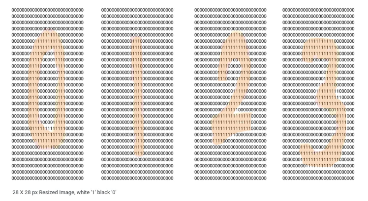

We must eliminate the irrelevant pixels outside the input area when detecting touched pixels. The amount is always the same since the pixels are stored continuously by row from left to right. Once the input is extracted, it resembles the format of the MNIST images a bit more. See the below image for our resized input image of 28 X 28 pixels after processing the pixels obtained on the 240 X 240 drawing area.
Once you get the input image of 28 X 28 pixels, we flatten the 2D input image array to a 1D array using the pixel array decomposition method used in the Kaggle dataset x = i * 28 + j

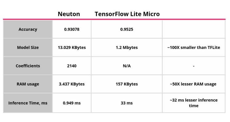

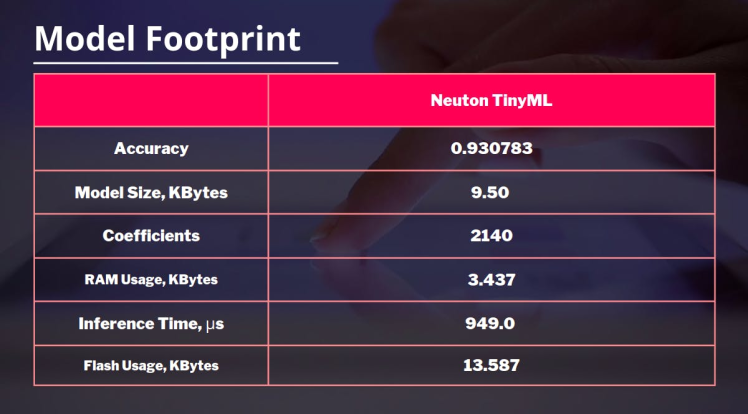

This experiment demonstrates much better results compared to TensorFlow Lite MCU models where the entire network needs 157 KBytes of RAM and 1.2 MBytes of Flash. In our case, the model only required ~3 KBytes of RAM and ~10 KBytes of Flash.
