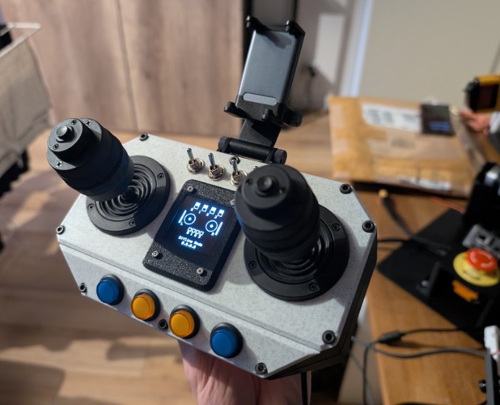

My attempt to create a single remote that I can use for all of my robotics projects.
Components:
- ESP32-S3-DevKitC (for ADC, Wi-Fi, BLE, HID)
- 2 × 3-axis joysticks
- 4 × switches
- 4 × buttons
- 1 × 128×128 I²C screen
- Phone support
Features:
- mDNS discovery
- BLE discovery service
- HID device emulation
- Detected device selection screen
- Input state visualization on screen
Current Usage:
The robots I make use ESP8266/ESP32 boards, host a WebSocket server, and use mDNS to provide the WebSocket credentials.
1) The remote detects and lists mDNS devices.
2) User selects the device they want to connect to.
3) Remote connect to robot ws message queue.
4) Remote posts messages to /remote/input
5) Robot react to remote topic.
I am also working on a web app for phone. The phone discovers the remote via BLE, allowing the remote to share the robot’s WebSocket settings with the web app.

    I made a new version of this remote controller—happy with how it turned out !
    The PCB inside will need a new version; the board was designed for a Teensy, but I ended up wiring it by hand to use an ESP32-S3-DevKitC, which has enough ADCs, Wi-Fi, and HID emulation..
    I think I’ll also try to make the white parts as PCBs, since I reworked the 3D file to have multiple flat parts that could be made as PCBs with silkscreen printing
