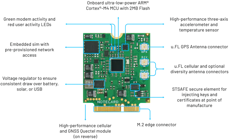

Luckily, Blues Wireless has hardware that solves for both of these problems. The Blues Wireless Notecard provides prepaid global cellular access, which incudes 500MB of data and 10 years of service. The model I chose works well with both LTE-M and NB-IoT protocols, and it's extremely low-power at just ~8uA when idle.
Notecard specs from the Blues Wireless site.

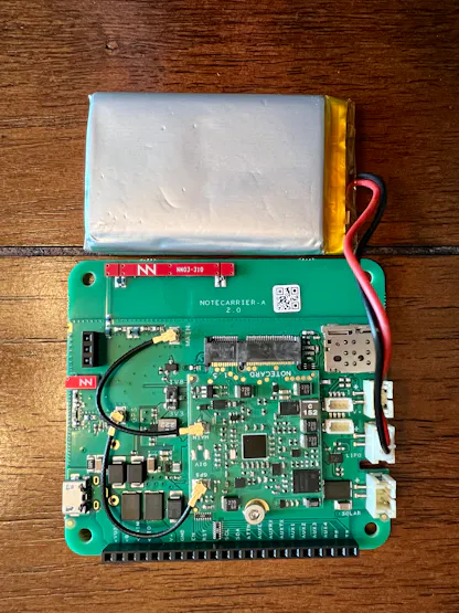

In addition to my Notecard, I used a Blues Wireless Notecarrier AL which is a companion prototyping board for the Notecard with onboard cellular and GPS antennas.
I chose the Notecarrier AL version in particular because it has JST connectors for a LiPo battery, but there is also version a that uses AA batteries, and all of the Notecarrier boards also have micro-USB connectors that can power the device and provide a USB interface to a Notecard.
Notecarrier A-series specs from the Blues Wireless site.
That last piece of this puzzle is the power source. As I mentioned, I went with the Notecarrier AL, which has JST connectors for a LiPo battery, so I bought an Adafruit Lithium Ion Polymer Batter - 3.7v 2500mAh to power the whole shebang.
Now put it all together: screw in the Notecard to the Notecarrier, attach the cellular and GPS antenna and connectors on the board to the Notecard, and plug the LiPo battery in to the JST connector port labelled "LiPo".
The fully assembled Notecard, Notecarrier and LiPo battery set up.

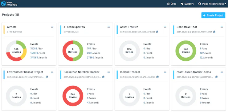

Set Up a Notehub Project for the Tracker to Report To
Before setting up the Notecard itself with its marching orders, we need to create a new cloud project in Notehub.io to direct the Notecard's data to.
Since the Notecard is a device-to-cloud data pump, it doesn't live on the public Internet (making it an extremely secure device) and therefore needs a proxy with which to sync data: Notehub.
A handful of my Blues Wireless Notehub projects
Notehub is a thin cloud service that securely accepts data from the cellular Notecard (off the public Internet, using private VPN tunnels) and then instantly routes the data to the cloud provider of your choice (be it AWS, Azure, Google Cloud, or any IoT-optimized service like Ubidots, Datacake, Losant, and others).

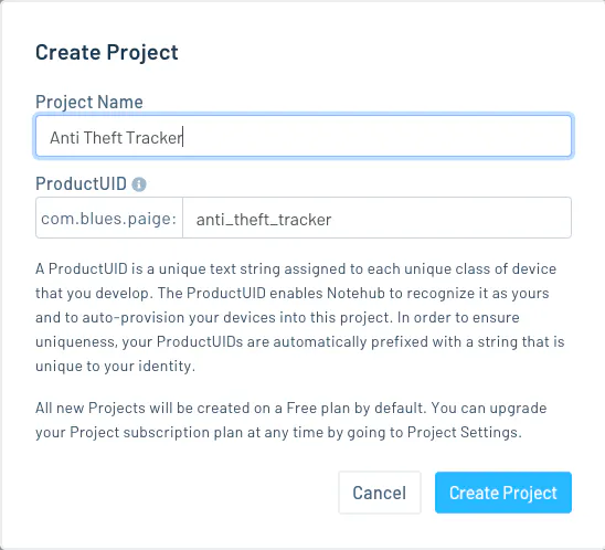

1. If you haven't already, create an account with Notehub now. It's free for up to the first 5, 000 routed events per month (routed event = data transmissions from Notehub to your cloud endpoint of choice). This should be way more than what's needed (hopefully) for this anti-theft device.
2. After signing up, click the "Create Project" button in the top right of the Notehub screen and fill in the project details.
Notehub create a new project modal.
Copy the project UID after the new project is created - we'll need it when configuring the Notecarrier itself.

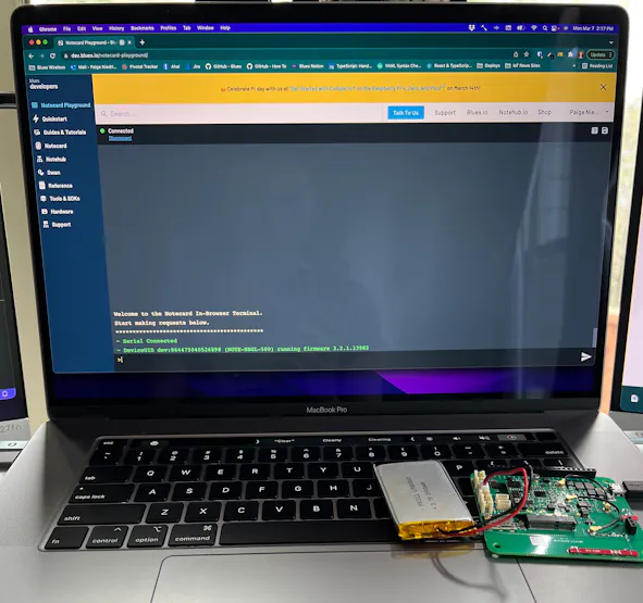

If you've not configured a Notecard before, not to worry, Blues aims to make this experience easy as well with simple JSON commands.
While there is a full-scale Notecard CLI you can download to your local machine to interface with the Notecard, I tend to use the web-based Notecard CLI built in to our developer experience site. It's easier in my mind.
All you need is a micro-USB to USB-A converter cable to plug it in to your laptop and begin interacting with your Notecard.
My Notecard and Notecarrier attached to my laptop via micro-USB connector using the Blues Wireless browser-based Notecard CLI.
Once you're connected to your Notecard issue the following set of commands to it.

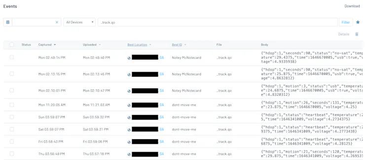

Generate Some Test Tracking Events in Notehub
Now take the Notecard on a walk or a drive to see the kind of data it's generating and sending to Notehub.
Inside of the Notehub project, click on the "Events" tab, and inside the filter input put in _track.qo to see a list of the tracking events your Notecard should be generating.
An example of _track.qo data generated in a Notehub project.
As you can see if you look closely at the image, my Notecard is reporting a mixture of heartbeat (motion-less) data and motion detected data.
Put a pin in that, though, we'll figure out a way to sort through this data and prevent sending false positives to Twilio.

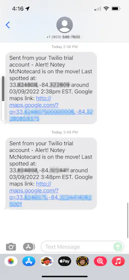

Send Motion Alerts with Location Data via Twilio
Ok! It's time to start sending some of these _track.qo events to Twilio.

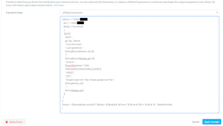

2. Paste in this JSONata code instead inside of your Twilio route's Transform Data section

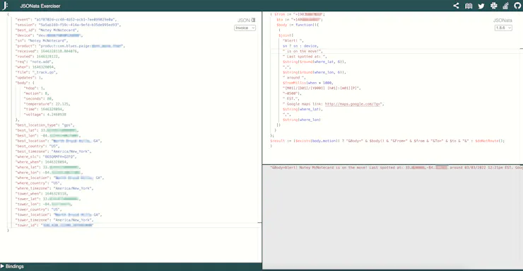

If you read through the majority of the Twilio starter guide instructions you probably reached the part about transforming the original Notecard payload via JSONata before sending it on to Twilio.
JSONata, if you're not familiar with it (I wasn't before now), is a lightweight query and transformation language for JSON data. The syntax takes some getting used to, but once it's working, it's pretty cool.
And another neat thing I learned about Notehub, is that any notefile payload can be run though a JSONata transformation function to cut out most of the JSON we don't care about and only route out the important bits to wherever the info is bound next (Twilio, in our case).
So here's version 1 of the JSONata to paste into your Transform Data section in Notehub:

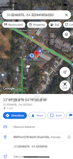

2B. Add a Google Maps link for convenience
Ok, this should prevent false positives from getting through, but there's one more enhancement I want to make to this message. I don't know about you, but if I had something being stolen, seeing the GPS coordinates printed out isn't particularly useful in the heat of the moment.
I'd like to be able to click a link in the SMS and see those coordinates displayed on a map.
Contrary to what you might think, there's currently no universally agreed upon way to construct GPS coordinates in a text message so that an iPhone or Android messaging service will recognize they are coordinates (like they do for phone numbers and addresses) and automatically hyperlink them to open a map app on a phone.
Instead we must do it ourselves. So my workaround is to provide a Google Maps hyperlink at the end of the message which users can choose to click on or not (I figure Google Maps is an almost universally used app regardless of phone OS, and if the user doesn't want to use it, they can copy the GPS string from the main message body and paste it into their map app of choice instead).
So one last time, replace your JSONata text with this version 3 code:
( $from := "+190354XXXX";
$to := "+1404641XXXX";
$body := function(){
$join([
"Alert! ",
sn ? sn : device,
" is on the move!",
" Last spotted at: ",
$string($round(where_lat, 6)),
$string($round(where_lon, 6)),
" around ",
$fromMillis(when * 1000,
"[M01]/[D01]/[Y0001] [h#1]:[m01][P]",
"-0500"),
" EST.",
" Google maps link: http://maps.google.com/?q=",
$string(where_lat),
$string(where_lon)
$result := ($exists(body.motion)) ? "&Body=" & $body() & "&From=" & $from & "&To=" & $to & "&" : $doNotRoute();
This version modifies the end of the $body function, adding an extra line that feeds the latitude and longitude coordinates into a Google Maps URL so it can be clicked on from the SMS.
Here's what the final JSONata expression should look like inside of the Twilio Notehub route.
The final code being conditionally sent to Twilio.
Now hit the "Apply Changes" button to save the route details.
Time to test this tracker out!
Alert! 🚨 The Notecard is on the Move!
Grab your Notecard tracker and take it on a walk.
If all goes according to plan, your phone should begin receiving text message like the ones below in no time at all.
If not, not to worry, I've got some troubleshooting tips down in the next section to help you out.
Yes, I did name my anti-theft device Notey McNotecard.
And if you click on the Google Maps link within the SMS, the Notecard's current location should open up in Google Maps.
Google Maps link opened up from the SMS message URL.
Ta-da! We know right where that Notecard is, and as long as it keeps moving, every minute it will send a text message with its newly updated location.

Solution #1: Copy / paste the JSONata into JSONata Exerciser
JSONata Exerciser is an online platform for constructing and testing JSONata queries.
On the left-hand side of the screen you can paste in the JSON payload you're trying to run the JSONata query against, and on the right hand side you build your JSONata query itself to see what the output in the bottom right looks like (or what error message is thrown).
The JSONata Exerciser site for testing and refining JSONata queries.
So here's what to do:
- Copy the full JSON payload from one of your Notecard's
_track.qoevents via the Notehub UI (click into any of the events and select the "JSON" tab), - Paste it in to the JSON Exerciser on the left side,
- Copy the JSONata expression from the Twilio route,
- Paste it into the JSON Exerciser and debug from there.
See what your output is, and if the Exerciser finds syntax errors start debugging them here.

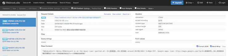

Solution #2: Set up a second Notehub route to Webhook.site
Webhook.site is a handy website where we can route our JSONata-transformed data to and see the output.
To use it:
- Navigate to https://webhook.site,
- Copy the session specific URL so you can route your events there,
- And add a new route URL in Notehub pointing to that unique Webhook.site URL.
This is messages routing through Notehub to the Webhook,site URL for decoding.
Hopefully these two debugging options will help you refine your JSONata expression enough that the message will get through to Twilio which will allow you to figure out the most useful info to send via SMS.
