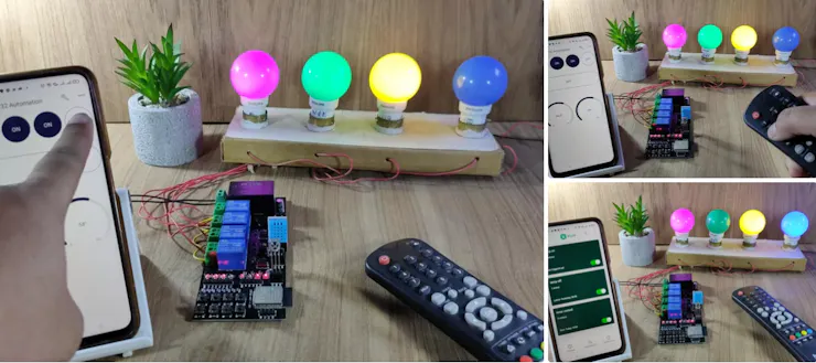

In this IoT project, I have shown how to make IoT-based Smart Home Automation using ESP32 Google Assistant Blynk with the timer, sensor, and IR remote control relay with real-time feedback.
So, you can easily make this home automation project at home just by using an ESP32 and relay module. Or you can also use a custom-designed PCB for this project.
Tutorial Video on IoT Project using ESP32 & Blynk
In the tutorial video, I have shown all the steps to make this Blynk home automation system.
This Blynk ESP32 control smart relay has the following features:
- Control home appliances with WiFi (Blynk IoT App).
- Control home appliances with Google Assistant.
- Control home appliances with DHT11 Sensor and Timer.
- Control home appliances with IR remote.
- Control home appliances with manual switches or push buttons.
- Monitor real-time room temperature in the Blynk IoT App
- Monitor real-time feedback in the Blynk IoT App.
- Control appliances without WiFi.

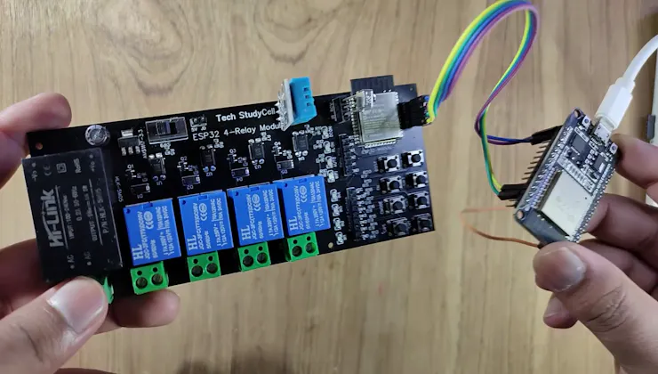

Circuit Diagram of the ESP32 IoT Project
The circuit is very simple, I have used the GPIO pins D23, D22, D21 & D19 to control the 4 relays.
And the GPIO pins D13, D12, D14 & D27 are connected with switches to control the 4 relays manually.
I used the INPUT_PULLUP function in Arduino IDE instead of the pull-up resistors.
IR remote receiver (TSOP1838) connected with D35. And the DHT11 sensor is connected with RX2.
I have used a 5V mobile charger to supply the smart relay module.

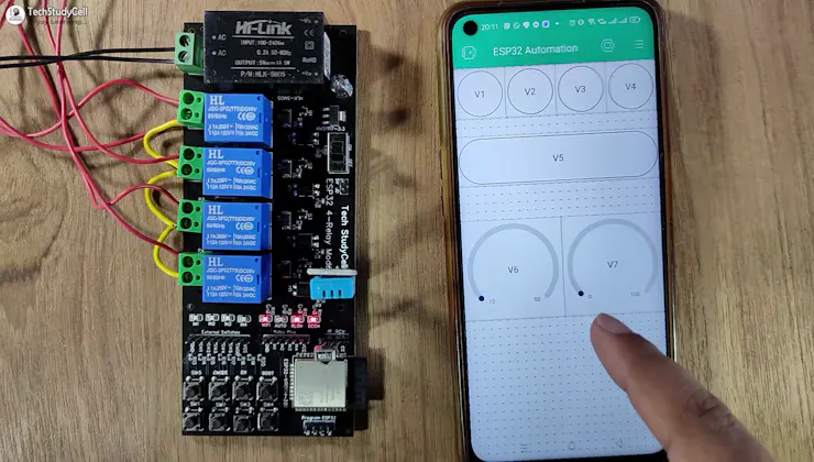

Blynk & Google Assistant Control Relay Using ESP32
In this IoT project, you can also control the relays with sensors and Timer using Blynk Automation.
Here, I have controlled the 3rd relay with temperature and the 4th relay with the predefined time schedule.
IR Remote & Manual Switch Control Relay Using ESP32
You can always control the relays from the IR remote or switches. For this project, you can use any IR remote.
You can monitor the real-time feedback in the Blynk IoT App.

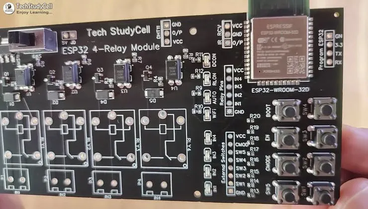

Design the PCB for This Smart Home System
To make the circuit compact and give a professional look, I designed the PCB after testing all the features of the smart relay module.
You can download the PCB Gerber, BOM, and "pick and place" files of this ESP32 control relay PCB from the following link:
GitHub link to Download PCB Gerber File

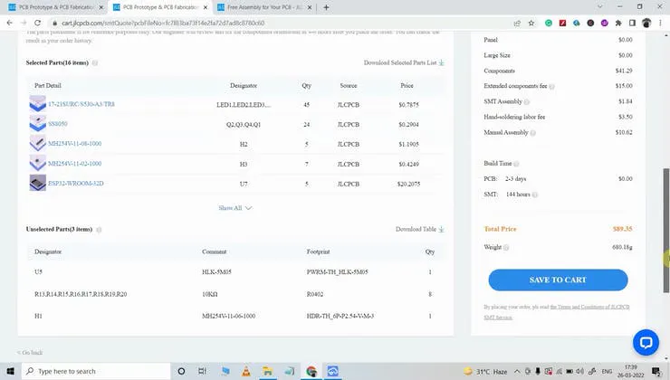

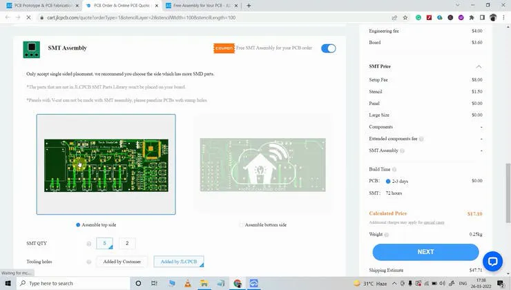

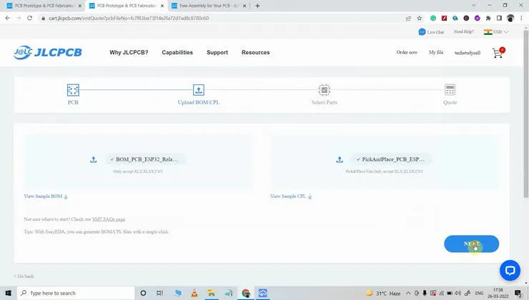

Steps to Order the PCB Assembly from JLCPCB
1. Visit https://jlcpcb.com and Sign in / Sign up.
2. Click on the QUOTE NOW button.
3. Click on the "Add your Gerber file" button. Then browse and select the Gerber file you have downloaded.
4. Set the required parameter like Quantity, PCB masking color, etc.
5. Select the Assemble side and SMT Quantity.
6. Now upload the BOM and PickAndPlace files.
7. Now confirm all the components which you want to be soldered by SMT services.
8. Click on SAVE TO CART button.

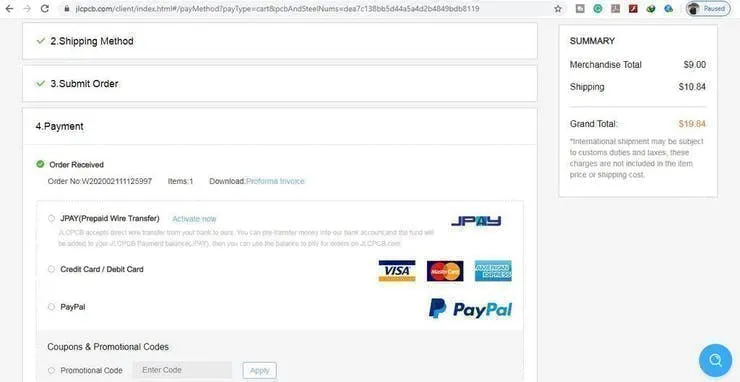

Select Shipping Address and Payment Mode
6. Type the Shipping Address.
7. Select the Shipping Method suitable for you.
8. Submit the order and proceed with the payment.

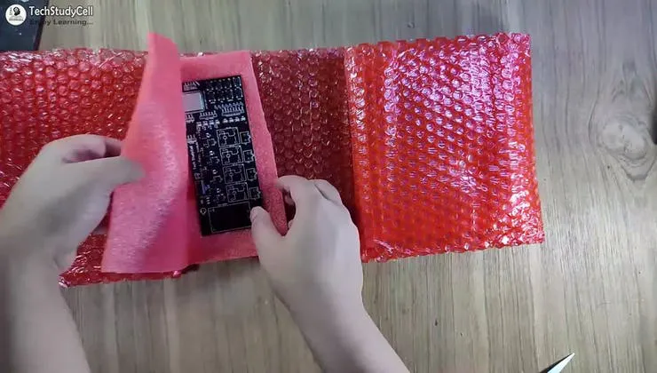

You can also track your order from the JLCPCB
My PCBs took 3 days to get manufactured and arrived within a week using the DHL delivery option.
PCBs were well packed and the quality was really good at this affordable price.

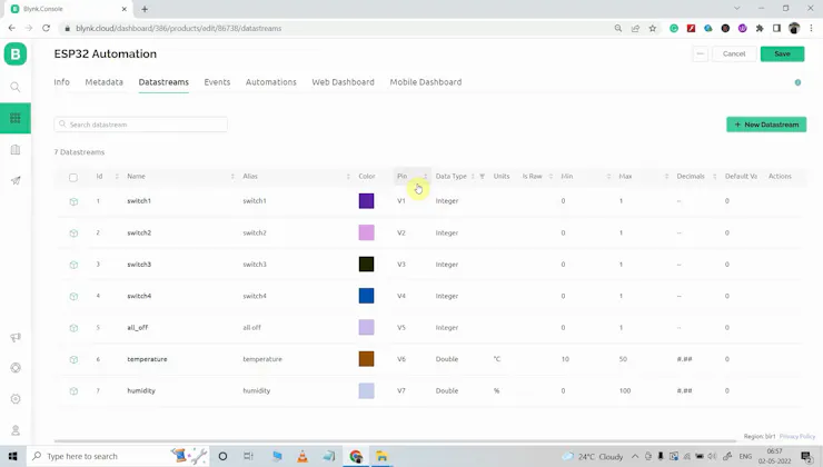

Create a Datastream in Blynk Cloud
After that, you have to create Datastreams. Here I will control 4 relays, so I have to create 4 Datastreams.
- Go to the Datastreams tab.
- Click on New Datastream and select Virtual Pin.
- Enter a name, select the virtual pin V1, and the datatype will be Integer.
- Then click on Create.
In a similar way, create 4 datastreams with virtual pin V1 to V4. And 1 datastream (V5) to turn off all the relays.
And for the Temperature and humidity, I have used V6, & V7 (Please refer to the picture or tutorial video).

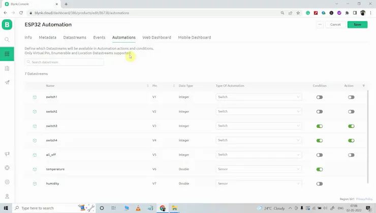

Define Automation in Blynk Cloud
After that go to the Automation tab and define which Datastreams will be available in Automation actions and conditions (Please refer to picture or tutorial video).
Only Virtual Pin, Enumerable, and Location Datastreams are supported.

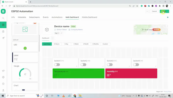

Set Up Blynk Cloud Web Dashboard
Now go to the Web Dashboard tab.
Drag and drop 4 Switch widgets and 2 Level widgets.
Go to the settings of each widget, and select a Datastream.
Please refer to the tutorial video for more details.
Then click on Save to save the template.

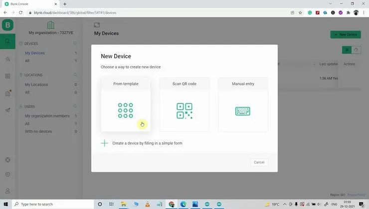

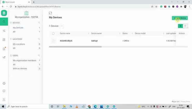

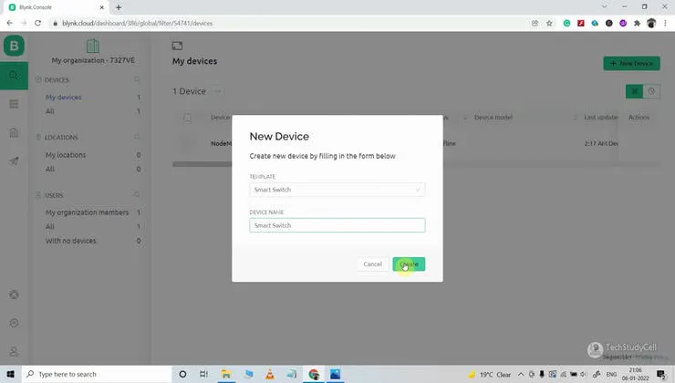

Add Device Using Template in Blynk IoT
Steps to add a device in the Blynk IoT cloud:
- First, go to Device, then click on "New Device".
- Click on "From template".
- Select the Template, and give the device name.
- Click on Create.
Then in the device info tab, you will get the Blynk Auth Token, Template ID, and Device Name. All these details will be required in the code.

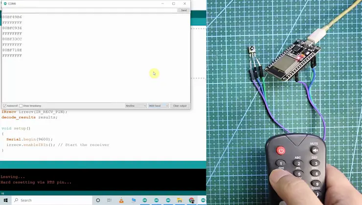

Get the IR Codes (HEX Code) From the Remote
Now, to get the HEX codes from the remote, first, we have to connect the IR receiver output pin with GPIO D35.
And give the 5V across the VCC and GND. The IR receiver must have a metallic casing, otherwise, you may face issues.
Then follow the following steps to get the HEX codes
- Install the IRremote library in Arduino IDE
- Download the attached code, and upload it to ESP32.
- Open Serial Monitor with Baud rate 9600.
- Now, press the IR remote button.
- The respective HEX code will populate in the serial monitor.
Save all the HEX codes in a text file.

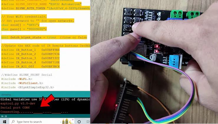

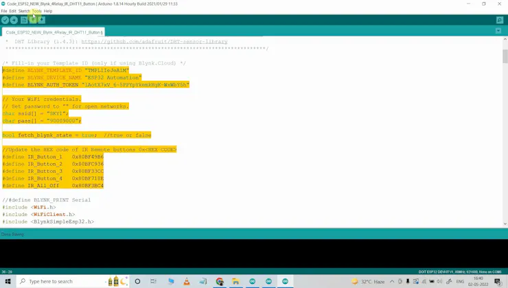

Program the ESP32 for This Blynk Project
For programming the ESP32 on PCB, I have used another ESP32 development board.
Download and install the following libraries in Arduino IDE
- Blynk Library (1.0.1): https://github.com/blynkkk/blynk-library
- AceButton Library (1.9.2): https://github.com/bxparks/AceButton
- IRremote Library (3.6.1): https://github.com/Arduino-IRremote/Arduino-IRremote
- DHT Library (1.4.3): https://github.com/adafruit/DHT-sensor-library
Now open the main sketch (code).
- In the code, you have to update the BLYNK_TEMPLATE_ID, BLYNK_DEVICE_NAME, Auth Token, WiFi Credentials.
- Then update the HEX codes of the IR remote as shown in the tutorial video.
- After that, select the DOIT ESP32 DEVKIT V1 board and proper PORT.
- Then upload the code to ESP32 Board.
While uploading the code to ESP32, if you use the PCB then you will see the "Connecting....___" text, then press and hold the BOOT button and then press the EN button, after that release both the buttons.
Install Blynk IoT App to Configure Mobile Dashboard
Install the Blynk IoT app from Google Play Store or App Store. Then log in.
- Go to Developer Mode.
- Tap on the template that you have already made.
- Now go to the Widget box (on the right) to add widgets.
- Add 5 Button widgets and 2 Gauge widgets from Widget Box.
- Go to Button widget settings.
- Enter the name, select Datastream, Mode will be Switch. Then exit.
- After setting all the Buttons tap on exit.

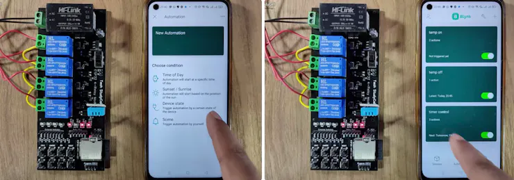

Add Automation for Sensors and Timer
Now, you can define the automation in the Blynk IoT app according to your requirements.
In this project, I have added to the total of 3 Automations to the 3rd and 4th relay with the DHT11 sensor and Timer.
In the tutorial video, I have shown all the steps to add automation to Blynk IoT App.
