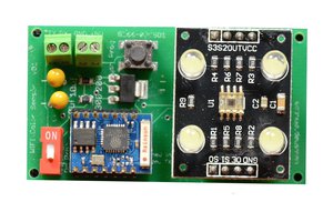

PCB
As previously stated, the hardware for this project is divided into two boards: an external sensor array and the board within the bulb. Due to the size constraint of fitting the board into the bulb housing, we decided to design and print a PCB for the bulb board. We did this using EAGLE, and our .sch and .brd files are included in the "files" section. Below is a picture of our assembled PCB.
When fully assembled within the bulb housing, our PCB is supplied power from the output of an AC to DC buck converter (5V, 1A output) to the power input on the left side of the board. We then have a linear regulator (5V to 3V3) that supplies the 3V3 components on the board. The main component of our PCB is the ESP-32. This chip allows for wireless communication to the sensor board through the ESP-NOW protocol, and drives the five neopixel LEDs by way of a logic translator IC. It also sets up our web server which is talked about in detail further below.
In order to upload software to our ESP-32 chip, we added the buttons RESET and IO0 as well as the connector at the top of the board. The connector allows us to attach a USB to UART converter to the board to upload code, and the buttons are required for the board to boot into download mode (this occurs when the user resets the chip while holding IO0 low).
