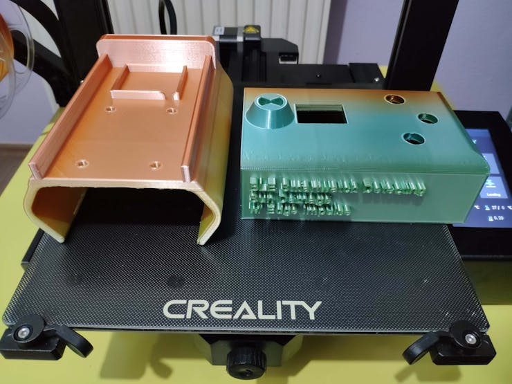

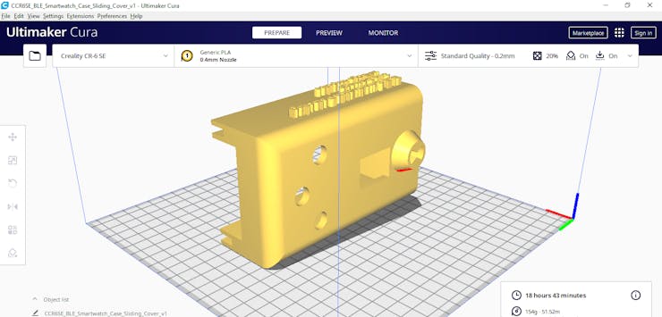

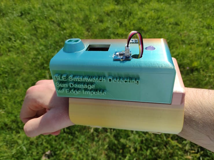

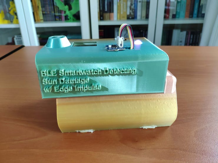

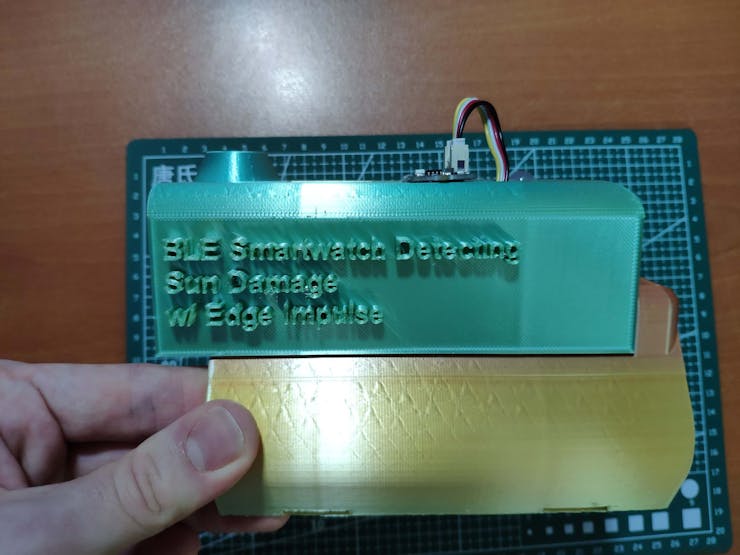

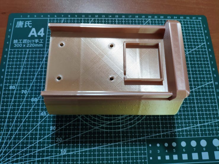

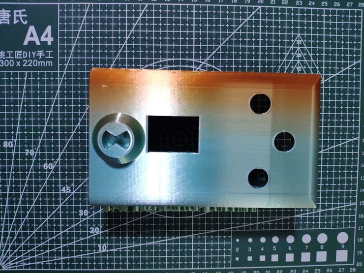

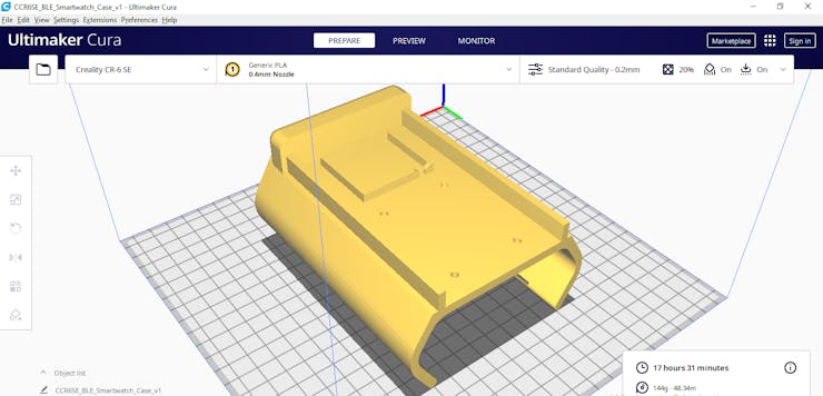

Step 1: Designing and printing an Ultimatrix-inspired smartwatch case

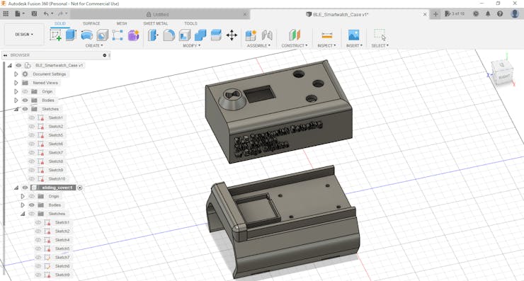

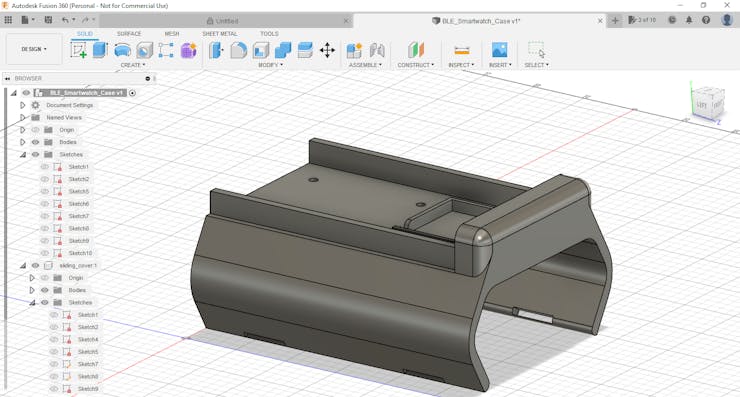

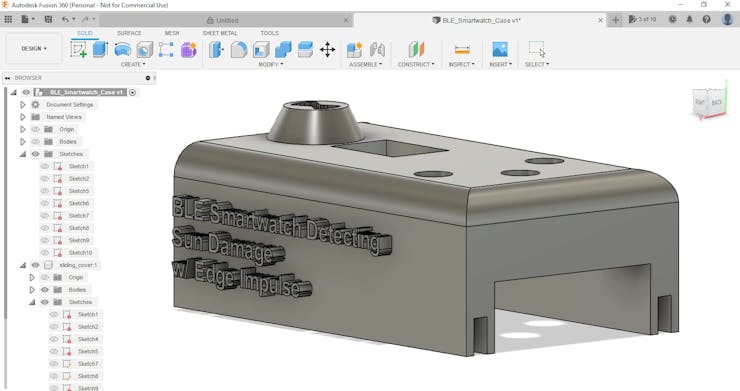

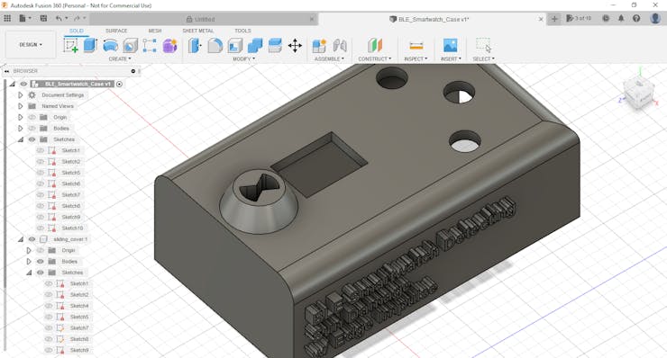

Since I am a huge Ben 10 fan, I got inspired by the Ultimatrix in Ben 10: Ultimate Alien animated series to design a smartwatch case so as to create a robust and sturdy device flawlessly operating while enduring harsh conditions outdoors. To make the XIAO expansion board accessible while logging the collected data on the SD card, I added a sliding (removable) top cover. Also, I inscribed the well-known Omnitrix symbol on the top cover to emphasize the Ben 10 theme gloriously :)

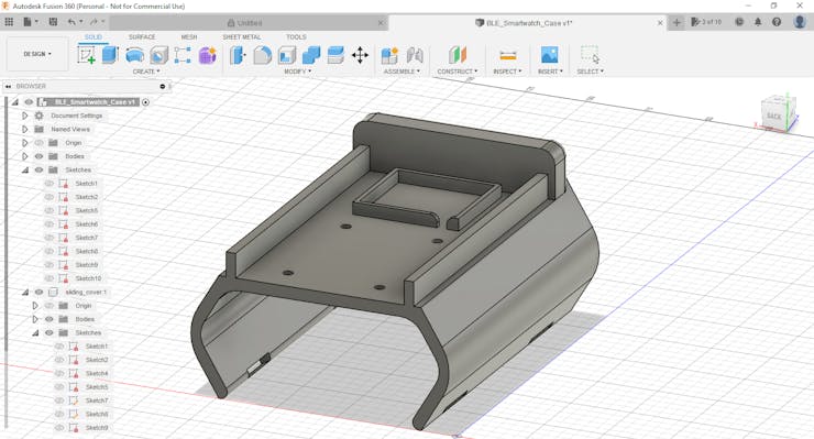

I designed the smartwatch case and its sliding (removable) top cover in Autodesk Fusion 360. You can download their STL files below.
Then, I sliced 3D models (STL files) in Ultimaker Cura.

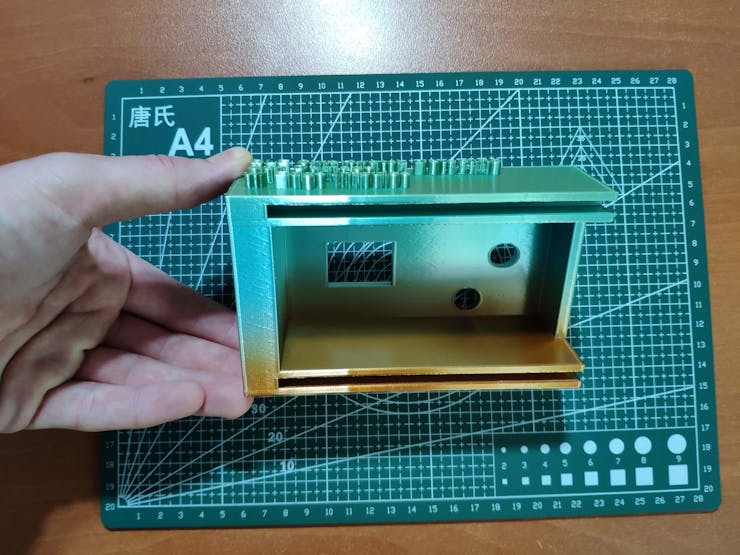

Since I wanted to create a solid structure for the smartwatch case with the sliding top cover and complement the Ben 10 theme with a unique Ultimatrix iteration, I utilized this PLA filament:
- eSilk Rainbow Multicolor
Finally, I printed all parts (models) with my Creality CR-6 SE 3D Printer. Although I am a novice in 3D printing, and it is my first FDM 3D printer, I got incredible results effortlessly with the CR-6 SE :)

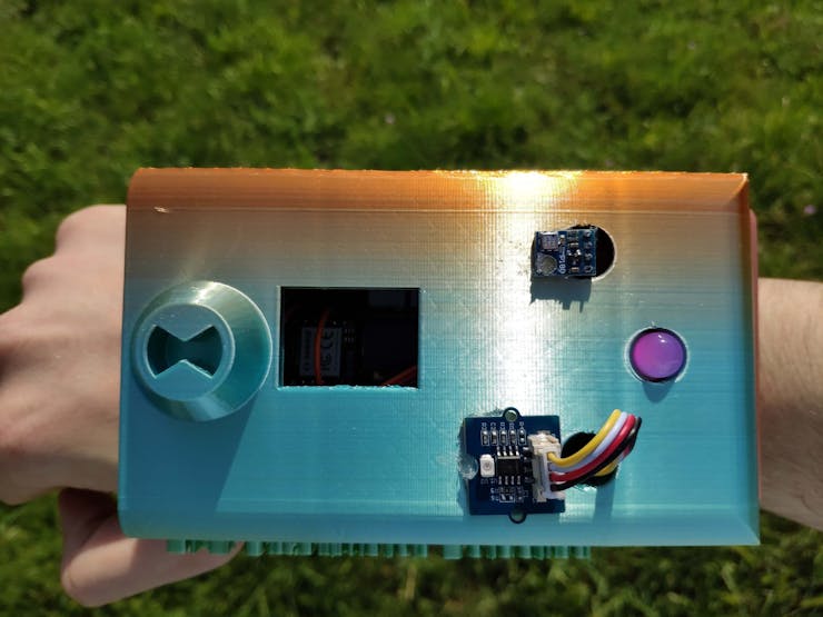

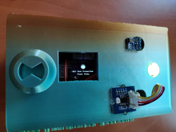

Step 1.1: Assembling the smartwatch and making connections & adjustments

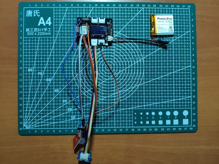

// Connections// XIAO BLE : // Grove - UV Sensor // A0 --------------------------- SIG // BMP180 Barometric Pressure/Temperature/Altitude Sensor // A4 --------------------------- SDA // A5 --------------------------- SCL // SSD1306 OLED Display (128x64) // A4 --------------------------- SDA // A5 --------------------------- SCL // MicroSD Card Module (Built-in on the XIAO Expansion board) // D10 --------------------------- MOSI // D9 --------------------------- MISO // D8 --------------------------- CLK (SCK) // D2 --------------------------- CS // Button (Built-in on the XIAO Expansion board) // D1 --------------------------- + // Keyes 10mm RGB LED Module (140C05) // D7 --------------------------- R // D3 --------------------------- G // D6 --------------------------- B

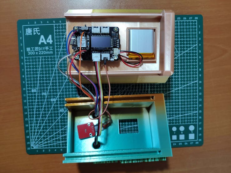

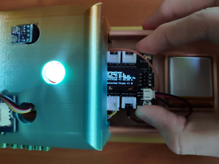

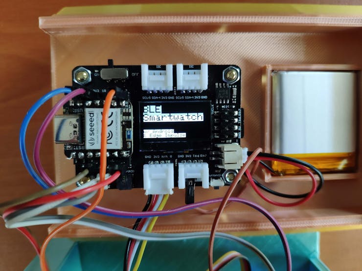

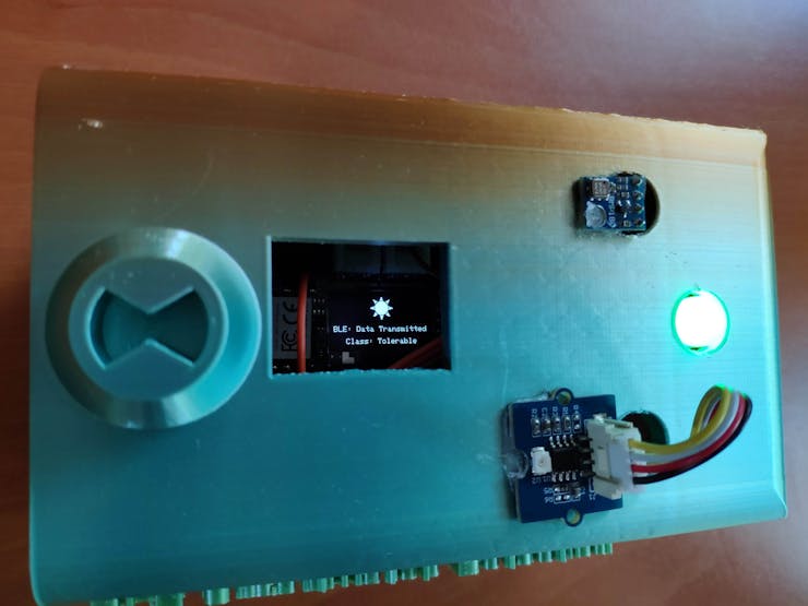

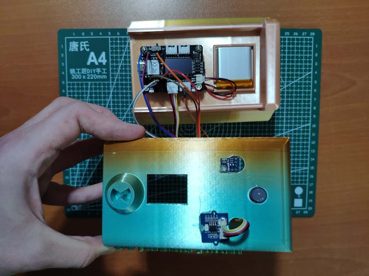

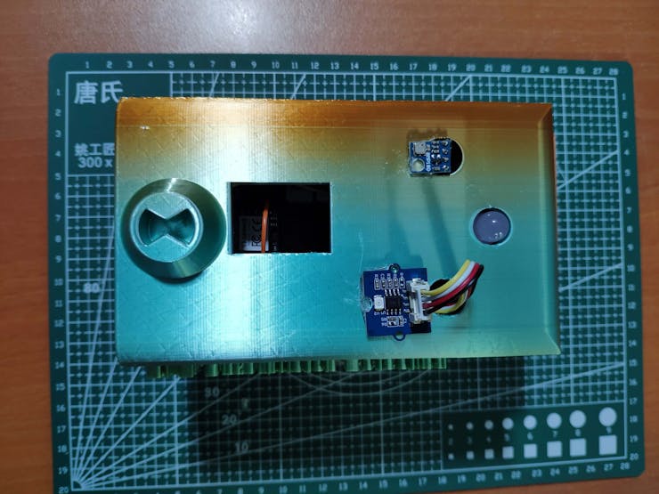

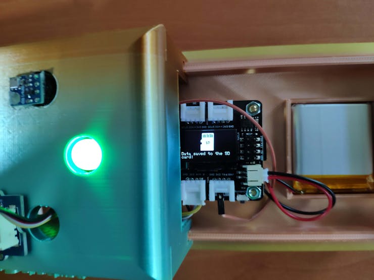

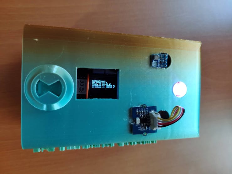

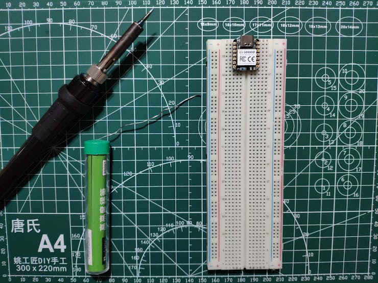

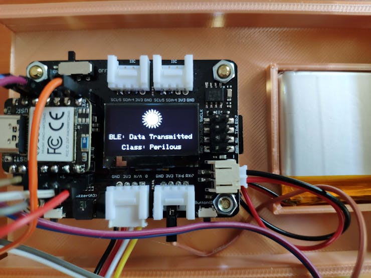

First of all, I soldered female pin headers to XIAO BLE in order to connect it to the XIAO expansion board. Also, I changed my 3.7V LiPo battery's pre-attached connector with a JST 2.0 standard connector so as to power the expansion board.

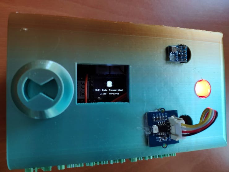

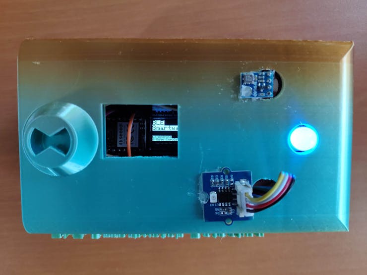

To collect the UV radiation and weather data, I connected the UV sensor (Grove) and the BMP180 precision sensor to XIAO BLE via the expansion board. Since the expansion board has a Grove port supporting analog sensors, I connected the UV sensor via a Grove cable.
To display and log the collected data, I utilized the built-in SSD1306 OLED screen, MicroSD card module, and button on the expansion board. Also, I added a 10mm common anode RGB LED module (Keyes) to indicate the outcomes of operating functions.

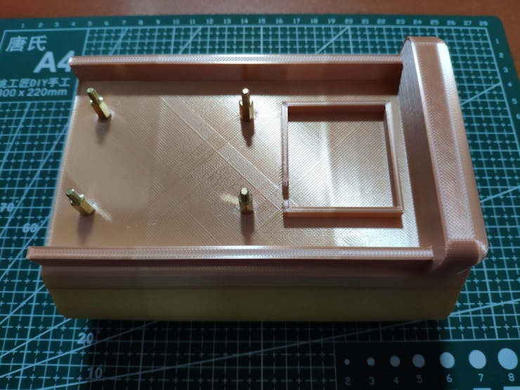

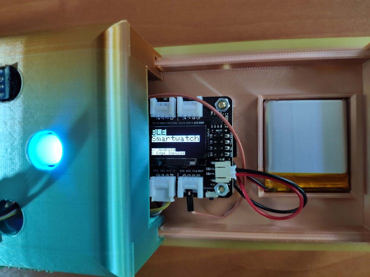

After printing all parts (models), I fastened all components except the expansion board to their corresponding slots on the smartwatch case and the sliding (removable) top cover via a hot glue gun.

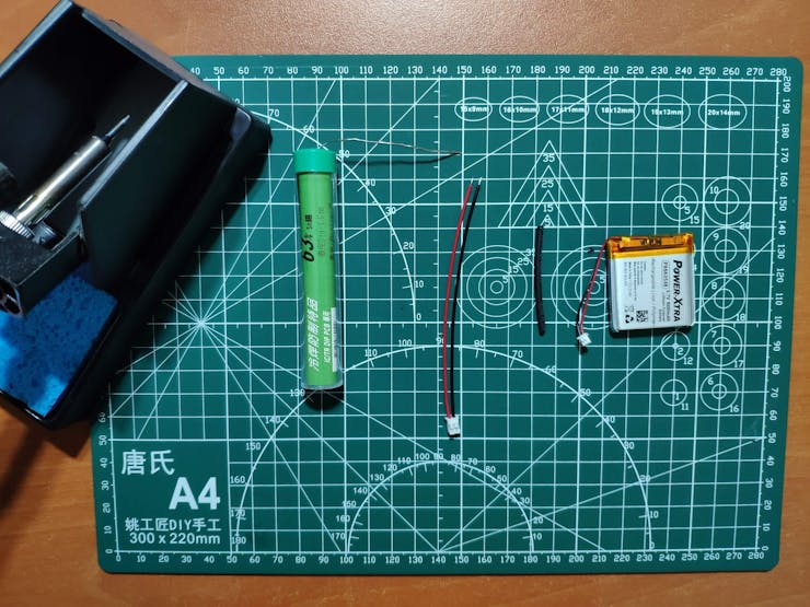

To attach the expansion board to the smartwatch case, I utilized 10mm M3 male-female brass hex spacers, M3 screws, and hex nuts.

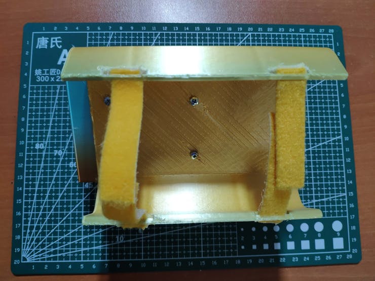

Finally, I affixed yellow rubber hook-and-loop fasteners (15mm wide Velcro) to the holes under the smartwatch case in order to wear the smartwatch effortlessly outdoors.

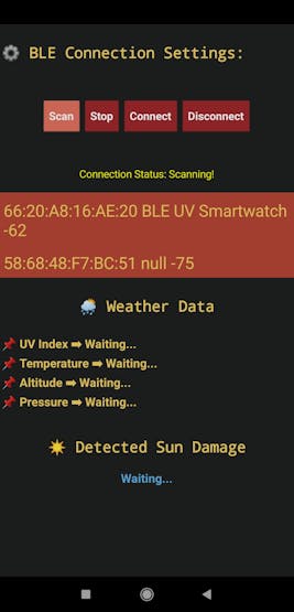

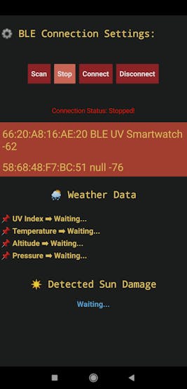

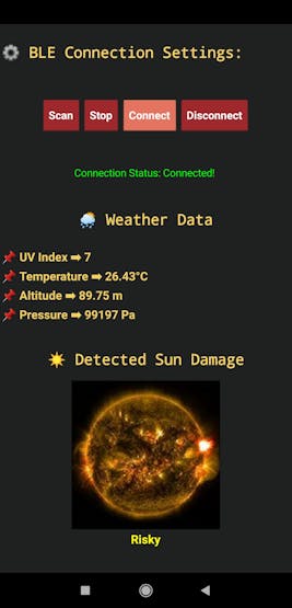

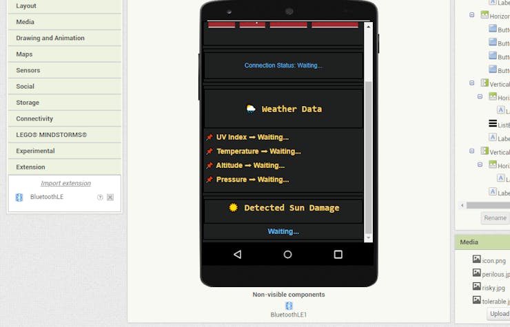

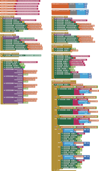

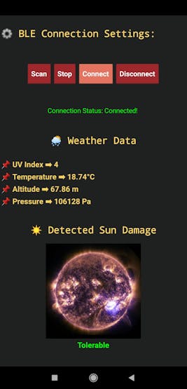

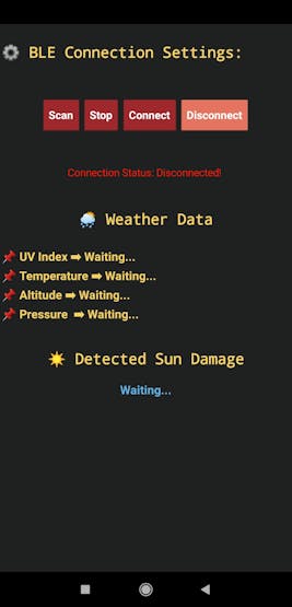

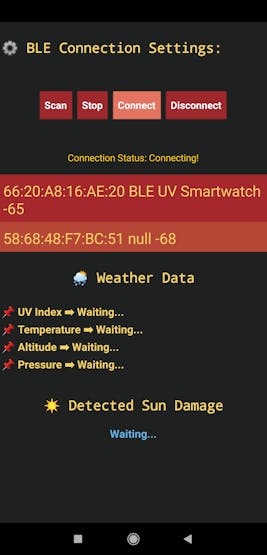

Step 2: Developing a BLE-enabled Android application w/ the MIT APP Inventor

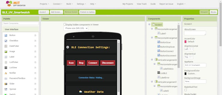

To be able to obtain the transmitted (advertised) information from the smartwatch over BLE, I decided to develop an Android application from scratch with the MIT APP Inventor.
MIT App Inventor is an intuitive, visual programming environment that allows developers to build fully functional Android applications. Its blocks-based tool (drag-and-drop) facilitates the creation of complex, high-impact apps in significantly less time than the traditional programming environments.

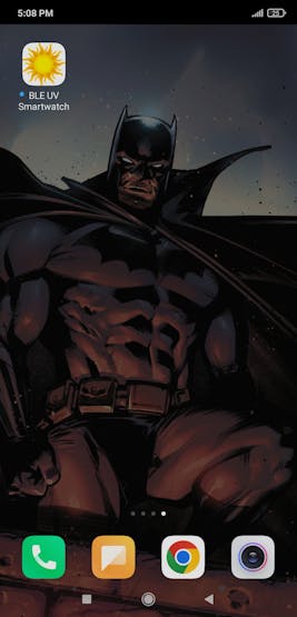

After developing my application, named BLE UV Smartwatch, I published it on Google Play. So, you can install the BLE UV Smartwatch app on any compatible Android device via Google Play.
📲 Install BLE UV Smartwatch on Google Play
Nevertheless, if you want to replicate the BLE UV Smartwatch app on the MIT App Inventor, follow the steps below.
#️⃣ First of all, create an account on the MIT App Inventor.
#️⃣ Download the BLE UV Smartwatch app's project file in the aia format (BLE_UV_Smartwatch.aia) and import the aia file into the MIT App Inventor.
#️⃣ Since the MIT App Inventor does not support BLE connectivity by default, download the latest version of the BluetoothLE extension and import the BluetoothLE extension into the BLE UV Smartwatch project.
In this tutorial, you can get more information regarding enabling BLE connectivity on the MIT App Inventor.
#️⃣ Inspect the BLE UV Smartwatch project functions and source code in the Blocks editor.

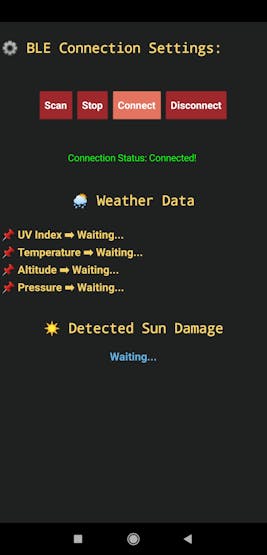

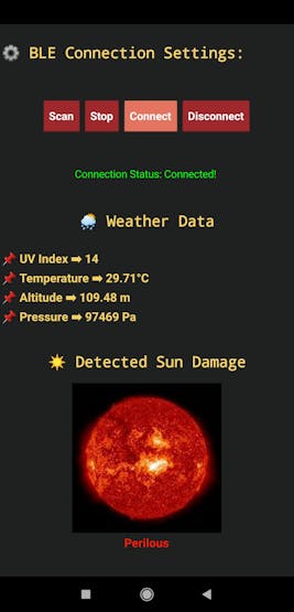

#️⃣ After installing the BLE UV Smartwatch app on a compatible Android device, the app starts displaying the transmitted (advertised) information from the smartwatch over BLE immediately to inform the user of potential sun damage risk.
You can get more information regarding the BLE UV Smartwatch app's features in Step 8.

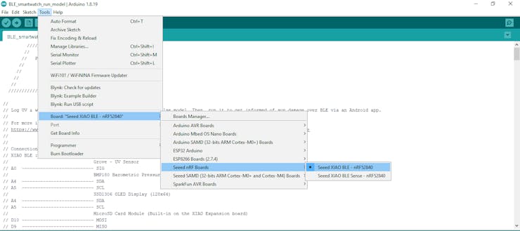

However, before proceeding with the following steps, I needed to set up XIAO BLE on the Arduino IDE and install the required libraries for this project.

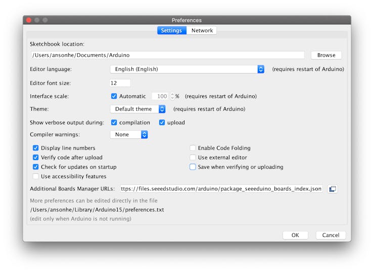

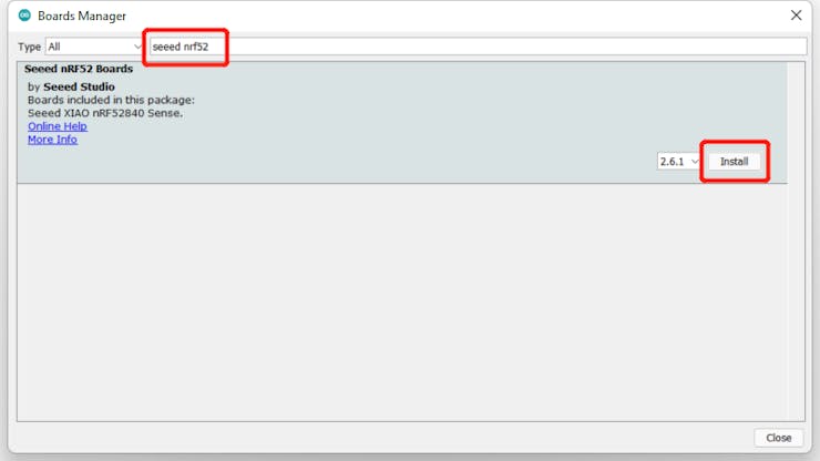

#️⃣ To add the XIAO BLE board package to the Arduino IDE, navigate to File ➡ Preferences and paste the URL below under Additional Boards Manager URLs.
https://files.seeedstudio.com/arduino/package_seeeduino_boards_index.json
#️⃣ Then, to install the required core, navigate to Tools ➡ Board ➡ Boards Manager and search for Seeed nRF52 Boards.
#️⃣ After installing the core, navigate to Tools > Board > Seeed nRF Boards and select Seeed XIAO BLE - nRF52840.

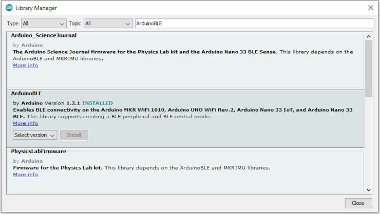

#️⃣ To transmit (advertise) data packets over BLE, download the ArduinoBLE library: Go to Sketch ➡ Include Library ➡ Manage Libraries… and search for ArduinoBLE.

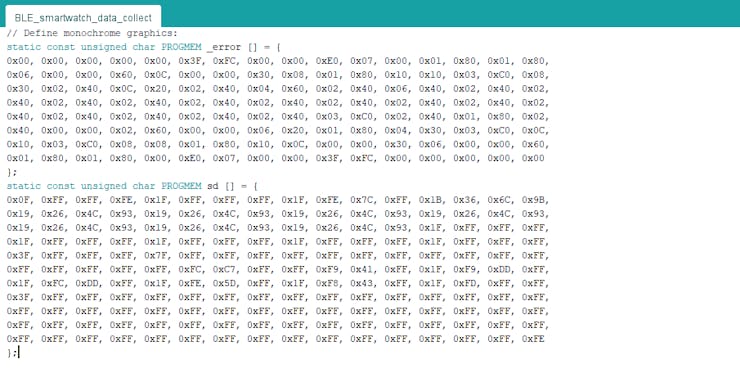

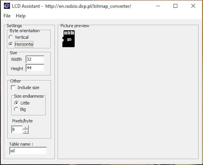

Step 3.1: Displaying images on the SSD1306 OLED screen
To display images (black and white) on the SSD1306 OLED screen successfully, I needed to create monochromatic bitmaps from PNG or JPG files and convert those bitmaps to data arrays.
#️⃣ First of all, download the LCD Assistant.
#️⃣ Then, upload a monochromatic bitmap and select Vertical or Horizontal depending on the screen type.
#️⃣ Convert the image (bitmap) and save the output (data array).
#️⃣ Finally, add the data array to the code and print it on the screen.
static const unsigned char PROGMEM sd [] = {0x0F, 0xFF, 0xFF, 0xFE, 0x1F, 0xFF, 0xFF, 0xFF, 0x1F, 0xFE, 0x7C, 0xFF, 0x1B, 0x36, 0x6C, 0x9B,0x19, 0x26, 0x4C, 0x93, 0x19, 0x26, 0x4C, 0x93, 0x19, 0x26, 0x4C, 0x93, 0x19, 0x26, 0x4C, 0x93,0x19, 0x26, 0x4C, 0x93, 0x19, 0x26, 0x4C, 0x93, 0x19, 0x26, 0x4C, 0x93, 0x1F, 0xFF, 0xFF, 0xFF,0x1F, 0xFF, 0xFF, 0xFF, 0x1F, 0xFF, 0xFF, 0xFF, 0x1F, 0xFF, 0xFF, 0xFF, 0x1F, 0xFF, 0xFF, 0xFF,0x3F, 0xFF, 0xFF, 0xFF, 0x7F, 0xFF, 0xFF, 0xFF, 0xFF, 0xFF, 0xFF, 0xFF, 0xFF, 0xFF, 0xFF, 0xFF,0xFF, 0xFF, 0xFF, 0xFF, 0xFF, 0xFC, 0xC7, 0xFF, 0xFF, 0xF9, 0x41, 0xFF, 0x1F, 0xF9, 0xDD, 0xFF,0x1F, 0xFC, 0xDD, 0xFF, 0x1F, 0xFE, 0x5D, 0xFF, 0x1F, 0xF8, 0x43, 0xFF, 0x1F, 0xFD, 0xFF, 0xFF,0x3F, 0xFF, 0xFF, 0xFF, 0xFF, 0xFF, 0xFF, 0xFF, 0xFF, 0xFF, 0xFF, 0xFF, 0xFF, 0xFF, 0xFF, 0xFF,0xFF, 0xFF, 0xFF, 0xFF, 0xFF, 0xFF, 0xFF, 0xFF, 0xFF, 0xFF, 0xFF, 0xFF, 0xFF, 0xFF, 0xFF, 0xFF,0xFF, 0xFF, 0xFF, 0xFF, 0xFF, 0xFF, 0xFF, 0xFF, 0xFF, 0xFF, 0xFF, 0xFF, 0xFF, 0xFF, 0xFF, 0xFF,0xFF, 0xFF, 0xFF, 0xFF, 0xFF, 0xFF, 0xFF, 0xFF, 0xFF, 0xFF, 0xFF, 0xFF, 0xFF, 0xFF, 0xFF, 0xFE};...display.clearDisplay(); display.drawBitmap(48, 0, sd, 32, 44, SSD1306_WHITE);display.display();

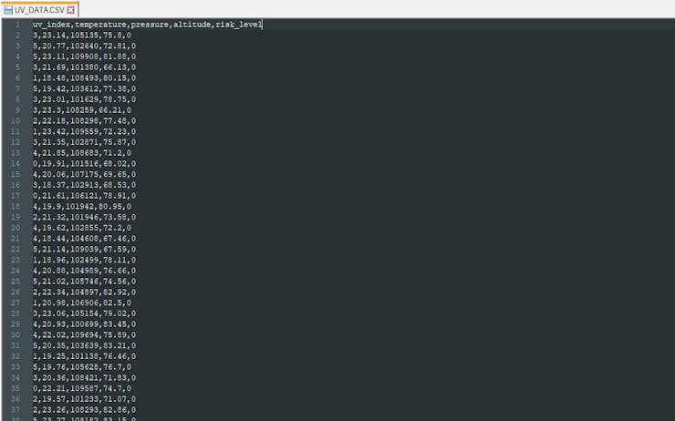

Step 4: Collecting and storing UV radiation and weather data w/ XIAO BLE
Step 4.1: Logging the collected data in a CSV file on the SD card

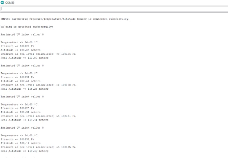

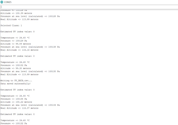

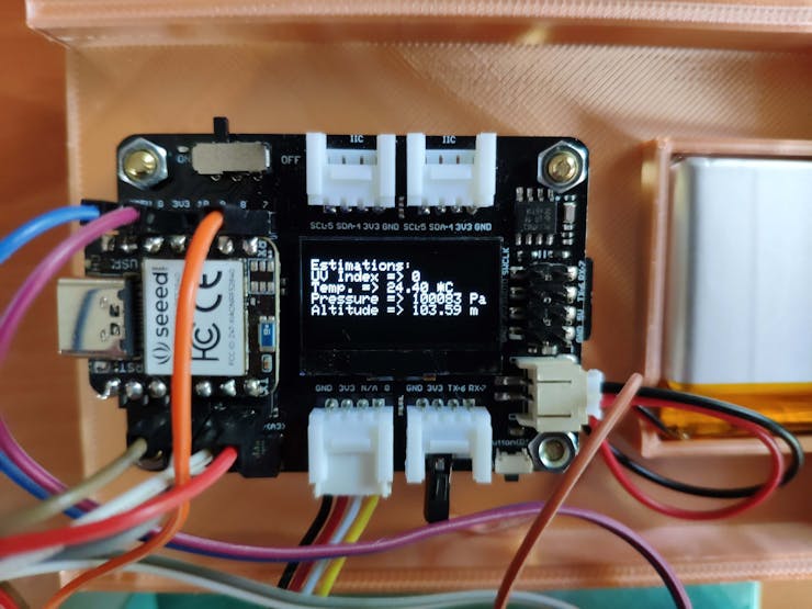

After uploading and running the code for collecting UV radiation and weather data and for saving information to the given CSV file on the SD card on XIAO BLE:

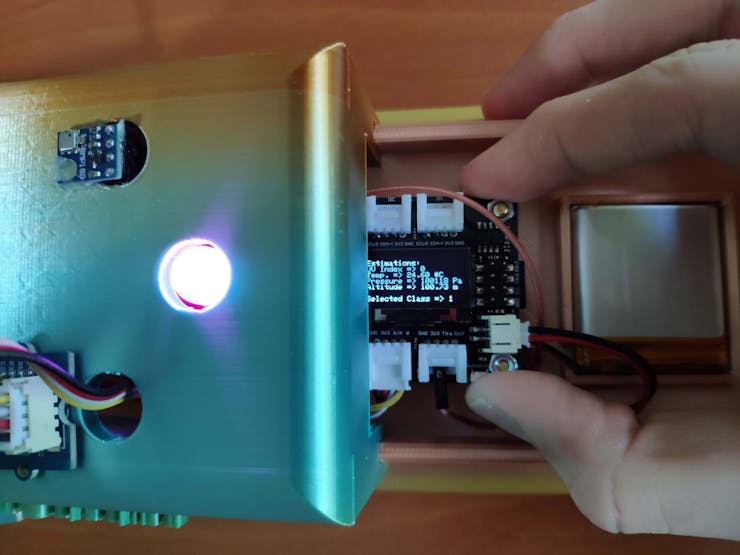

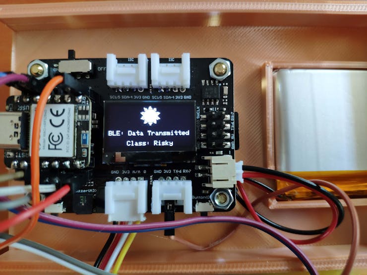

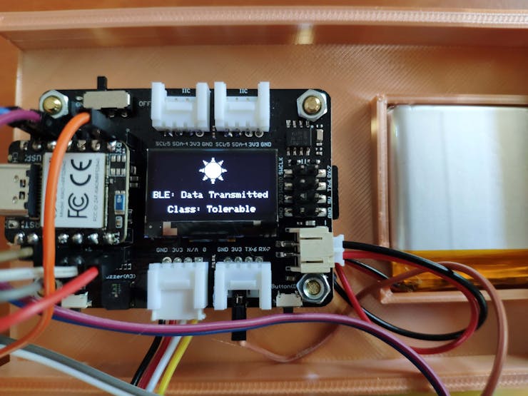

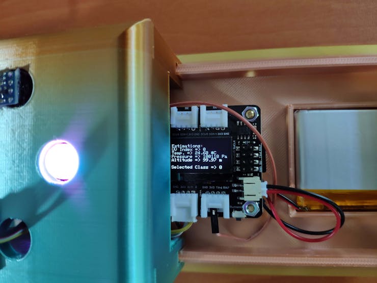

☀️⌚ The smartwatch turns the RGB LED to blue if the sensors and the MicroSD card module connections with XIAO BLE are successful.

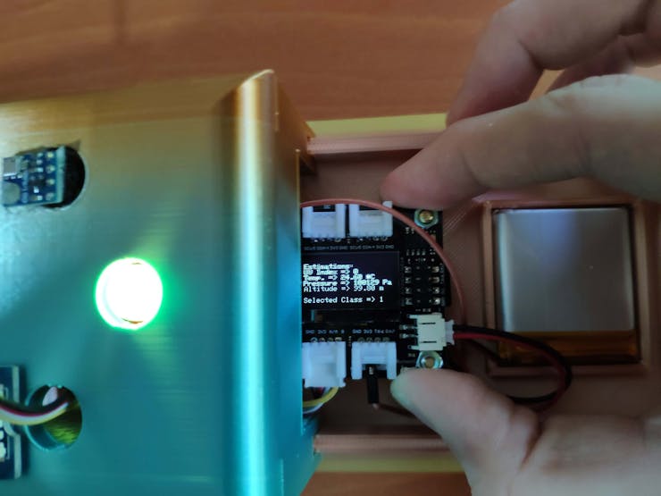

☀️⌚ Then, the smartwatch turns the RGB LED to magenta as the default color and displays the collected data and the selected class on the SSD1306 OLED screen:
- UV Index
- Temperature (°C)
- Pressure (Pa)
- Altitude (m)
- Selected Class
☀️⌚ If the button (built-in) is short-pressed, the smartwatch blinks the RGB LED as white and increases the class number in the range of 0-2:
- Tolerable [0]
- Risky [1]
- Perilous [2]
☀️⌚ If the button (built-in) is long-pressed, the smartwatch blinks the RGB LED as yellow and appends the recently created data record to the UV_DATA.CSV file on the SD card, including the selected sun damage risk level (class) under the risk_level data field.
☀️⌚ If the smartwatch saves the data record successfully to the given CSV file on the SD card, it blinks the RGB LED as green and displays this message on the SSD1306 OLED screen: Data saved to the SD card!

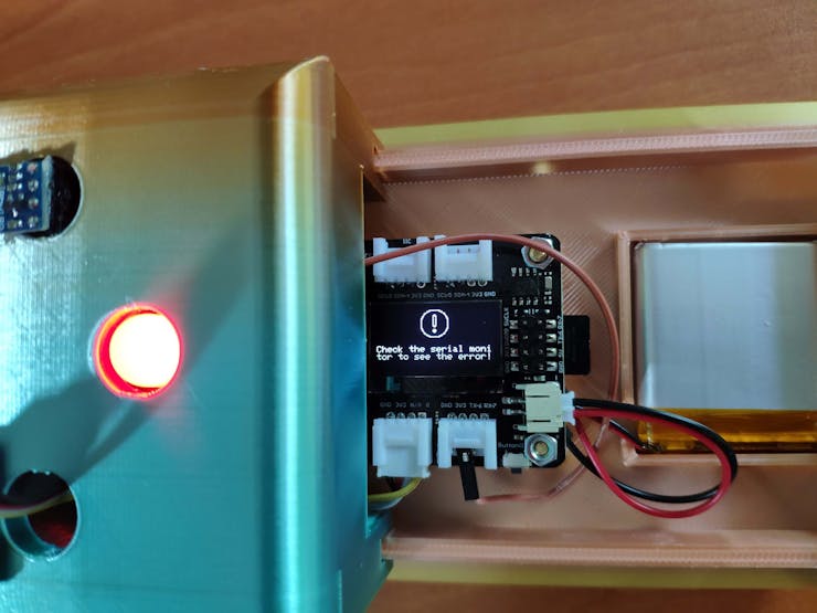

☀️⌚ If XIAO BLE throws an error while operating, the smartwatch shows the error message on the SSD1306 OLED screen, turns the RGB LED to red, and prints the error details on the serial monitor.

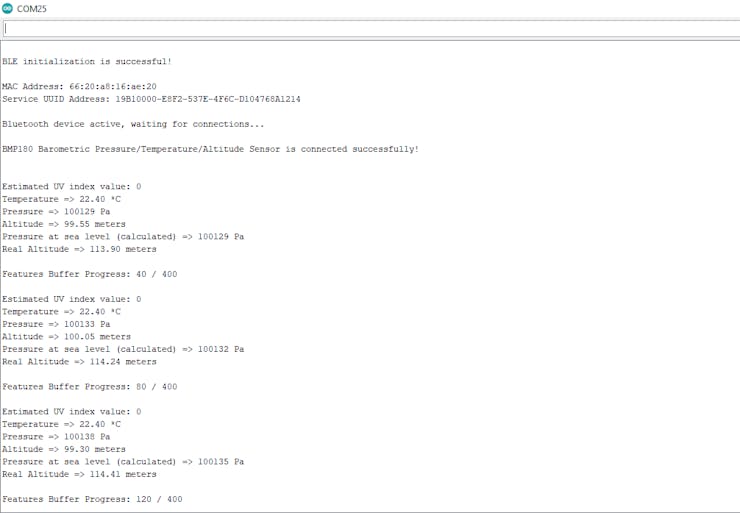

☀️⌚ Also, the smartwatch prints notifications and sensor measurements on the serial monitor for debugging.

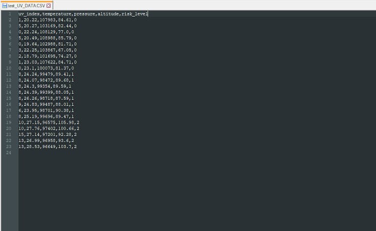

After logging the collected UV radiation and weather data in the given CSV file on the SD card for 20 days outdoors in different parts of the day (early morning, late afternoon, night, etc.), I elicited my data set with eminent validity:
![](https://hackster.imgix.net/uploads/attachments/1450464/image_Mq9POjHIWY.png?auto=compress%2Cformat&w=740&h=555&fit=max)
Since I also needed a testing data set to evaluate the accuracy of my model, I collected additional data to create a modest data set in volume under the test_UV_DATA.CSV file.

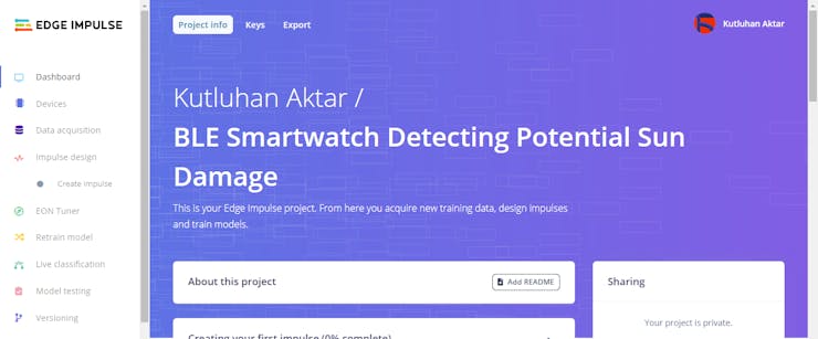

Since I published my Edge Impulse project, you can inspect my neural network model on Edge Impulse.

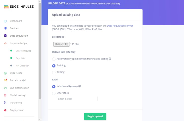

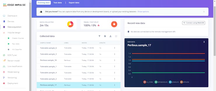

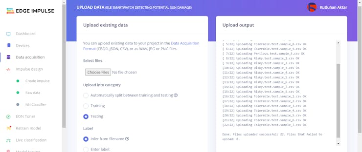

Step 5.2: Uploading samples to Edge Impulse

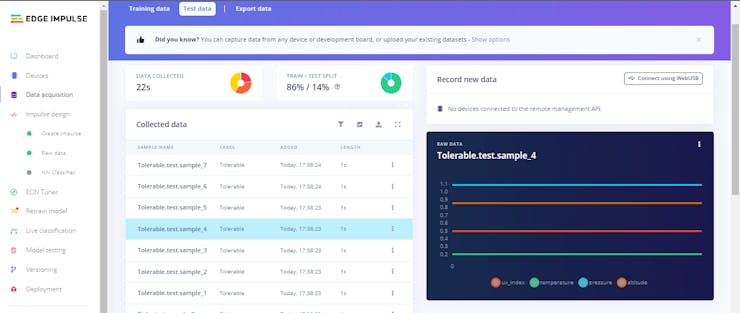

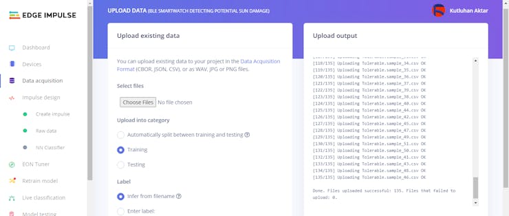

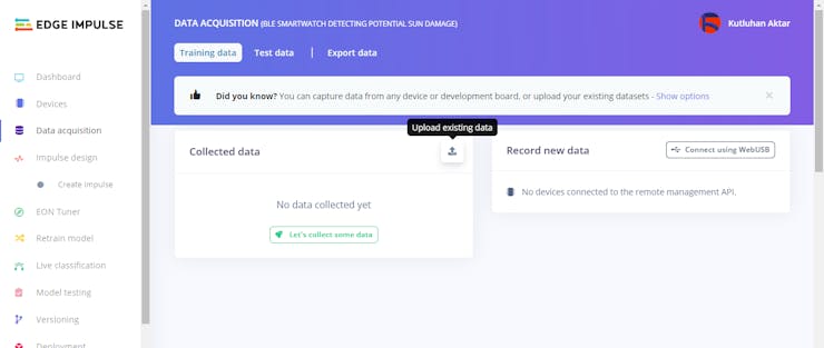

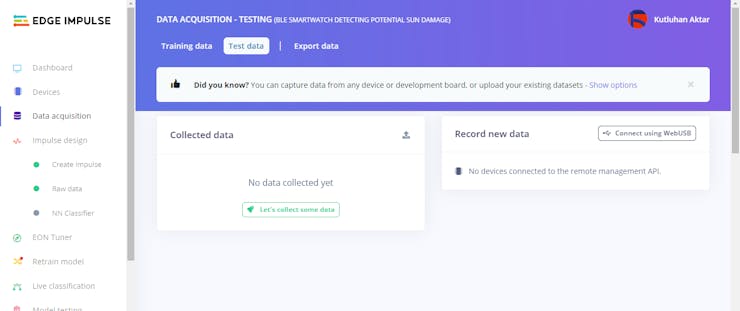

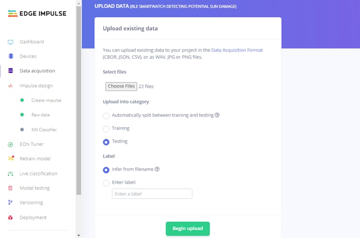

After generating training and testing samples successfully, I uploaded them to my project on Edge Impulse.
#️⃣ First of all, sign up for Edge Impulse and create a new project.
#️⃣ Navigate to the Data acquisition page and click the Upload existing data button.
#️⃣ Then, choose the data category (training or testing) and select Infer from filename under Label to deduce labels from file names automatically.
#️⃣ Finally, select files and click the Begin upload button.

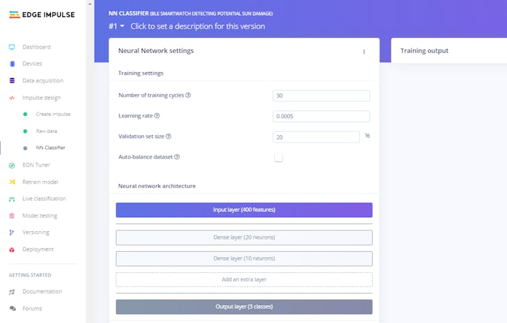

Step 5.3: Training the model on sun damage risk levels

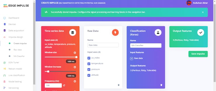

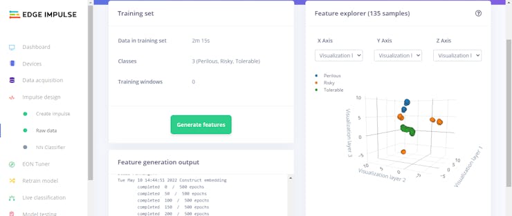

After uploading my training and testing samples successfully, I designed an impulse and trained it on sun damage risk levels (classes).

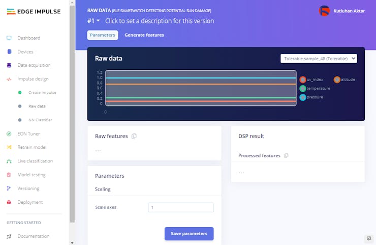

An impulse is a custom neural network model in Edge Impulse. I created my impulse by employing the Raw Data block and the Classification learning block.
The Raw Data block generates windows from data samples without any specific signal processing.
The Classification learning block represents a Keras neural network model. Also, it lets the user change the model settings, architecture, and layers.
#️⃣ Go to the Create impulse page. Then, select the Raw Data block and the Classification learning block. Finally, click Save Impulse.

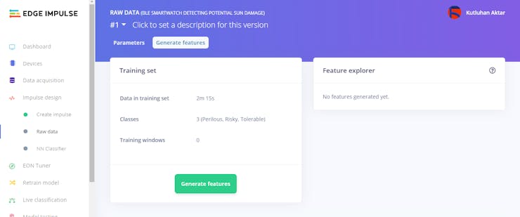

#️⃣ Before generating features for the model, go to the Raw data page and click Save parameters.
#️⃣ After saving parameters, click Generate features to apply the Raw Data block to training samples.

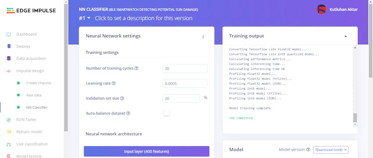

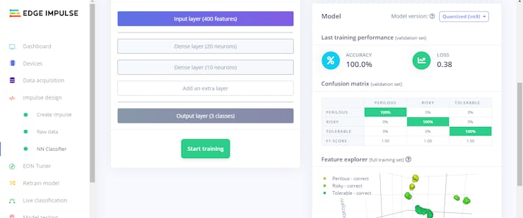

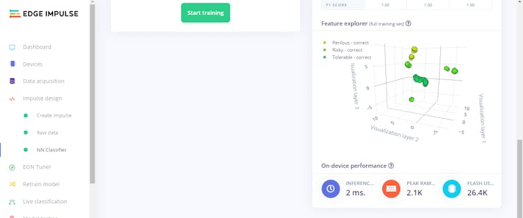

#️⃣ Finally, navigate to the NN Classifier page and click Start training.
I utilized the default classification model settings, architecture, and layers to build my neural network model.
After generating features and training my model with training samples, Edge Impulse evaluated the precision score (accuracy) as 100%.
The precision score is approximately 100% due to the volume and variety of training samples. In technical terms, the model overfits the training data set. Therefore, I am still collecting data to improve my training data set.

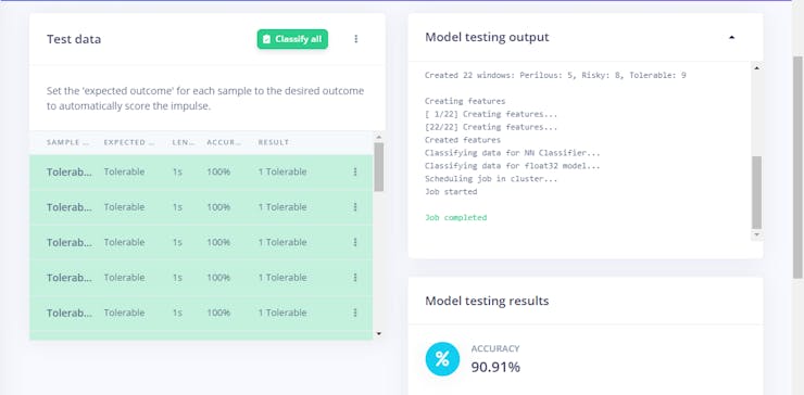

Step 5.4: Evaluating the model accuracy and deploying the model

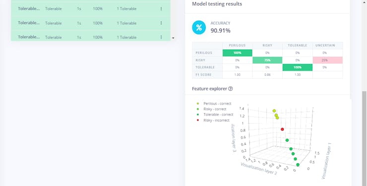

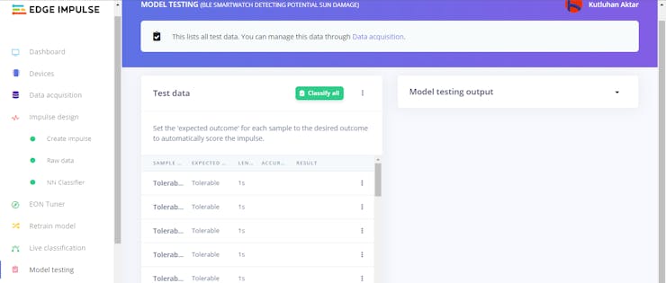

After building and training my neural network model, I tested its accuracy and validity by utilizing testing samples.
The evaluated accuracy of the model is 90.91%.
#️⃣ To validate the trained model, go to the Model testing page and click Classify all.

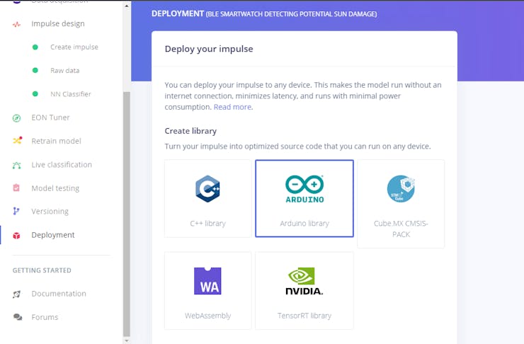

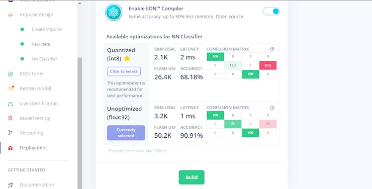

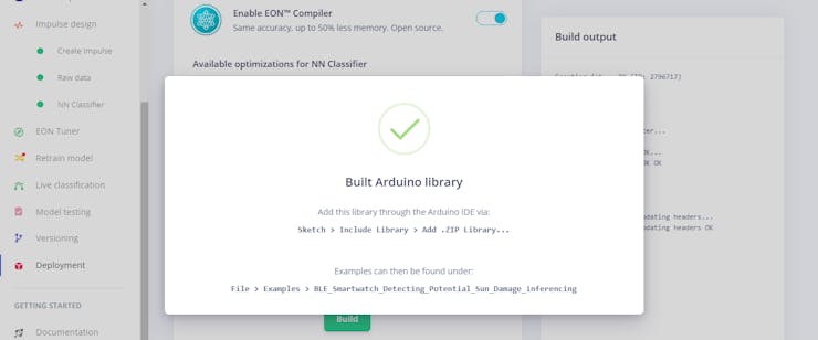

After validating my neural network model, I deployed it as a fully optimized and customizable Arduino library.
#️⃣ To deploy the validated model as an Arduino library, navigate to the Deployment page and select Arduino library.
#️⃣ Then, choose the Unoptimized (float32) option to deploy the model without downsizing the accuracy.
#️⃣ Finally, click Build to download the model as an Arduino library.

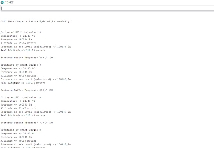

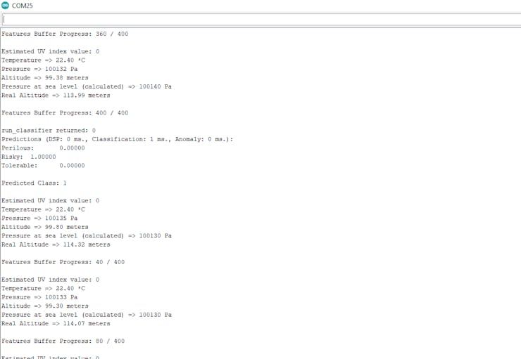

Step 7: Running the model on XIAO BLE to make predictions on sun damage risk levels
When the features array (buffer) is full with data items, my Edge Impulse neural network model predicts possibilities of labels (sun damage risk classes) for the given features buffer as an array of 3 numbers. They represent the model's "confidence" that the given features array (buffer) corresponds to each of the three different sun damage risk levels (classes) based on UV index, temperature, pressure, and altitude measurements [0 - 2], as shown in Step 5:
- 0 — Tolerable

As discussed in the previous steps, I also employed XIAO BLE to transmit (advertise) the prediction (detection) result and the recently collected data over BLE.
After executing the BLE_smartwatch_run_model.ino file on XIAO BLE:
☀️⌚ The smartwatch turns the RGB LED to blue if the BLE initialization status is successful.
☀️⌚ Then, the smartwatch turns the RGB LED to magenta as the default color and displays the collected data on the SSD1306 OLED screen:
- UV Index
- Temperature (°C)
- Pressure (Pa)
- Altitude (m)
☀️⌚ The smartwatch runs inferences with the Edge Impulse model at regular intervals by filling the features buffer with the recently collected UV index, temperature, pressure, and altitude measurements.
☀️⌚ Then, the smartwatch displays the detection result, which represents the most accurate label (sun damage risk class) predicted by the model.
☀️⌚ Each sun damage risk level (class) has a unique monochrome icon to be shown on the SSD1306 OLED screen and a color code for adjusting the RGB LED when being predicted (detected) by the model:
- Tolerable ➡ Green
- Risky ➡ Yellow
- Perilous ➡ Red
☀️⌚ After running inference successfully, the smartwatch also transmits (advertises) the prediction result (class) and the recently collected data over BLE.
☀️⌚ If XIAO BLE transmits the given information over BLE successfully, the smartwatch prints this message on the screen:
BLE: Data Transmitted
![](https://hackster.imgix.net/uploads/attachments/1450520/image_pexP4YoF0H.png?auto=compress%2Cformat&w=740&h=555&fit=max)
![](https://hackster.imgix.net/uploads/attachments/1450521/image_wvAbrQQJAs.png?auto=compress%2Cformat&w=740&h=555&fit=max)
![](https://hackster.imgix.net/uploads/attachments/1450522/image_O8QA3Ehuep.png?auto=compress%2Cformat&w=740&h=555&fit=max)
As far as my experiments go, the smartwatch operates impeccably while forecasting sun damage risk levels (classes) and transmitting (advertising) the prediction result over BLE outdoors :)
Step 8: Monitoring the model prediction result over BLE via the BLE UV Smartwatch app
As discussed in Step 2, I developed an Android application (BLE UV Smartwatch) from scratch with the MIT APP Inventor so as to obtain and display the transmitted (advertised) information from the smartwatch over BLE.
☀️⌚ If the Scan button is pressed, the application scans for compatible BLE devices and shows them as a list.
☀️⌚ If the Stop button is pressed, the application desists from scanning devices.
☀️⌚ If the Connect button is pressed, the application attempts to connect to the selected BLE device (smartwatch) over BLE.
☀️⌚ If the application connects to the smartwatch (peripheral device) as the central device successfully, the application waits for the advertised (transmitted) data packets from the smartwatch.
☀️⌚ When the application receives the advertised data packets, it shows the recently collected data by the smartwatch and the sun damage risk level (class) predicted by the Edge Impulse model.
☀️⌚ Each sun damage risk level (class) has a unique fusion state image and color code to be displayed on the screen when being received:
- Tolerable ➡ Green
- Risky ➡ Yellow
- Perilous ➡ Red
☀️⌚ If the Disconnect button is pressed, the application disconnects from the smartwatch and clears all received information.
