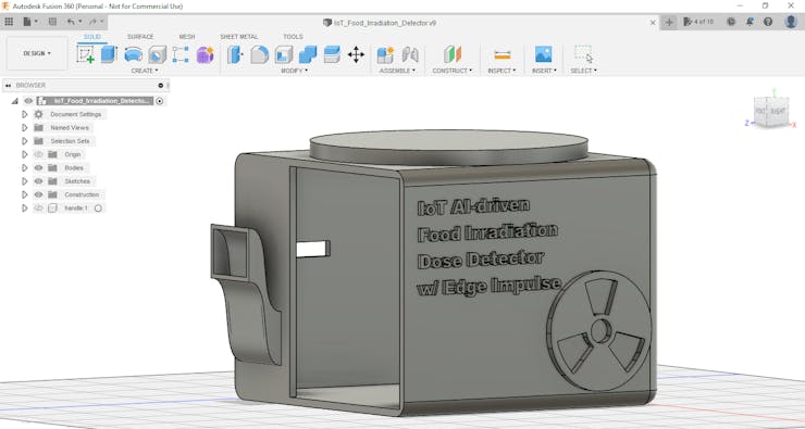

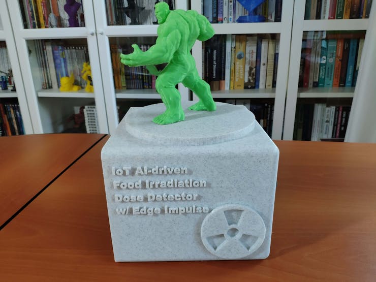

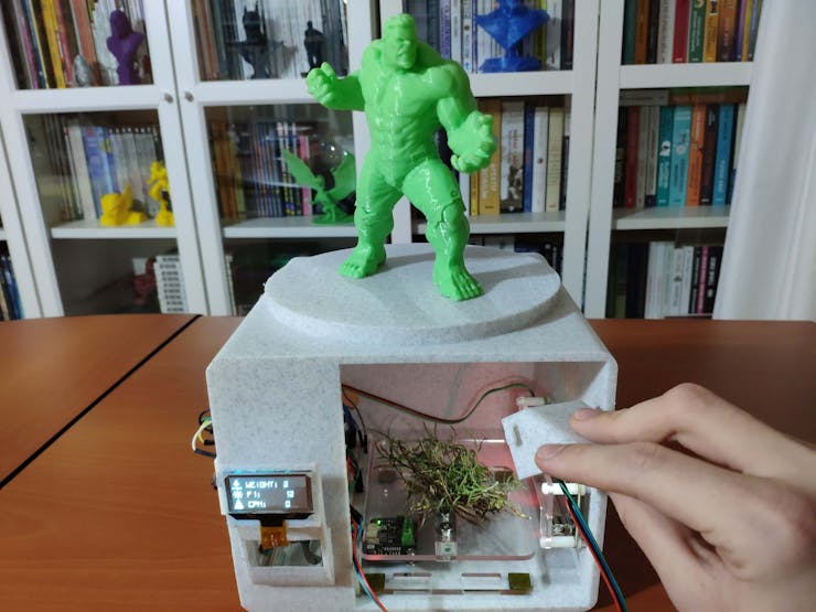

Step 1: Designing and printing a Hulk-inspired structure

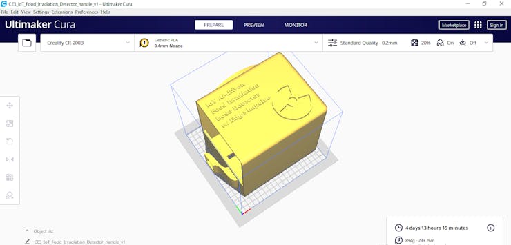

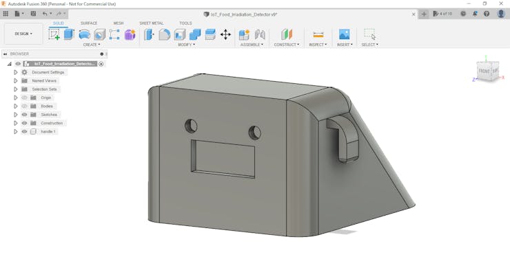

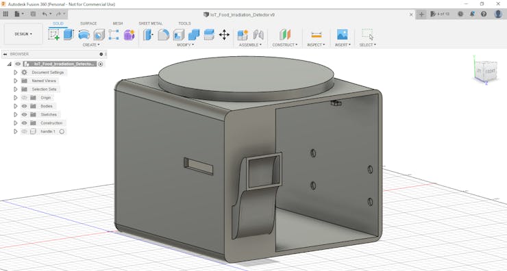

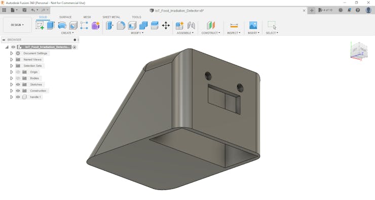

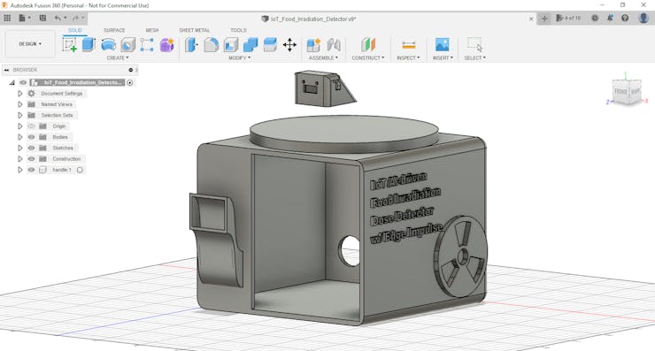

Since this project is for detecting irradiation doses of foods treated with ionizing radiation, I got inspired by the most prominent fictional Gamma radiation expert, Bruce Banner (aka, The Incredible Hulk), to design a unique structure so as to create a robust and compact device flawlessly operating while collecting data from foods. To collect data with the visible light sensor at different angles, I added a moveable handle to the structure, including a slot and a hook for hanging the sensor.
I designed the structure and its moveable handle in Autodesk Fusion 360. You can download their STL files below.

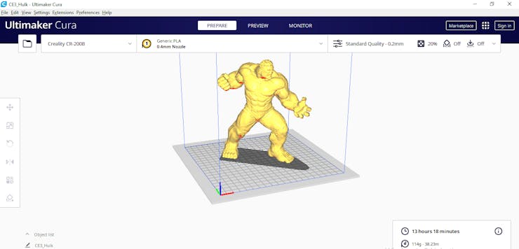

For the Hulk replica affixed to the top of the structure, I utilized this model from Thingiverse:

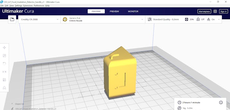

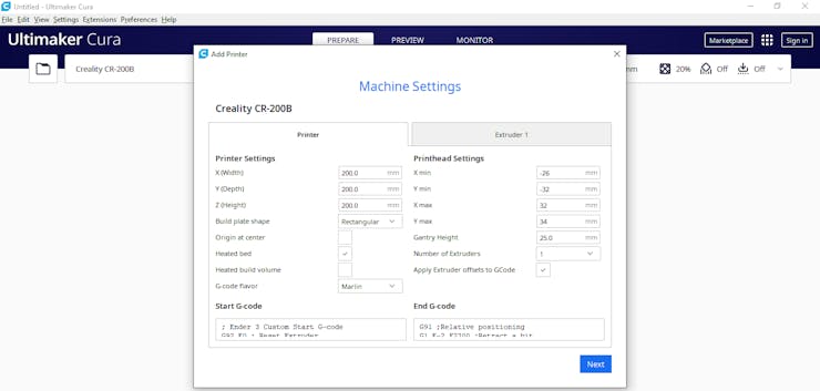

Then, I sliced all 3D models (STL files) in Ultimaker Cura.

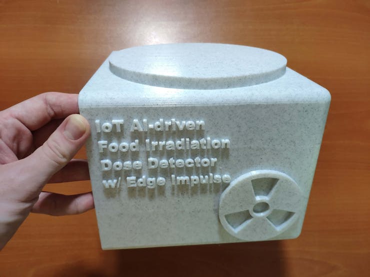

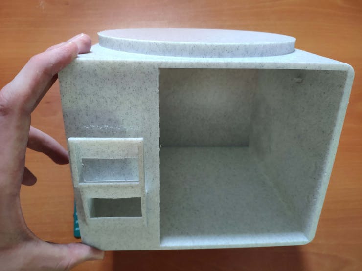

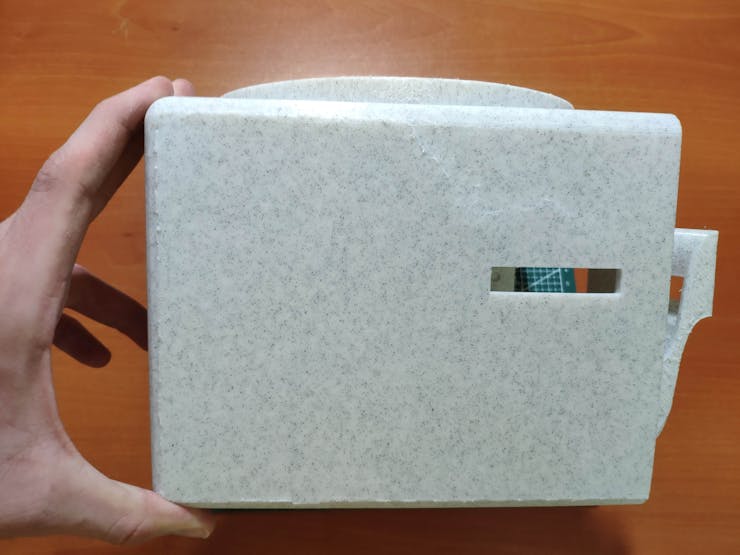

Since I wanted to create a solid structure for this device with a moveable handle and complement the Hulk theme gloriously, I utilized these PLA filaments:
- eMarble Natural
- Peak Green

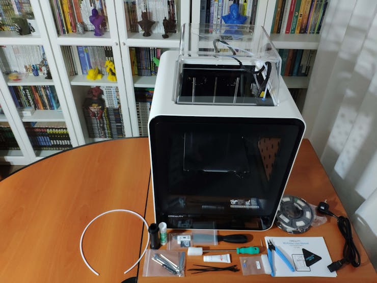

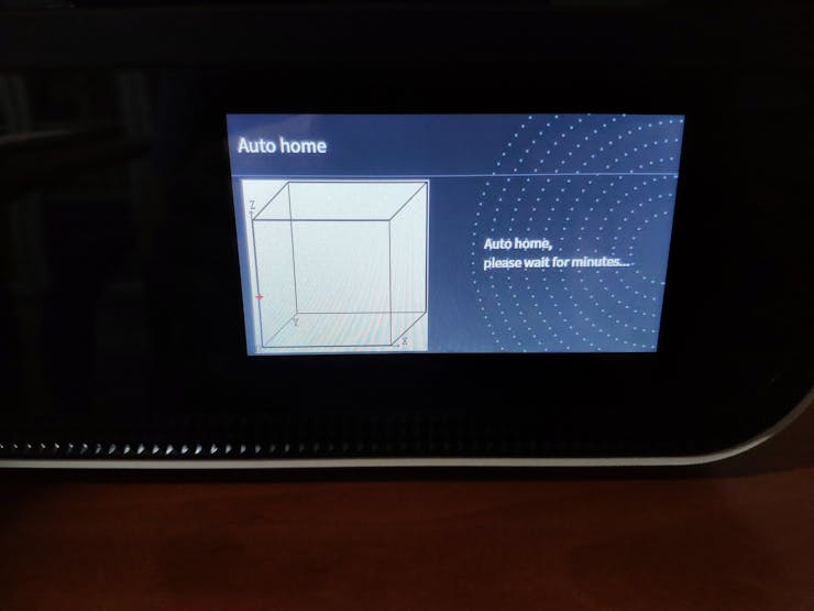

Finally, I printed all parts (models) with my Creality CR-200B 3D Printer. It is my first fully-enclosed FDM 3D printer, and I must say that I got excellent prints effortlessly with the CR-200B :)
If you are a maker planning to print your 3D models to create more complex projects, I highly recommend the CR-200B. Since the CR-200B is fully-enclosed, you can print high-resolution 3D models with PLA and ABS filaments. Also, it has a smart filament runout sensor and the resume printing option for power failures.

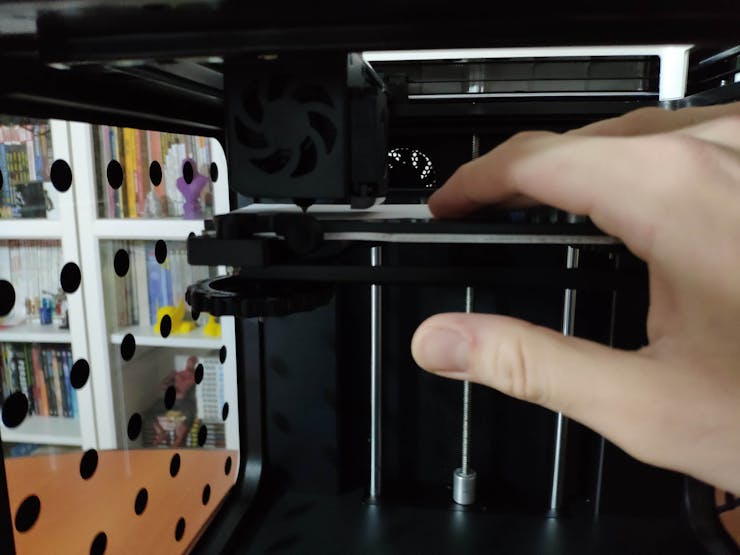

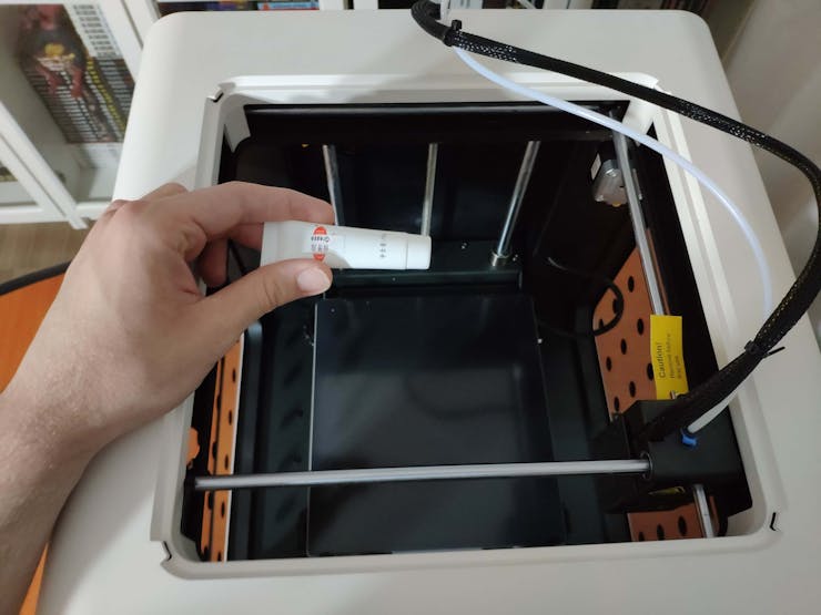

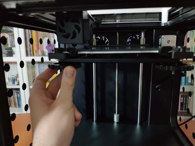

According to my experience, there are only two downsides of the CR-200B: relatively small build size (200 x 200 x 200 mm) and manual leveling. Conversely, thanks to the large leveling nuts and assisted leveling, I was able to level the bed and start printing my first model in less than 30 minutes.

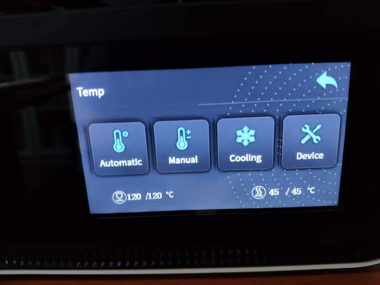

#️⃣ Before the first use, remove unnecessary cable ties and apply grease to the rails.
#️⃣ Test the nozzle and hot bed temperatures.

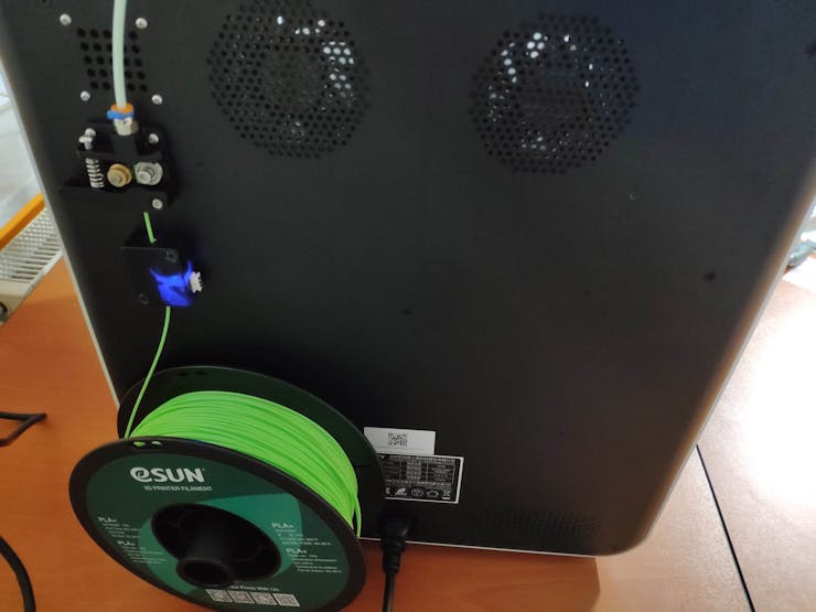

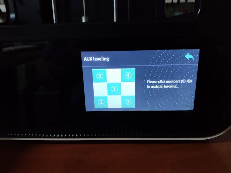

#️⃣ Go to Settings ➡ Leveling and adjust four predefined points by utilizing the leveling nuts.
#️⃣ Finally, attach the spool holder and feed the extruder with the filament.

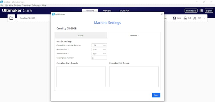

#️⃣ Since the CR-200B is not officially supported by Cura, select the Ender-3 profile and change the build size to 200 x 200 x 200 mm. Also, to compensate for the nozzle placement, set the Nozzle offset X and Y values to -10 mm on the Extruder 1 tab.

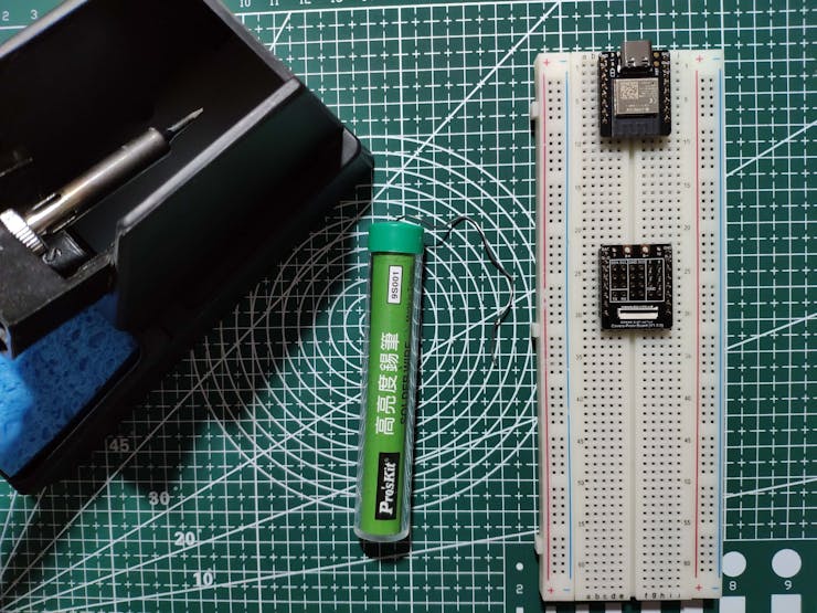

First of all, I soldered male pin headers to Beetle ESP32-C3 and its expansion board.

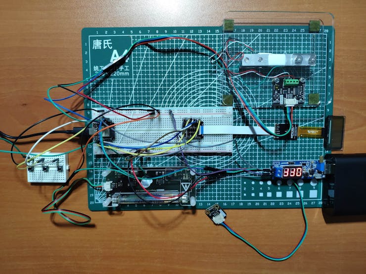

Then, to collect ionizing radiation, weight, and color (visible light) measurements, I connected a Geiger counter module (Gravity), an I2C HX711 weight sensor (Gravity), and an AS7341 11-channel visible light sensor (Gravity) to Beetle ESP32-C3. Since the expansion board provides the GDI display interface for DFRobot screens, I was able to connect the SSD1309 OLED transparent screen (Fermion) to Beetle ESP32-C3 via the expansion board.

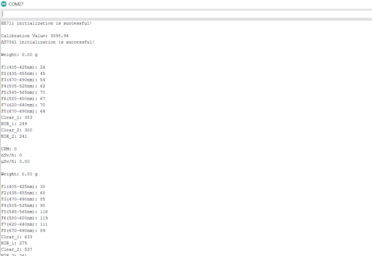

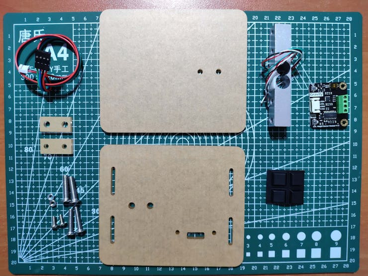

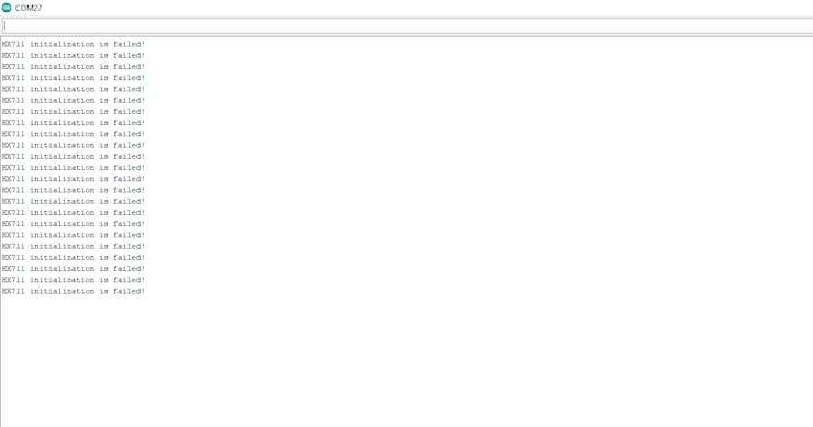

After assembling the weight sensor kit, to calibrate the weight sensor in order to get accurate measurements, press the cal button on the adapter board. Then, wait for the indicator LED to turn on and place a 100 g (default value) object on the scale within 5 seconds. When the adapter board completes calibration, the indicator LED blinks three times.
Since Beetle ESP32-C3 cannot power the Geiger counter module and the weight sensor simultaneously due to its working current, I connected a USB buck-boost converter board to my Xiaomi power bank to elicit stable 3.3V to supply the sensors.
Since the Geiger counter library needs to use an external interrupt pin for counting, the Geiger counter module can only be connected to external interrupt pins. Plausibly, Beetle ESP32-C3 allows the user to define any pin as an external interrupt.
To assign labels while transmitting the collected data and run my neural network model effortlessly, I added three control buttons (6x6), as shown in the schematic below.

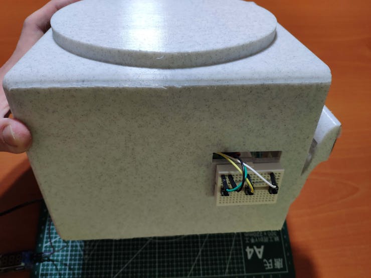

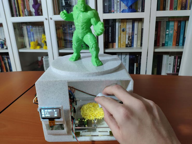

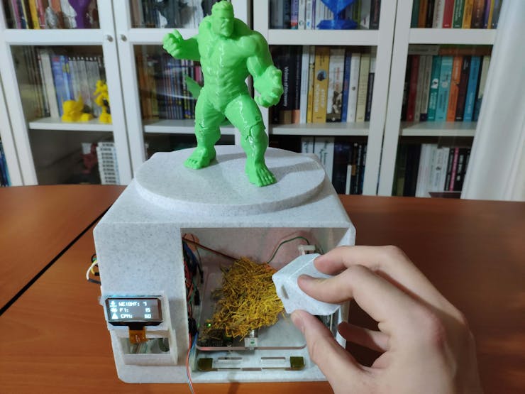

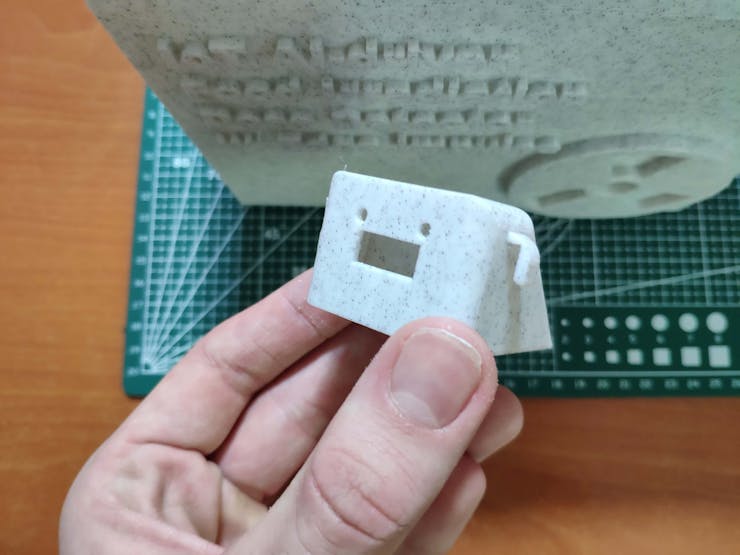

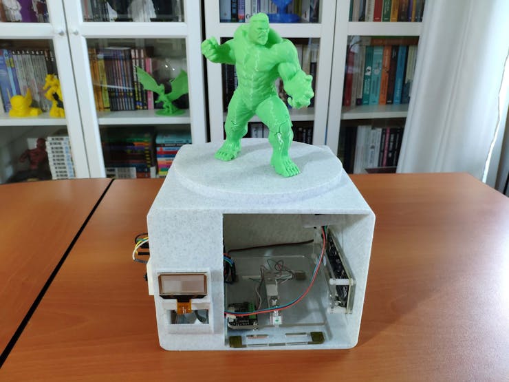

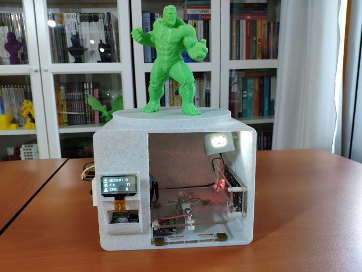

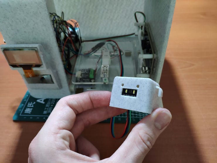

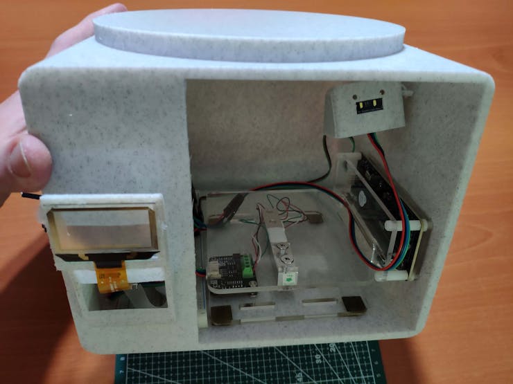

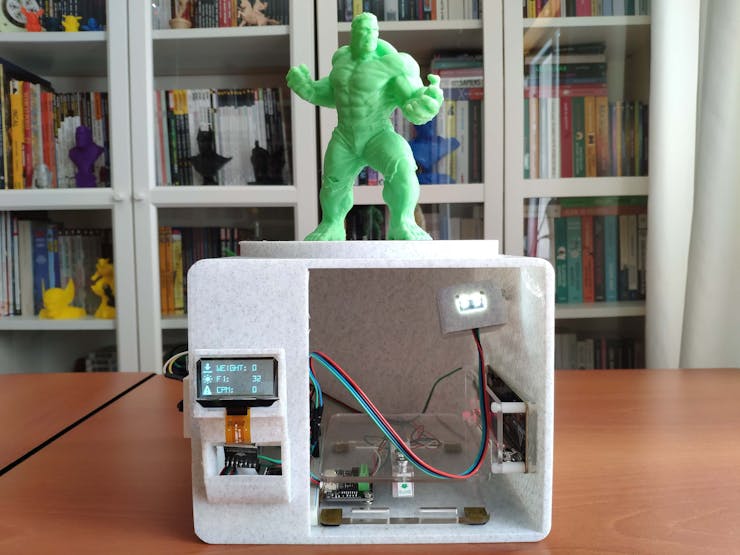

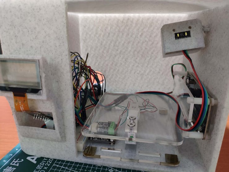

After completing sensor connections and adjustments on breadboards successfully, I made the breadboard connection points rigid by utilizing a hot glue gun.
After printing all parts (models), I fastened all components except the visible light sensor to their corresponding slots on the structure via the hot glue gun.
Then, I attached the visible light sensor to the moveable handle and hung it via its slot in the structure.
Finally, I affixed the Hulk replica to the top of the structure via the hot glue gun.

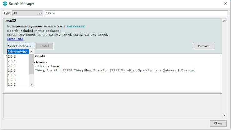

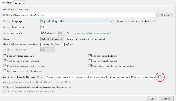

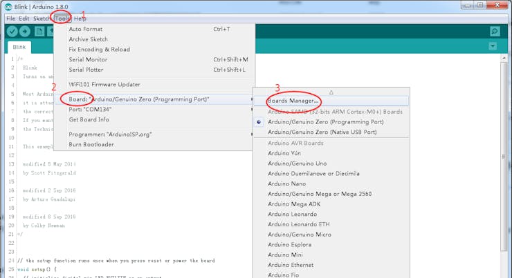

#️⃣ To add the ESP32-C3 board package to the Arduino IDE, navigate to File ➡ Preferences and paste the URL below under Additional Boards Manager URLs.
https://raw.githubusercontent.com/espressif/arduino-esp32/gh-pages/package_esp32_index.json
#️⃣ Then, to install the required core, navigate to Tools ➡ Board ➡ Boards Manager and search for esp32.

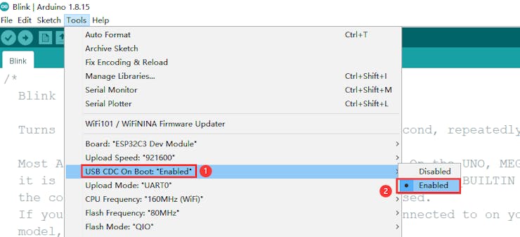

#️⃣ To print data on the serial monitor, enable USB CDC On Boot after setting Beetle ESP32-C3.

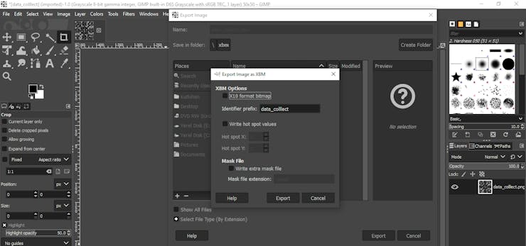

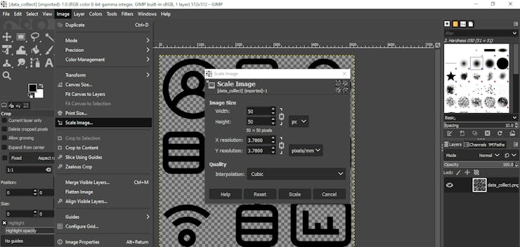

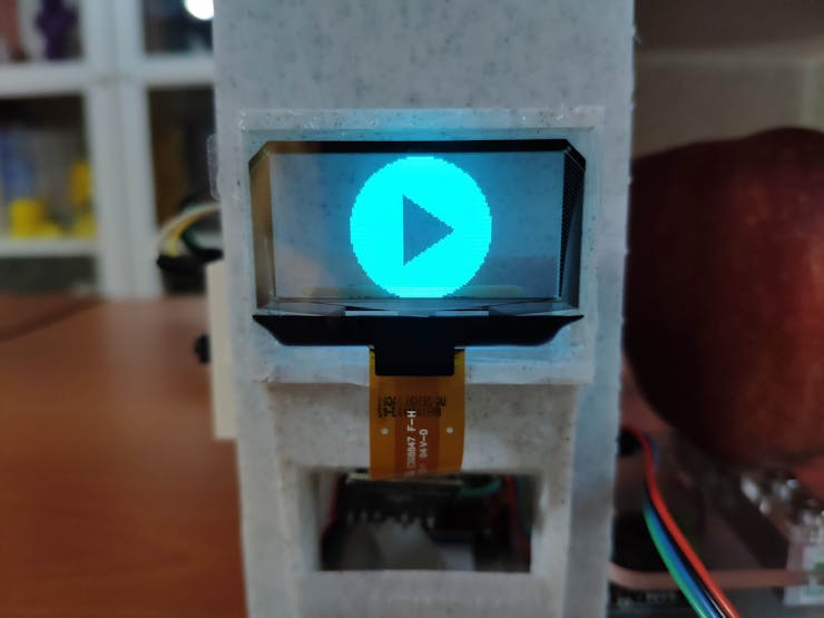

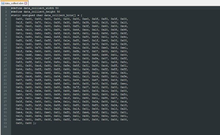

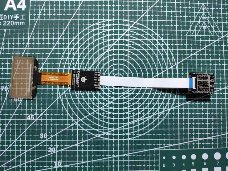

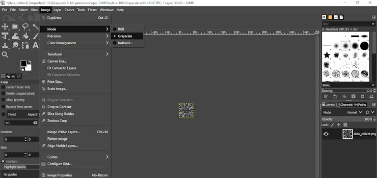

Step 4.1: Displaying images on the SSD1309 transparent OLED screen

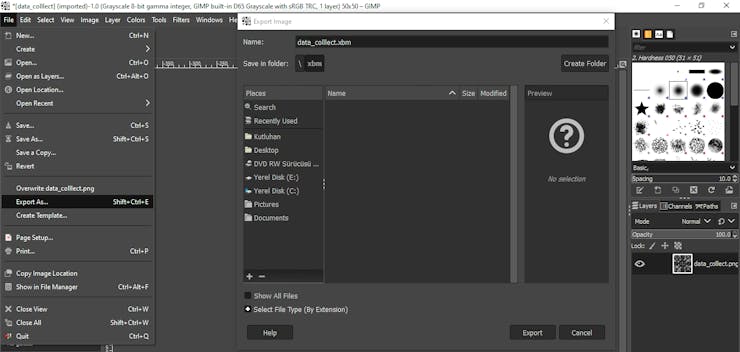

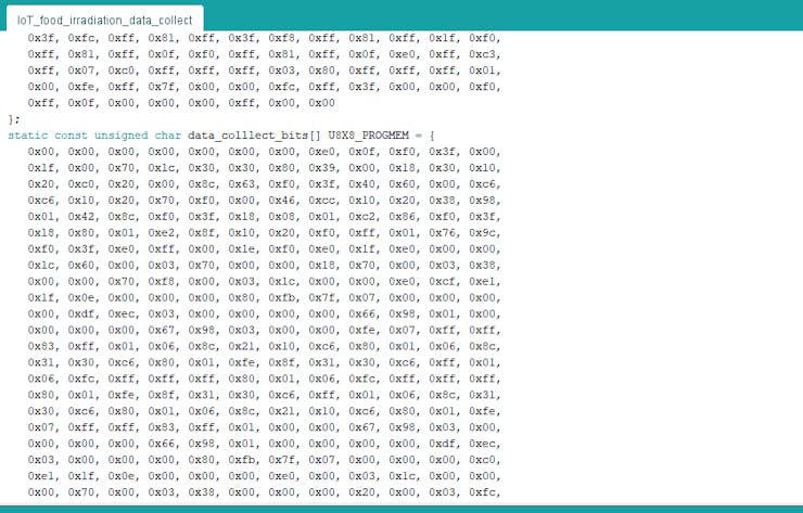

To display images (monochrome) on the SSD1309 transparent OLED screen successfully, I needed to convert PNG or JPG files into the XBM (X Bitmap Graphic) file format.
#️⃣ First of all, download GIMP.
#️⃣ Then, upload an image (black and white) and go to Image ➡ Scale Image... to resize the uploaded image.
#️⃣ Go to Image ➡ Mode and select Grayscale.
#️⃣ Finally, export the image as an XBM file.
#️⃣ After exporting the image, add the generated data array to the code and print it on the screen.
u8g2.firstPage(); do{ //u8g2.setBitmapMode(true /* transparent*/); u8g2.drawXBMP( /* x=*/36 , /* y=*/0 , /* width=*/50 , /* height=*/50 , data_colllect_bits); }while(u8g2.nextPage());

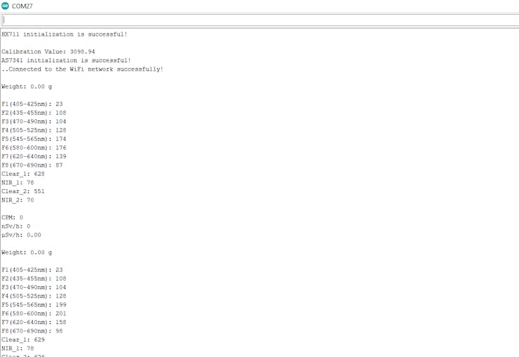

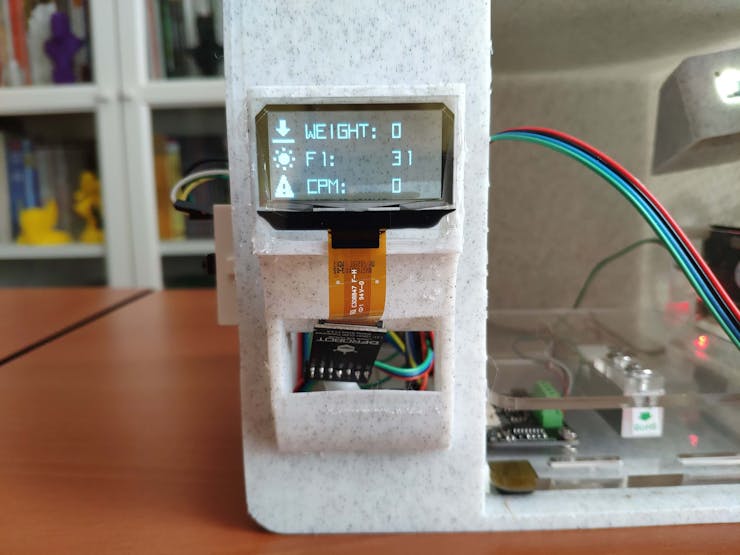

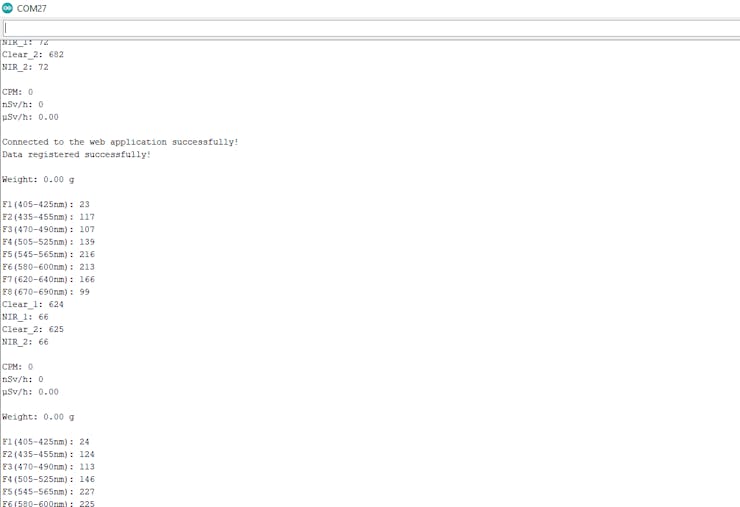

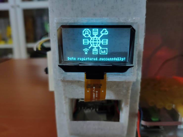

After uploading and running the code for collecting data and transmitting data packets to the web application on Beetle ESP32-C3:

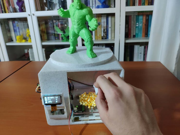

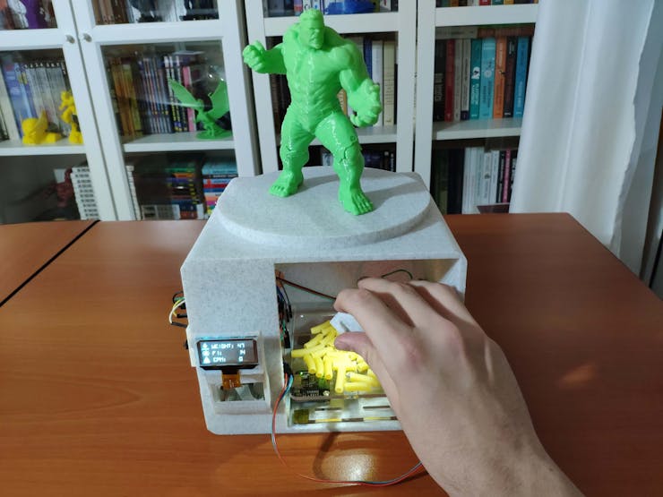

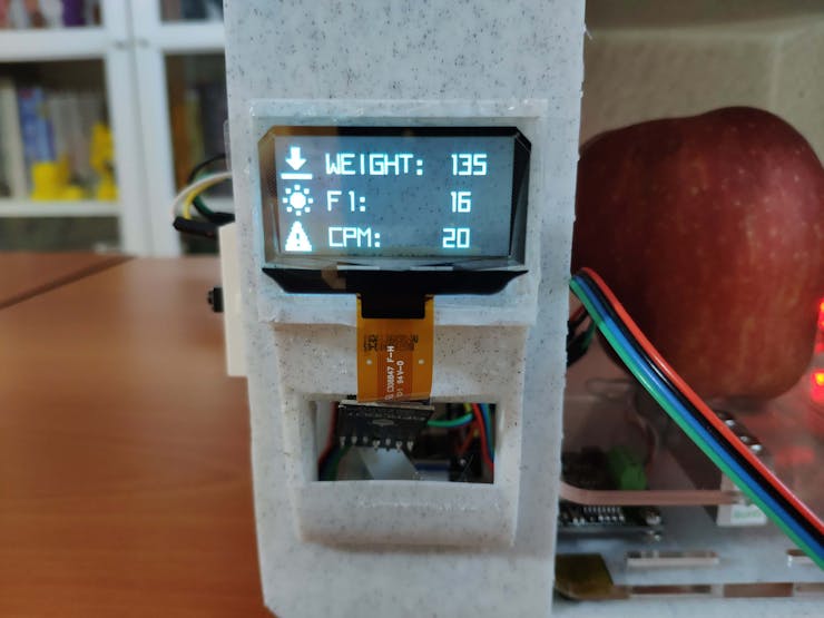

☢️🍱 The device waits for the Wi-Fi module to connect to the given Wi-Fi network.

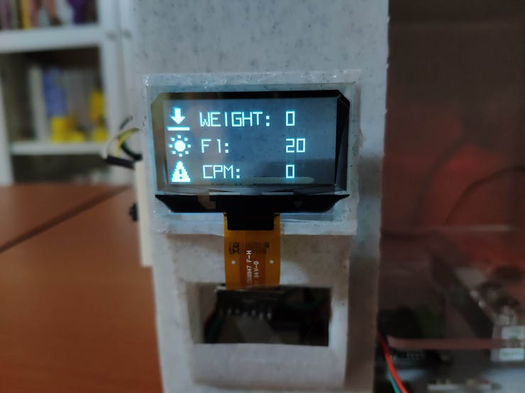

☢️🍱 Then, the device displays a modicum of the collected data on the SSD1309 OLED transparent screen.
- WEIGHT (g)
- F1 (405 - 425 nm)
- CPM (Counts per Minute)

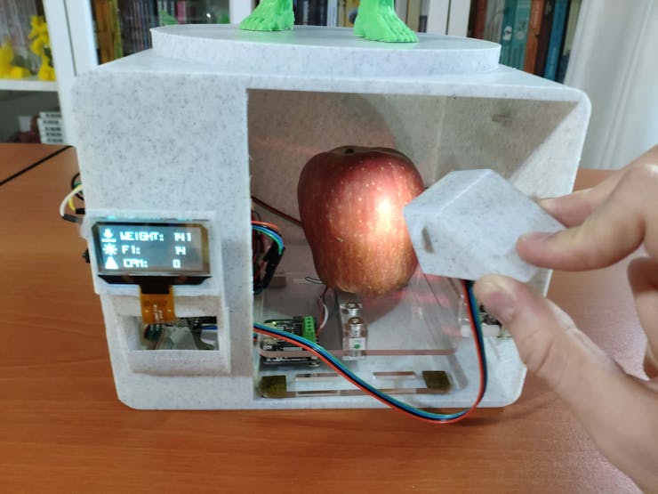

☢️🍱 The device allows the user to collect visible light (color) data at different angles with the moveable handle.
☢️🍱 If one of the control buttons (A, B, or C) is pressed, the device transmits the recently collected data by adding the selected food irradiation dose class to the given web application.
- Control Button (A) ➡ Regulated [0]
- Control Button (B) ➡ Unsafe [1]
- Control Button (C) ➡ Hazardous [2]
☢️🍱 Then, if the web application appends the transferred data packet to the MySQL database successfully, the device shows this message on the SSD1309 OLED transparent screen: Data registered successfully!

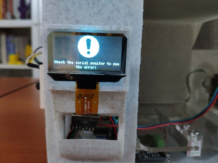

☢️🍱 If Beetle ESP32-C3 throws an error while operating, the device shows the error message on the SSD1309 OLED transparent screen and prints the error details on the serial monitor.
☢️🍱 Also, the device prints notifications and sensor measurements on the serial monitor for debugging.
As far as my experiments go, the device operates impeccably while collecting measurements and transmitting data packets to a given web application :)

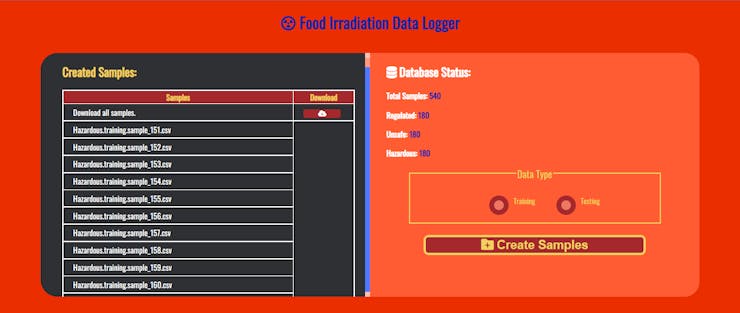

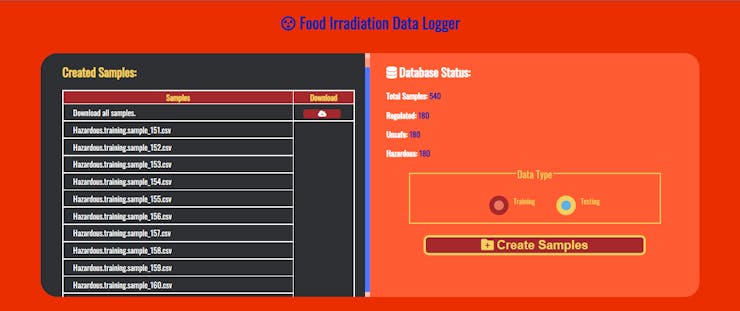

Step 5.2: Creating samples from data records with the web application
After logging ionizing radiation, weight, and visible light (color) measurements in the MySQL database from a motley collection of foods, exposed to sun rays as a natural source of radiation for estimated periods, I elicited my data set with eminent validity.

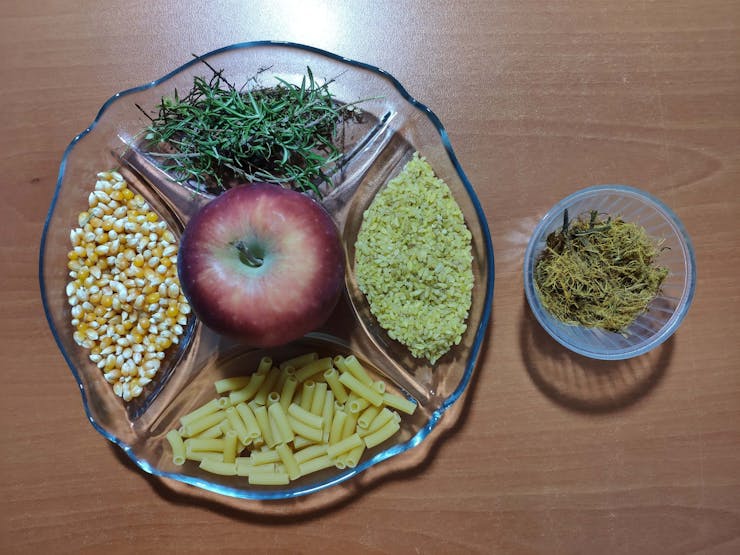

📌Foods:
- Pasta
- Corn kernel
- Herb
- Apple
- Wheat
- Animal (livestock) feed

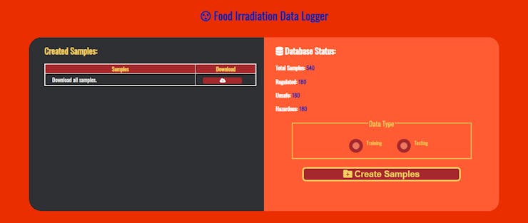

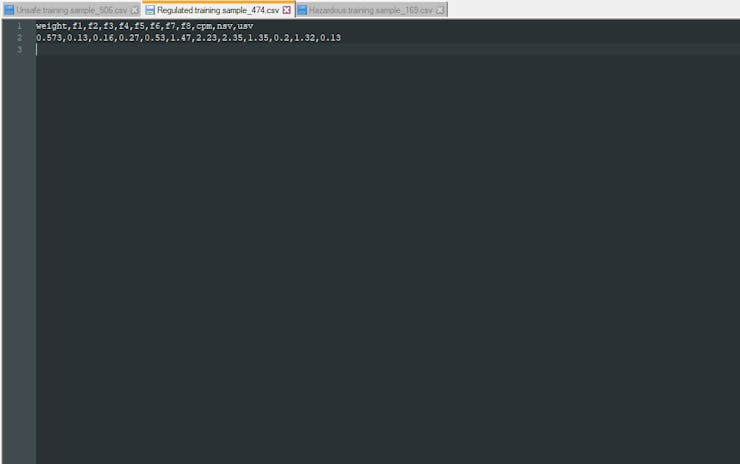

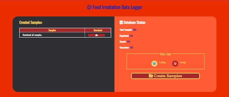

As explained in Step 2, I generated a CSV file (sample) for each data record in the MySQL database by utilizing the web application.
☢️🍱 The web application shows the total number of data records for classes (labels) in the database.
☢️🍱 If the user clicks the Create Samples button, the web application scales data items and generates a CSV file (sample) for each data record, depending on the selected data type (training or testing).
☢️🍱 If the user clicks the Download button, the web application downloads all generated CSV files (samples) in the ZIP file format.

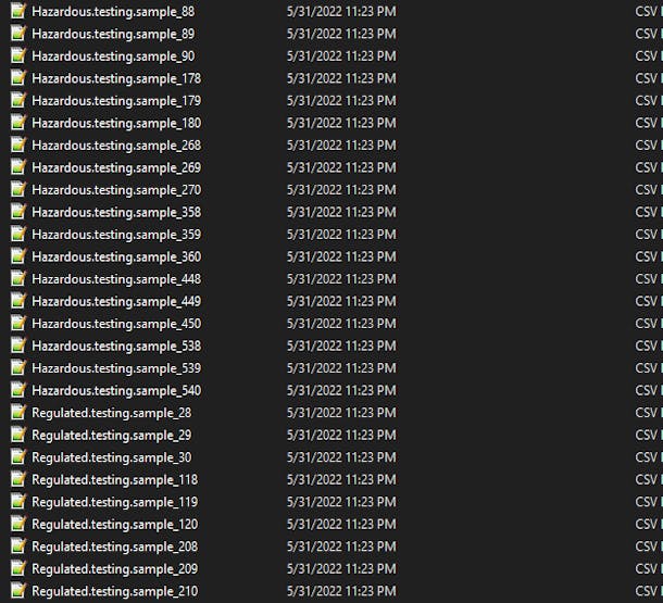

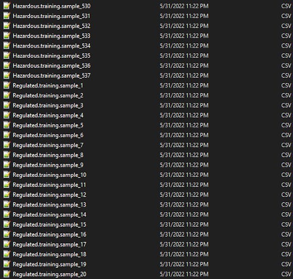

📌 Training samples:
📌 Testing samples:

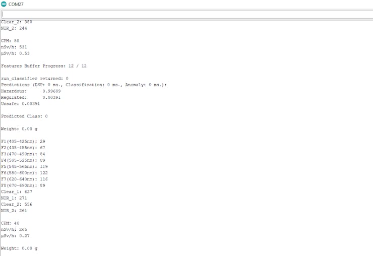

When the features array (buffer) is full with data items, my Edge Impulse neural network model predicts possibilities of labels (food irradiation dose classes) for the given features buffer as an array of 3 numbers. They represent the model's "confidence" that the given features buffer corresponds to each of the three different food irradiation dose levels (classes) based on ionizing radiation, weight, and visible light (color) measurements [0 - 2], as shown in Step 6:
- 0 — Regulated
- 1 — Unsafe
- 2 — Hazardous

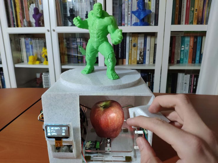

After executing the IoT_food_irradiation_run_model.ino file on Beetle ESP32-C3:
☢️🍱 The device displays a modicum of the collected data on the SSD1309 OLED transparent screen.
- WEIGHT (g)
- F1 (405 - 425 nm)

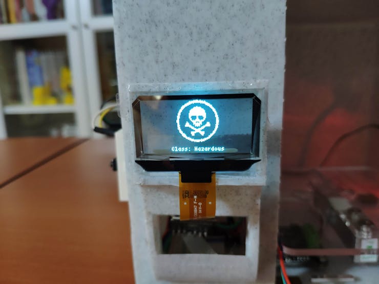

☢️🍱 If the control button (B) is pressed, the device runs an inference with the Edge Impulse model by filling the features buffer with the recently collected ionizing radiation, weight, and visible light (color) measurements.
☢️🍱 When the device starts filling the features buffer with data items, it shows:

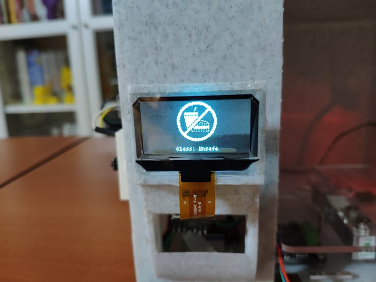

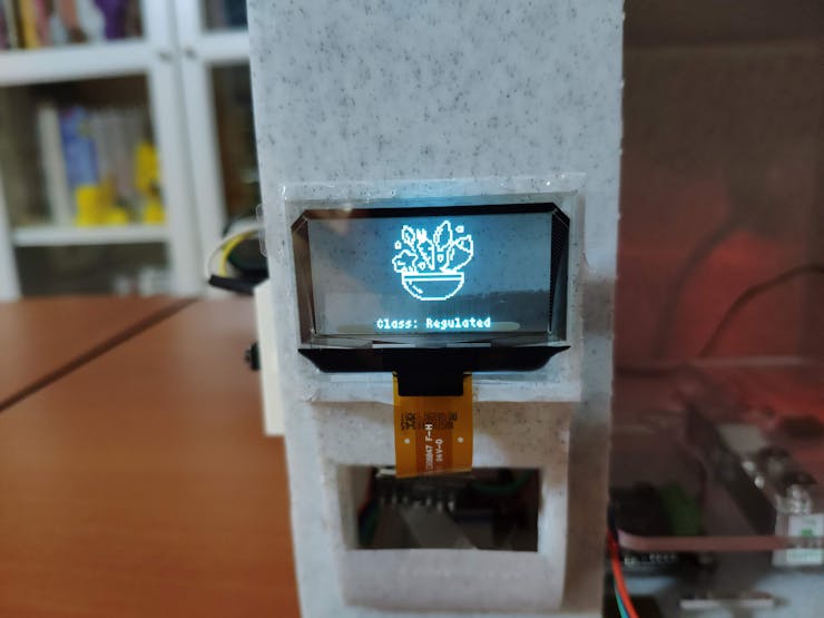

☢️🍱 Then, the device displays the detection result, which represents the most accurate label (food irradiation dose class) predicted by the model.
☢️🍱 Each food irradiation dose level (class) has a unique monochrome icon to be shown on the SSD1309 OLED transparent screen when being predicted (detected) by the model:
- Regulated
- Unsafe
- Hazardous
As far as my experiments go, the device predicts food irradiation dose levels (classes) accurately by employing the collected measurements :)
