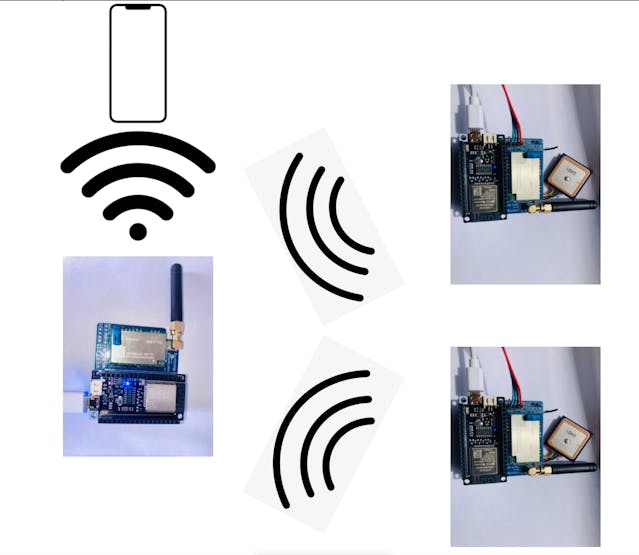

First off, I had to think of a good way for communication; I had to get the data from my sailboat, to a smartphone on land. Many places I go sailing, don't have any cellular signal, so cellular modules wouldn't work. I still want long distances though, so what else besides LoRa (it stands for Long Range radio)! iPhones communicate via WiFi, Bluetooth, or cellular; not radio. So, I decided on a perfect setup as pictured below:
Sailboat Monitoring Connection Diagram
Both of the right nodes, collect and send all of the GPS data and accelerometer data to the base station on the left, which relays the info to a webpage that it hosts on its own network.
To use it on your phone, you connect to the WiFi network "Sailboat Monitoring", then go to your favorite browser and type in "192.168.4.1" (the base station's IP address). A webpage pops up with all of the data from both nodes on it!

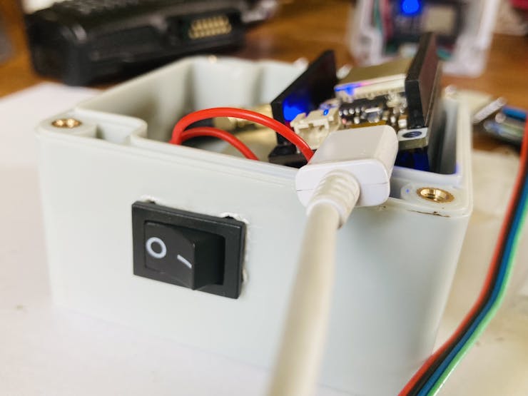

To make this project as permanent as possible, I decided to put everything into a waterproof project enclosure I found on amazon.
I used my soldering iron to create a hole for the antenna, and a hole for a power switch I decided to add.
1 / 2 • Power Switch

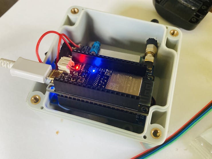

To put everything into the case, I first attached the battery to the FireBeetle, then set it in the bottom. Next went the FireBeetle, already inserted into the 12KM LoRa shield I designed. Lastly (for the transmitters), I hot glued the accelerometer to the wall of the enclosure, to keep it steady, and placed the gps module / antenna on top of the radio module.
1 / 2
Everything was a tight fit, but I managed to squeeze it in there. I did place some thin packing material foam between the battery and the rest of the parts, to prevent the battery being punctured.

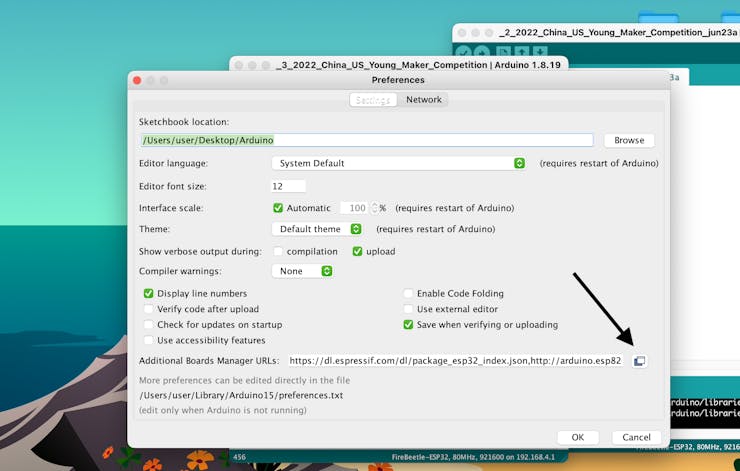

Adding Fire-Beetle to the Arduino IDE
A quick note: the FireBeetle I used is the "FireBeetle ESP32", not the newer "FireBeetle ESP32-E".

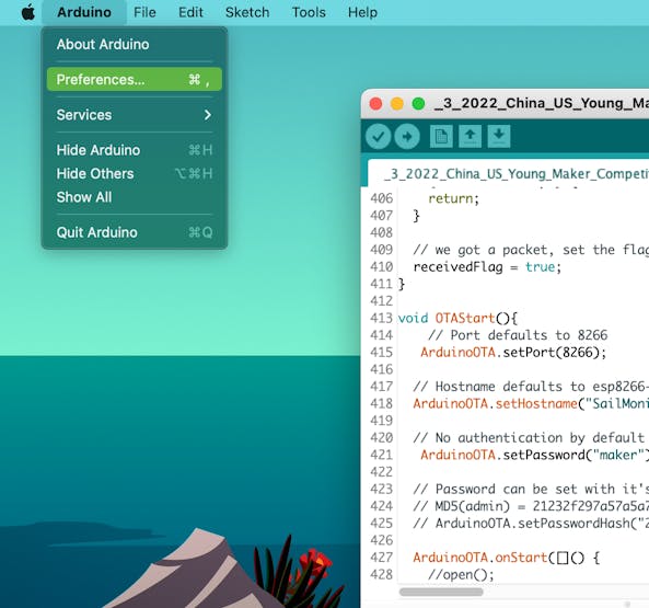

First, open your Arduino IDE and go to Arduino / Preferences.
Then click on the window icon next to Additional Boards Manager URLs.
Next, copy and paste this link (https://dl.espressif.com/dl/package_esp32_index.json) into the window that pops up.
Now click the OK button on both windows.

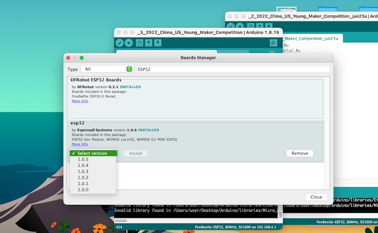

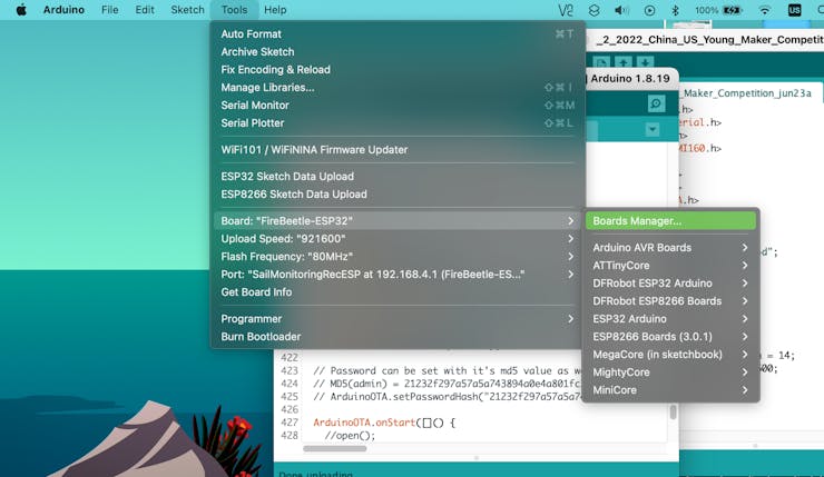

Next, go to Tools / Boards / Board Manager.
Then search for "ESP32"; a "esp32" board addition should show up. Click on the newest version and click install.
That's it! Now, if you go to Tools / Board you should find a ESP32 folder, in which will be a "FireBeetle ESP32" board option. Select this as the board type for programming.
