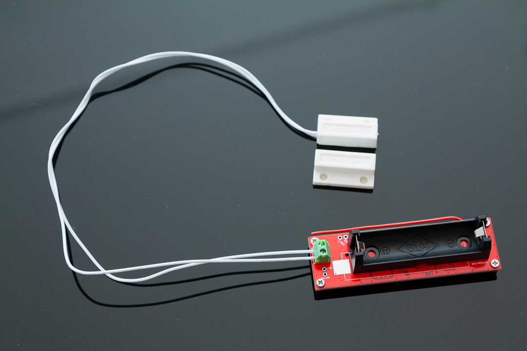

Reed sensor
The reed input is internally pulled up to 1.8V. In case the circuit is closed, a small current (~240 nA) flows through the pull up resistor to GND. The magnetic reed switch shown in the picture is a NC (normally closed) switch.
When the magnet is near the switch, that is: when the door/window is closed, the circuit is open and no current will flow. When the door/window is opened, a small current will flow until it is closed. Each transition will be transmitted via a radio message. Of course you can use a "normally open" switch too - in that case current will flow when the door or window is closed, and stop flowing once it is open.
Apart from reed sensors, you can also connect a button to the input. On each press of the button, the wire terminals will be connected to each other and the sensor will detect this transition.
Another possibility (requiring a firmware change, though) would be to use the button input as a frequency counter.
