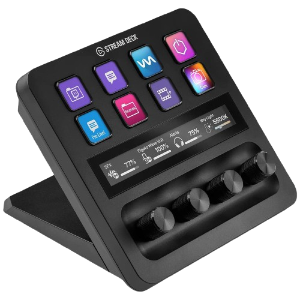

I came across the term "Stream Deck", which is apparently the product name of a glorified macro keyboard that costs just over half as much as my entire console did. As with everything, it has its pro's and con's, and "of course" it has no Linux software. But hey, here's the keyword should you be searching for it.
Of course, there are free alternatives, such as deej. I haven't looked too closely at that yet; I might be able to make use it or some of its ideas.

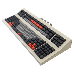

There is also the Hyper7 R4 (which they call a "173% Keyboard") but, while it looks super cool, it has a "measly" 178 keys and costs 3-4 times as much as this old monstrosity. Besides, it's just more fun to build things yourself, is it not?
A variant of a Stream Deck
One of many variants of a Stream Deck
Hyper7 R4 keyboard
Hyper7 R4 keyboard with its 178 keys and carrying handle
