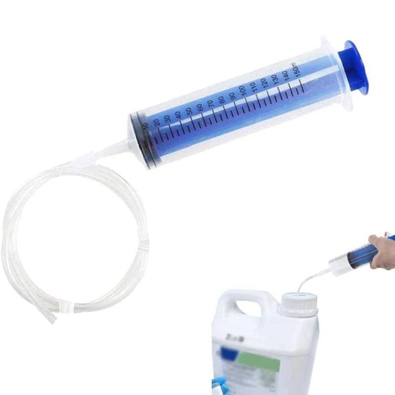

- Hydraulic pumps and its relation to high pressure artificial muscles. I need to calculate the amount of flow.
My first thought was, like I said in the Project Log 13, using manual hydraulic pumps with electric motors. I thought it was the best option, but the pressure is generated too slowly, so I would need a hydraulic accumulator, and the following reasons will clarify why.

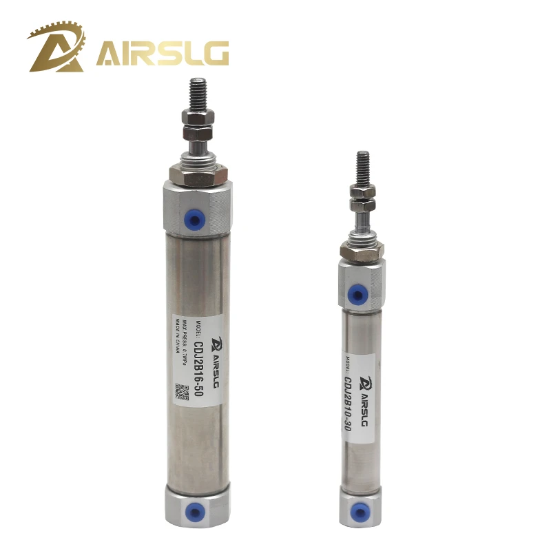

- Hydraulic accumulators.
Basically, one could simply use a cheap 12V tire inflator/air compressor to fill up a bladder hydraulic accumulator. But these are expensive, and I don't know how long a 300 PSI air compressor for tires will take to fill up homemade sketchy bladders. Also, pneumatics are kinda dangerous, they can explode.
Also, one doesn't really neeed bladders, I could simply use a car spring that is pulled by a electric motor. Like a electric jack/linear actuator. When the spring is pulled, the hydraulic oil will be forced in by vacuum action, then I just need to release the spring and the compression of the spring will compress the hydraulic fluid and that's it.
Kinda of, I need to find a way of calculating that. I remember once reading an scientific paper of a "novel design of hydraulic accumulator" or something among these lines, I need to find it again. Maybe they have a model/equation that I can use to guess how much pressure it will generate, if there isn't already an option that I can buy online. For some reason, the electric jack/lineart actuator is more expensive than the hydraulic jack... Bruh.
Found the article: "A novel pump design for an efficient and compact Electro-Hydraulic Actuator IEEE aerospace conference".
No, actually, I think it was this one: "Development of a novel compact hydraulic power unit for the exoskeleton robot".
Or I could simply use a electric jack directly compressing the hydraulic fluid... I could also make a homemade pulley that pulls the hydraulic accumulator spring. Homemade because the fricking electric pulleys use the same 1hp electric motors the high pressure hydraulic pumps use, so... bruh.
Dunno what is the best option, I will need to calculate every single one of these. I hope the people I invited to this project could be able to give me a hand, we probably know as much as each other, but 4 heads think more than 1. - Costs.

So, since no hydraulic pump is cheap, nor simple, I was thinking on make one by hand with off the shelf materials.
Like with those big syringes for food/oil with one way valves inserted on them (these can also be used *for other things*, but this isn't a enfermary project log, lol).
Like in the example above.

Anyway, back to the syringes:
First, I would need to find a way to either make a piston pump from plastic syringes without the rubber part, or use glass syringes (that can break).
As you can expect, the rubber creates a lot of friction during the movement of the piston. I could, maybe, attach a membrane to the piston instead of the rubber sealing.
But I have no idea how I would do that without weaken the membrane itself, and if I where to actually modify the syringes that much, I would be better just using metal tubes with a membrane.
The glass syringes have such small margins of error that they are literally air tight.
And funny enough, these are surprisingly cheap, cheaper than the plastic ones in some cases. And these wouldn't need any kind of modification, the friction would be (almost) negligible.
The problem is that these are made of glass... Even though some suppliers say they are made of borosilicate, it is hard to tell how well these would endure, since these are meant for medical usage, not hydraulic pumps.
(I tried to search for metal ones, but those also have rubber seals)

So, I will use the pneumatic cylinder dimensions as a basis for the hydraulic pump (just like as I said before).
I will calculate the amount of hydraulic fluid flow generated by a single cylinder with two way (meaning it produces more or less the same amount of flow when going forward and backwards).
Accordingly to the Aliexpress ad I chose, this one has a 50mm stroke (the piston moves 50mm in both directions), with a 16mm inner bore and 18mm outer bore (if I didn't read it incorrectly).
It says it was tested with pressures of 1 MPa and an operating pressure of 0.06 MPa.

So, let's calculate for real this time:
- (cm^3/rev) = π * r^2 * s * n
- r = 0.8 cm
- s = 5 cm
- n = 10 (it is actually 5, but as I said: they also produce flow when they are pulled).
- π x 0.8² x 5 x 10
- cm³/rev = 100.530964915
Now taking viscosity into account:
- Flow rate (liters/minute) = (pump displacement (cm^3/rev) * pump speed (rev/minute) / (10^6 cm^3/liter)) * (viscosity (cP) / density (kg/liter))
- Cm³/rev = 100.530964915
- Rev/Min = 1000 (this is normally the maximum speed of a stepper motor, these can reach 6000 or more depending on the motor).
- cm^3/liter = 10 cm3 (I don't know if this is the right value, I just calculated how much liquid would be inside the piston and converted to cm³).
- viscosity (cP) = 32
- Density (kg/liter) = 0,9
- 100.530964915 x 1000 / (10^6(10) x 32 / 0.9
- 0.3574434308
- There must be something wrong. Why the heck I need to multiply cm³ by 10^6?
