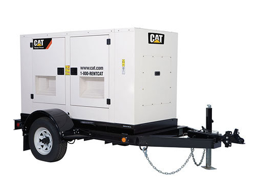

Now, the pump would need to give 578.88 liters per second.
And I had all this problem for just 900 liters per MINUTE.
I would need a pump that puts out...
34732,8 liters per minute.
That's like... 38.5 times more power than 900 liters of the would pump.
So I would need 38.5 times more energy, which would make the batteries 38.5 times bigger. Which would increase costs by 38.5 times.
I needed 750 watts for 900 liters per minute, so...
I would need 28875 watts.
This is a 30000 watt (30kw) Diesel generator.
This is the POWER SOURCE.
Of course, I could simply attach the diesel engine to the hydraulic pump.
This is a 30hp diesel engine, which is a little more than 28kw watts (1 horsepower = 750 watts).
Also, the 200 liter oil tank will be more or less the same size.
