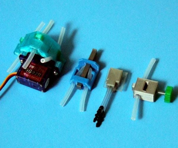

However, since I'm changing the working fluid to plain water, and using centrifugal water pumps (that are normally used for pools or aquariums), this instantaneous progressive valve won't be possible anymore.
So, the obvious step to take was using servo valves, the 3D printed ones, the price commercial ones are obscene.
Some 3D printed servo valves simply strap a micro servo to a regulatory valve:
Link for this valve (there are tons of STL archives on servo valves).
Others use what is called a "pinch valve", simply put, it is a valve that squeezes the hoses, just like one would do when watering their garden.
These are from this link.
There are a lot of ways of doing a pinch valve.
She posted the link to a github with the archives in her comment section.
However, those kinda present two problems: speed and torque.
Micro servos aren't known for being fast, neither strong, and I'm talking about really big hoses here.
