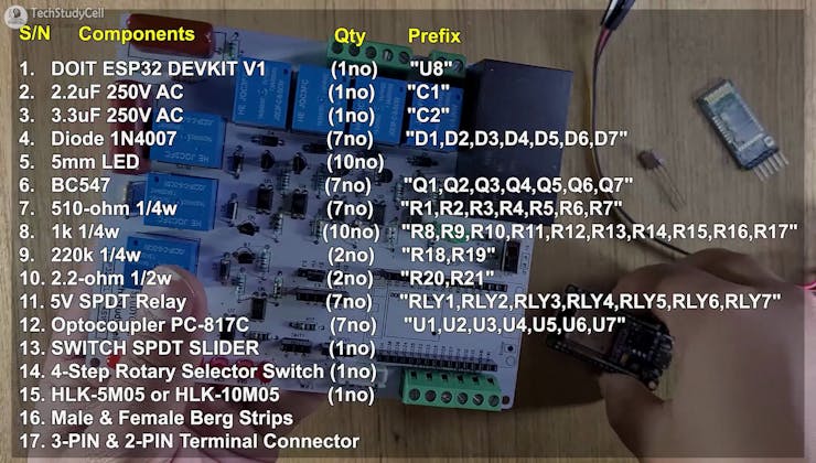

Required components (for PCB):
- 1. DOIT ESP32 DEVKIT V1 (1no) "U8"
- 2. 2.2uF 250V AC (1no) "C1"
- 3. 3.3uF 250V AC (1no) "C2"
- 4. Diode 1N4007 (7no) "D1, D2, D3, D4, D5, D6, D7"
- 5. 5mm LED (10no)
- 6. BC547 (7no) "Q1, Q2, Q3, Q4, Q5, Q6, Q7"
- 7. 510-ohm 1/4w (7no) "R1, R2, R3, R4, R5, R6, R7"
- 8. 1k 1/4w (10no) "R8, R9, R10, R11, R12, R13, R14, R15, R16, R17"
- 9. 220k 1/4w (2no) "R18, R19"
- 10. 2.2-ohm 1/2w (2no) "R20, R21"
- 11. 5V SPDT Relay (7no) "RLY1, RLY2, RLY3, RLY4, RLY5, RLY6, RLY7"
- 12. Optocoupler PC-817C (7no) "U1, U2, U3, U4, U5, U6, U7"
- 13. SWITCH SPDT SLIDER (1no)
- 14. 4-Step Rotary Selector Switch (1no)
- 15. HLK-5M05 or HLK-10M05 (1no)
- 16. Male & Female Berg Strips
- 17. 3-PIN & 2-PIN Terminal Connector
- 18. HC-05 Bluetooth module.
- 19. TSOP1838 IR Receiver (with metallic case)
- 20. Amazon Echo Dot

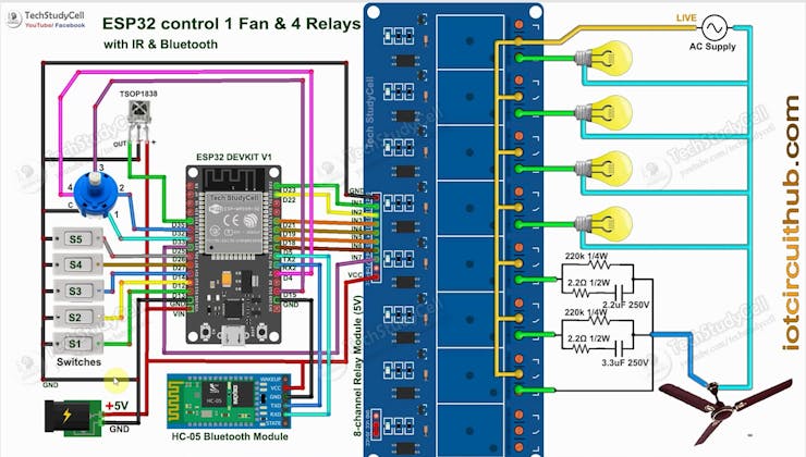

Circuit Diagram of the ESP32 Project
The circuit is very simple, I have used the GPIO pins D23, D22, D21 & D19 to control the 4 relays.
And the GPIO pins D13, D12, D14 & D27 are connected with switches, and GPIO D33, D32, D15 & D4 are connected with a 4-step selector switch to control the relays manually.
I used the INPUT_PULLUP function in Arduino IDE instead of the pull-up resistors.
IR remote receiver (TSOP1838) connected with D35.
The TX pin of the Bluetooth or BLE module is connected to the RX2 (GPIO16) pin of ESP32 for serial communication.
I have used a 5V mobile charger to supply the smart relay module.
Please take proper safety precautions while working with high voltage.

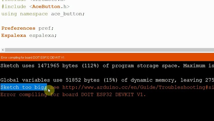

**I have not used the inbuilt Bluetooth of the ESP32, as the total size of the sketch is bigger than the ESP32 flash memory.
