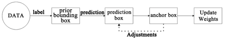

2.4 Implementation Process
After data is calibrated, a priori box occur on the image. Next, model generates a prediction box subjecting to the position of priori box. Anchor box is generated whenever prediction box is generated. Lastly, the weight of this training is updated to the model.
Each newly generated prediction box is affected by the last generated anchor box. The above operation will be repeated to eliminate deviation in prediction box’s size and position till the prediction box and priori box coincide.

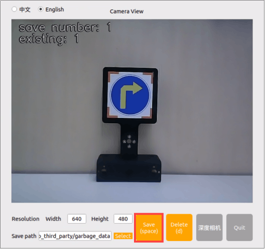

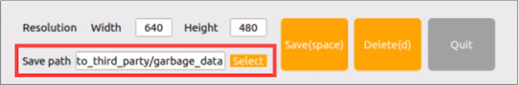

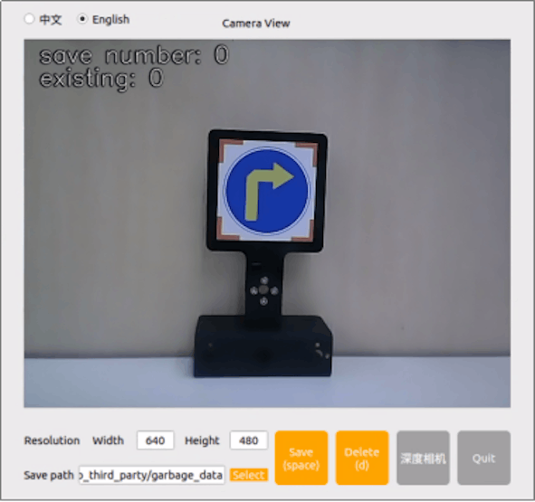

5) Double click 📷 on the desktop to open image acquisition tool.
save number” refers to picture ID i.e. the number of picture saved. “existing” represents the quantity of pictures saved
6) Change the storage path as “/home/jetauto/my_data”.
7) Place the object to be recognized within the camera field of view. Then click “Save(space)” button or press space bar to capture the current frame of camera image.
JPEGImages folder used to store pictures will be generated automatically under “/home/jetauto/my_data” after you click “Save(space) button”
Note: to increase model credibility, please photography the target from different distances, rotation angles and tilt angles.

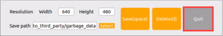

8) Having finished collecting images, click “Exit” button.

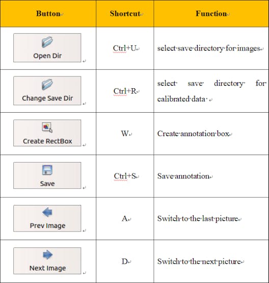

1) Open image annotation tool on desktop. The functions of buttons on this tool are as follows.

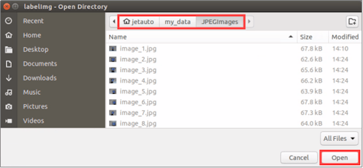

2) Press the shortcut key "Ctrl+U", select the image storage directory as "/home/jetauto/my_data/JPEGImages/", and click "Open" button.

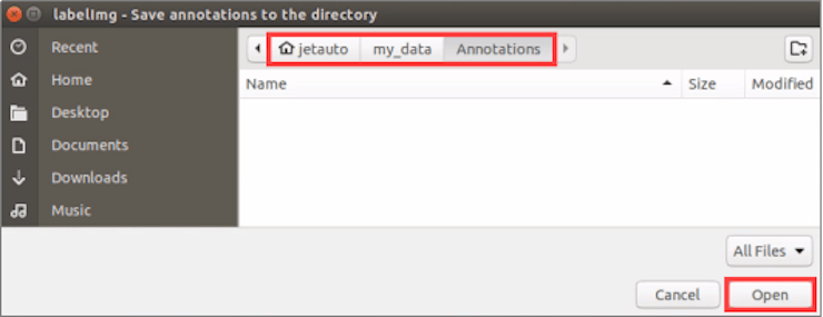

3) Press the shortcut key "Ctrl+R", choose calibrated data storage path as “/home/jetauto/my_data/Annotations/”, and click “Open” button.

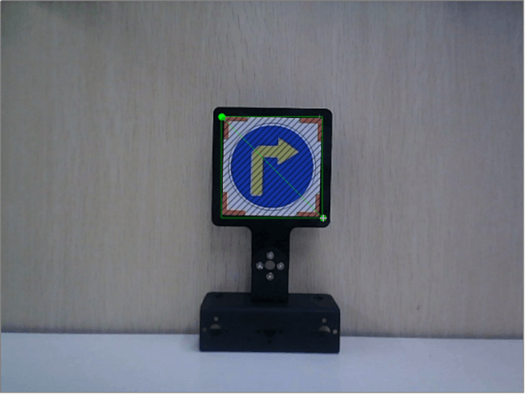

4) Press “W” key to create annotation box.
Move your mouse to appropriate position, then drag the annotation box to cover the whole target object by pressing left button mouse. When you finish, release the mouse.
5) Name the target recognized content in the pop-up window, and this image is named as “right”. After that, click "OK" button, or press "Enter" key to save the name.

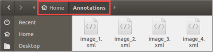

7) Follow step 4-6 to annotate the rest pictures.
8) Open file manager, then enter directory “/Home/my_data/Annotations/” to check annotation files of pictures.

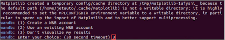

4) When you are required to “Enter to your choice”, input “3” and press Enter.
The following content means the model is being training.

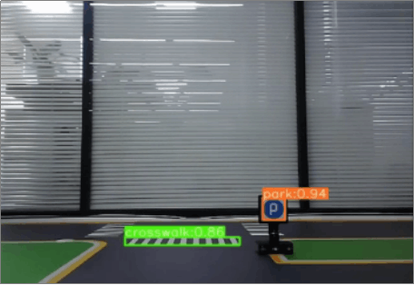

4) Open a new terminal. Input command “rqt_image_view” and press Enter to open camera returned image.
jetauto@jetauto-desktop:~$ rqt_image_view
Place the road sign within the camera field of view. When road sign is recognized, it will be framed, and its name and recognition confidence will be printed on the camera returned image. Besides, detection information will be printed on the terminal.
class_name” is name of the object to be recognized. “box” is the starting coordinate and ending coordinate of the box. “score” is the recognition confidence.
