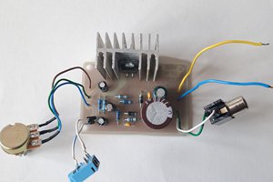

The first test device is made with MJE13007 type transistors. These are NPN Bipolar Power Transistors which are designed for Switching Power Supply Applications.
For the consumer, I used an LED lamp with a power of 8 and 10 watts. We can trace the shape of the output signal before the output rectifier on the oscilloscope. In this case, the DC output voltage is about 240 Volts, and the current is about 8 milliamperes. With a small increase in the power of the consumer, the output voltage drops sharply. These are approximately the limit possibilities of this type of converter.
Next we will test an inverter made with IRF3205 mosfets. The circuit diagram is a bit more complicated, but the features are therefore better.
The DC output voltage is also around 240V and remains above 200V even with a load of 50 to 70 milliamps (10-15 watts). During long-term load, the mosfets remain cool.

The most difficult part in making the inverters is to find out the correct terminals of the switching transformer. Here are some tips on how to do that. One side of the transformer always has only two active terminals and in our case it is always the secondary winding on which the high voltage is induced. On the primary (other) side there are usually more active leads. There is usually one thicker longer wire which always represents the middle lead. We can determine the other two terminals experimentally, and these are usually either the two middle terminals, or the two terminals at one end.
Based on the previous tests, follows a short conclusion. A common positive feature for both devices is that they use a minimal number of components, are extremely simple to build, require no setup, and almost always work immediately after assembly.

The first device with 13007 transistors has almost no use value, except for a simple presentation of how switching devices work. At a load of only a few milliamps, the output voltage drops drastically, so that only a LED lamp of a maximum of 3 Watts can be powered.
The second inverter made with Mosfets is a bit more complicated and generally represents a ZVS driver circuit with several omitted components, since the supply voltage is limited to 12V. At the output, at a voltage greater than 200V, it can deliver a solid 10 watts (about 50 milliamperes) constantly, and in this case the total consumption of the circuit is...
