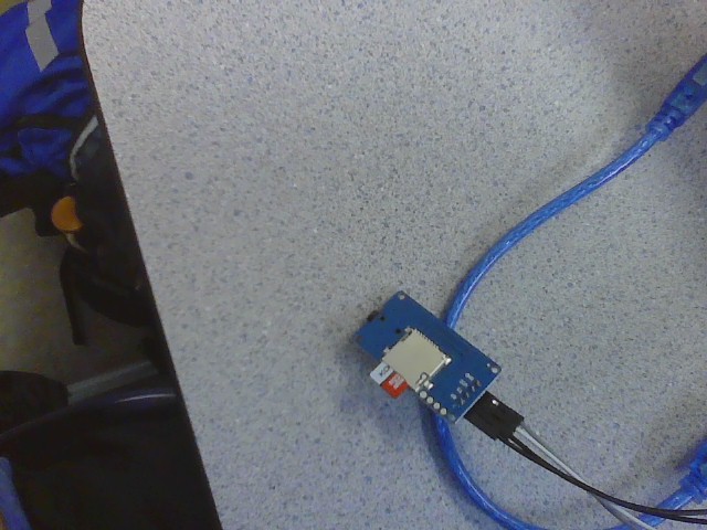

communication board
the communication board for school
the communication board for school
JPEG Image - 1.50 MB - 06/05/2023 at 17:12
Preview
JPEG Image - 1013.67 kB - 06/05/2023 at 17:12
Preview
JPEG Image - 395.65 kB - 06/05/2023 at 17:12
Preview
JPEG Image - 280.06 kB - 06/05/2023 at 17:12
Preview
PlayHelloWorld.ino
this is the working code for the buttons and mp.3 serial player it works
ino - 1.37 kB - 05/10/2023 at 17:16
Download
  • 1 × Arduino Uno this it the brain of everything
  • 1 × Serial mp3 Player this tells the speakers to play sound
  • 1 × Speakers as long as the speakers have a USB port they should be fine
  • 1 × Capacitive touch sensor this is what you wire the "buttons" to to connect to the arduino
  • 1 × Large plastic board you can engrave in this is the body
View all 7 components
  • week of 5/22
    Molendacc06/09/2023 at 18:16 0 comments
    Clark was working on a new code for the Arduino buttons, Kasey got new better sounding sounds, and Sean was getting new images into the prototype. Clark was working on the code because the old code could not process the number of files we had. The old code could only prosses 10 sounds instead of the 12 we needed. Kasey had to get new sounds because the old ones were very quiet and did not sound good. Sean got an email from the district on the proper images for the board so we had to replace the old images with the old ones
  • Week of 5/29
    sEan06/09/2023 at 17:49 0 comments
    We have finished moving the images onto Silhouette Studio and are now cutting the board. Polishing up the code to ensure the sounds are properly played. We also adjusted the volumes of the sounds so that they would all be equal in volume.
  • May 1-5
    Kasey G.06/09/2023 at 17:41 0 comments
    This week we worked on making the speakers play sound. The code did not work so next week we will troubleshoot. We almost have the design done and will finish it next week. Kasey was looking for sounds and Sean was on Onshape getting the 3d prototype done.
  • May 15-19
    Kasey G.06/09/2023 at 17:39 0 comments
    Clark has finished coding and needs the capacitive touch sensors to finish up.Sean finished the board prototype and it is ready to print. kasey has gotten all the sounds and put them on the SD Card.
  • the buttons make sound
    Molendacc05/10/2023 at 17:20 0 comments
    We finally got the buttons to make sound when we press them. We had to use the hex codes for the buttons and the files on the micro SD that was in the serial mp3 player. w coded it so that when you push the button it would read the hex code of the button and then play the respective file we wanted to play if that button was pushed.
  • April 23-28 progress
    sEan04/27/2023 at 17:51 0 comments
    This week we continued work on the design of the board and we received our speakers. We also started to code the Arduino to detect input and are now assigning each keypress to a separate sound. Hooking up the speakers to the Arduino and testing the sound, and learning to write in braille.
                                                                  speakers ^^
  • Last week's progress
    sEan04/25/2023 at 17:54 0 comments
    We got all the sounds, uploaded them into the micro SSD, and put it in the serial mp3 player.
    We were trying to find code for the serial mp3 player that we could put in and have work with some minor changes we had to make. that way we can code it so that when the button is pushed it plays the sound we have assigned to it.
    We also started on the design of the board on onshape, working on the design now.
  • difficulty
    Molendacc04/25/2023 at 17:28 0 comments
    i was trying to find code for the serial mp3 player that i could put in and have work with some minor changes i have to make. that way i can just code it so when the button is pushed it plays the sound i have assigned to it.
  • micro ssd in the serial mp3 player
    Molendacc04/25/2023 at 17:25 0 comments
  • sounds
    Molendacc04/25/2023 at 17:18 0 comments
    last week we got all the sounds and i uploaded them to the micro ssd and put it in the serial mp3 player.
View all 12 project logs
  • 1
    Instructions for building the communication board
    you first need to start by getting all the materials. After that take the Arduino and get all the code loaded onto it with the Arduino IDE application. Next, get all your sound files on the micro SD card in the serial mp3 player. After that wire it up and search for a tutorial on how to do that. Then engrave your board with what you want to have on it. While the board is engraving cut your aluminum sheet into squares or whatever shape you want your buttons to be. Then when you put the buttons on the board make sure the sharp edges are covered up or sanded down so you don't or anyone who uses it doesn't cut themselves. after that solder some wires to the back of the aluminum and attach it to the capacitive touch sensor. Wire it to the Arduino and then map the buttons in the code (use a youtube tutorial). then you should have a complete capacitive touch sensor.
View all instructions
