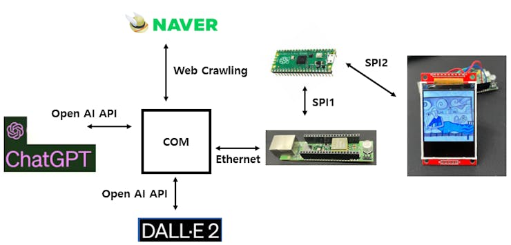

    Here's a simple flowchart! I only changed the LCD configuration from my previous project. I will bring some parts that I used in my previous project, such as web crawling and Chat GPT, albeit in a simplified manner.

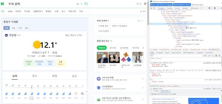

    <Screen that appears when searching for weather in the water on the Naver site>

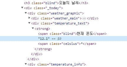

    Let me deal with Crawling briefly.

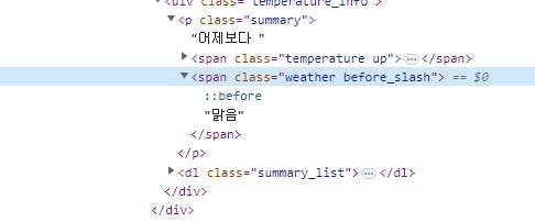

    In the script, temperature was read from temperature_text.
    And weather was read in the span class of weather before_slash.

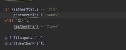

    I want to read it in English, but I couldn't find it, so I just hardcoded it...And when you run this, it will look like the following.
    It outputs temperature and weather like this.
