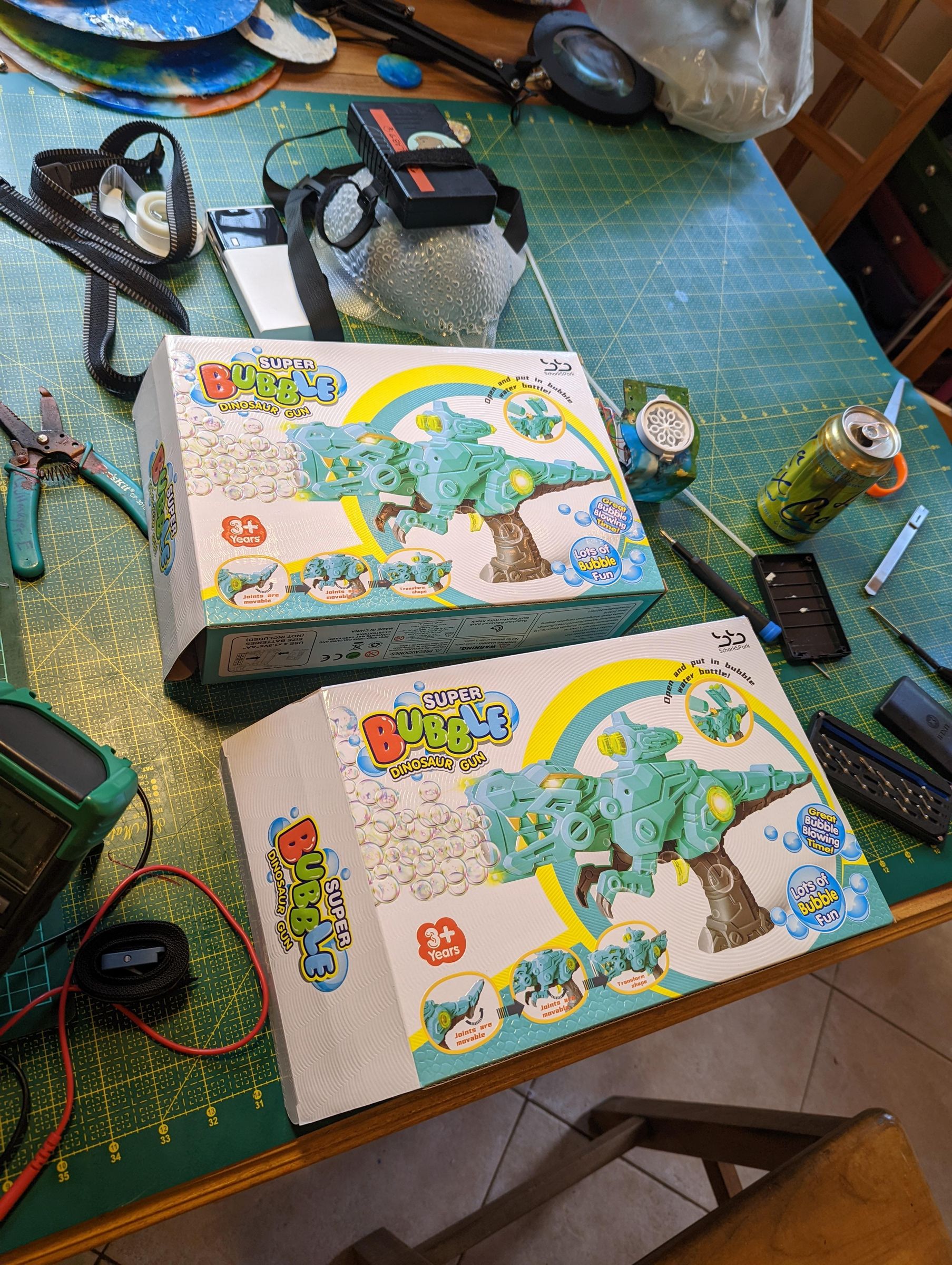

    Choose Your Bubble Blaster
    The best common bubble blaster i have found is the one generically labeled "Super Bubble Dinosaur Gun" that often sells for $9. They seem the most well made for the price ("Snow Princess" seems to have slightly better construction, BUT costs $20!). So i have built many designs around it. In general they all contain a main bubble module that you can follow the steps and attach a new battery pack and bubble tank to! I have also made designs for a 3 pack of bubble blasters you can get at Costco/pricesmart and the Snow Princess Bubble modules! More to come probably! If you find a bubble blaster you like, please contribute open designs to our github!
    If you want to nerd out about the subtle differences between different cheap kids' toys I created some VERY THOROUGH reviews of different bubble blasters on our youtube channel:
    https://www.youtube.com/watch?v=TpurBx8GYRQ&t=5s
    If anyone finds a way to purchase just the bubble modules (like off aliexpress or something), let me know!

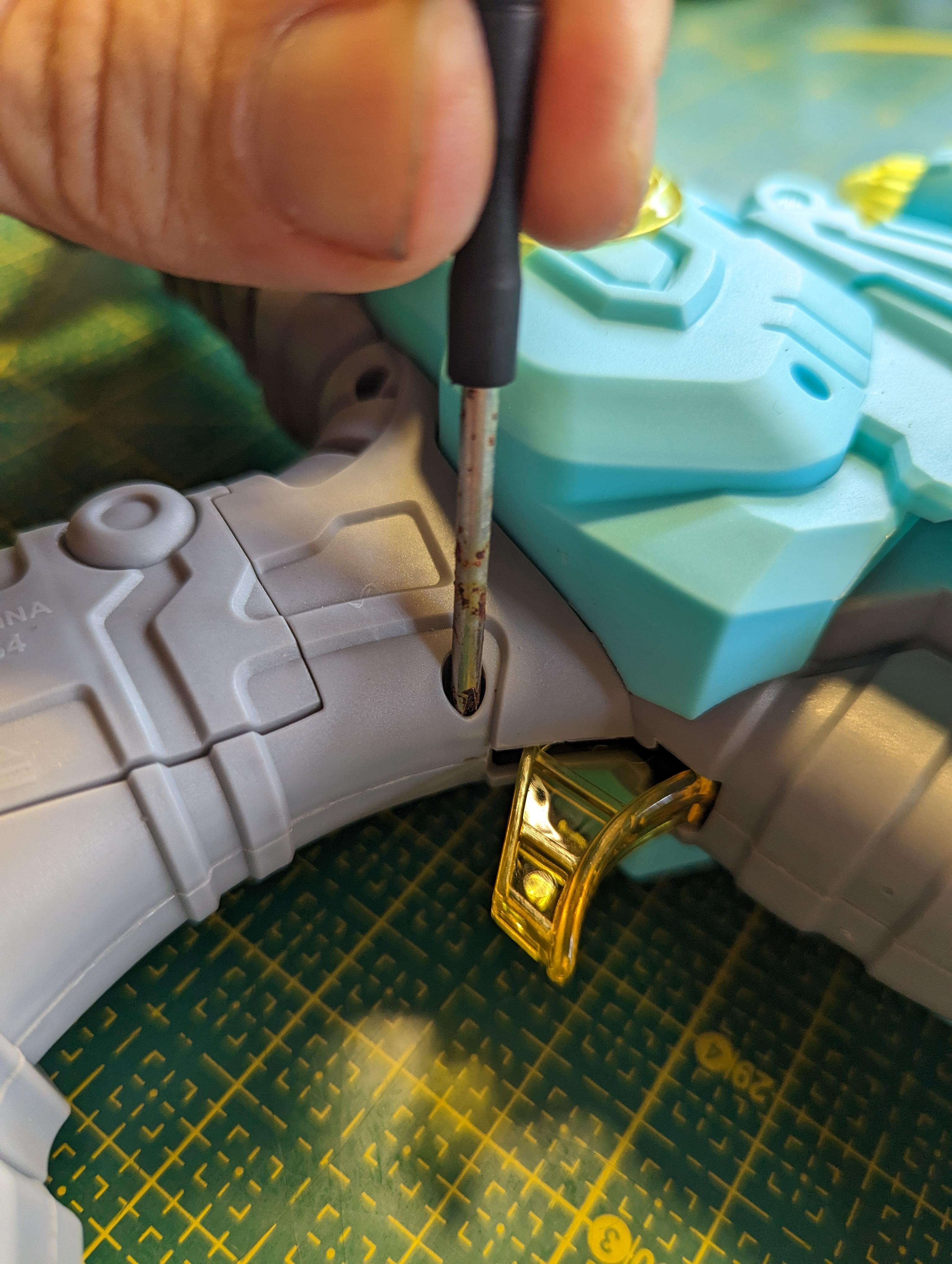

  • 2
    Disassemble
    With many of the bubble blasters, disassembly is really easy! You just unscrew all the screws you see and the toy comes apart in two!
    The Dinosaur bubbler even comes with a tiny screwdriver to open the battery compartment, but all the screws can be taken out with it!
