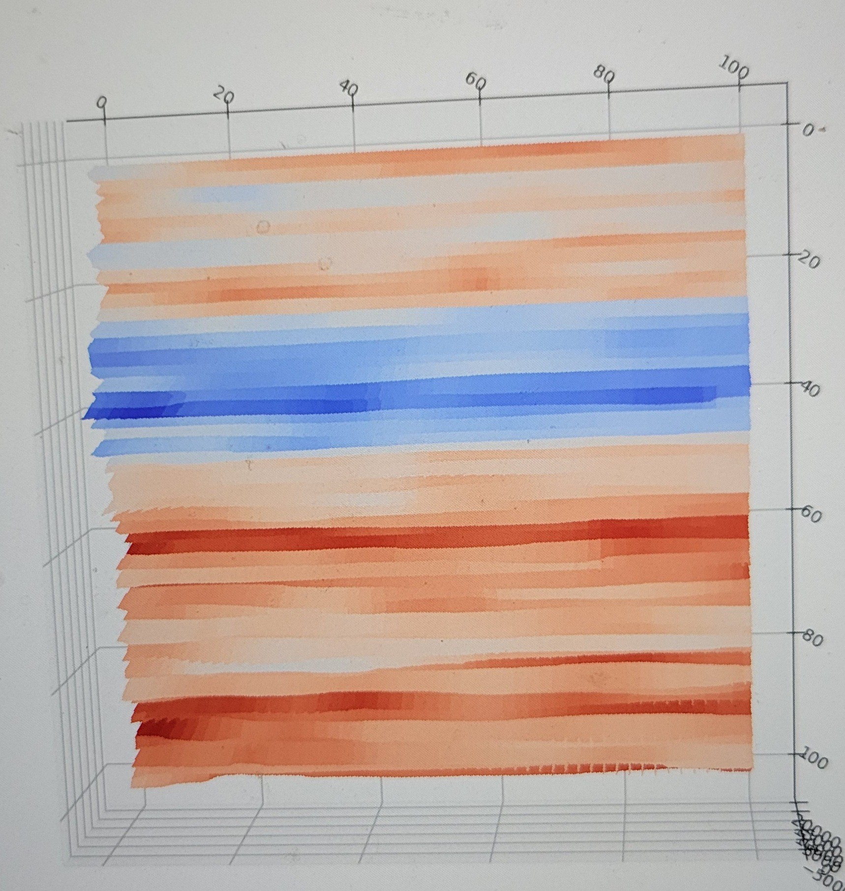

Now I made separate python file for STM controller, so I can make images in simple way. Here is what I got from my first run:
I see clusters so this is a good sign. (The white stripes are places tip couldn't reach sample anymore since it's not aligned well with tips's motion plane, I had to move micropostioner to re-align)
Another problem is that surface is not always align with tip movement. I've realized that the problem is that my mechanical system contains only three degrees of freedom XYZ. I need 5 degrees of freedom XYZ plus  Roll and Pitch.
Another interesting observation is that now there's changes in height of one samples. In AFM changes were always of few samples.

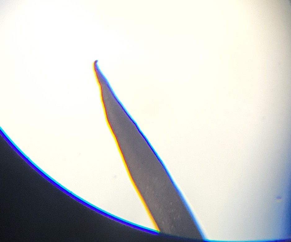

It took me a while to find a way to connect Tungsten wire to copper (it doesn't like soldering) in simple way.
Now let's try it! Finger crossed 🤞
Running with etched Tungsten wire I got surface that shows waves (the pits of the CD-ROM):
But the image was not clear, looking on the Tungsten wire shows that it was smashed to the surface:
Now, I wonder if 'approach' method is too fast or scanning.
