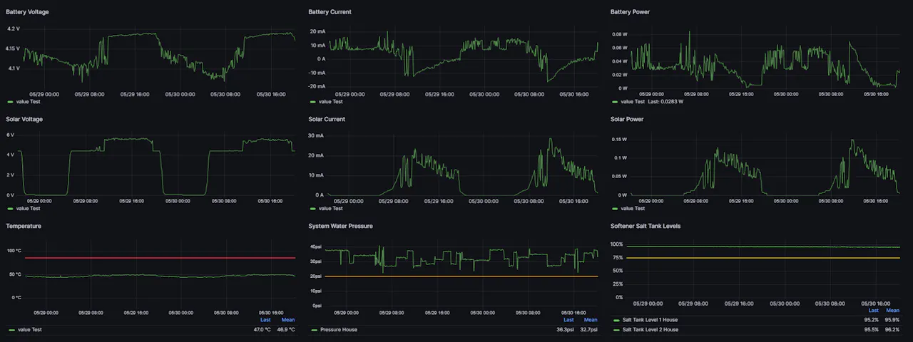

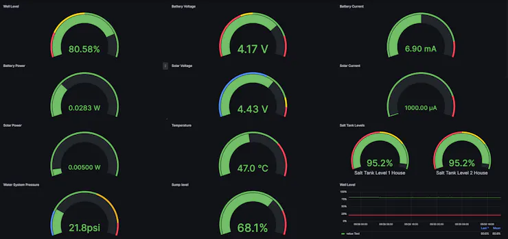

The purpose of this project was to monitor a well water level 100' away from the house in the back yard with no available power supply. The project was orignally done with a Raspberry Pi Pico W but decided to go with a ESP32-Wroom-32U for the external antenna.

The ESP32 collect the sensor data and sends the data to InfluxDB and then imported to Grafana for trending and visulization over Wifi. InfluxDB Cloud & Grafana in this project are free and allow for 30days of historical data. You would need to setup accounts and obtain your InfluxDB token and create your dashboard. I will not go over this process in this built as a simple google search can give you some examples how to setup the accounts and just replace "<Your Token here>", "<Your bucket here>" & "<Your Organization>" in the provided code to publish the data to InluxDB.
