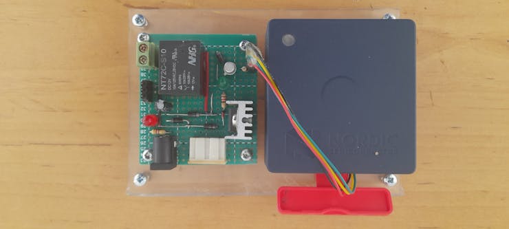

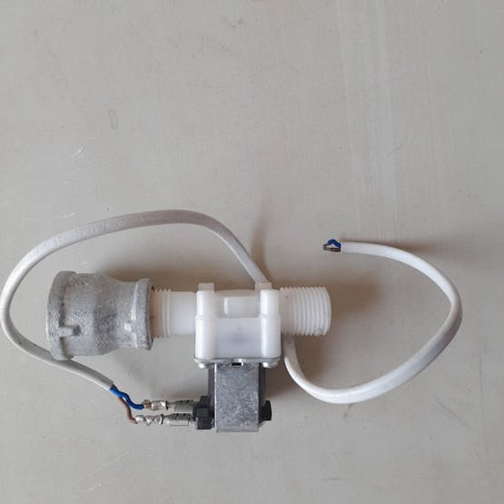

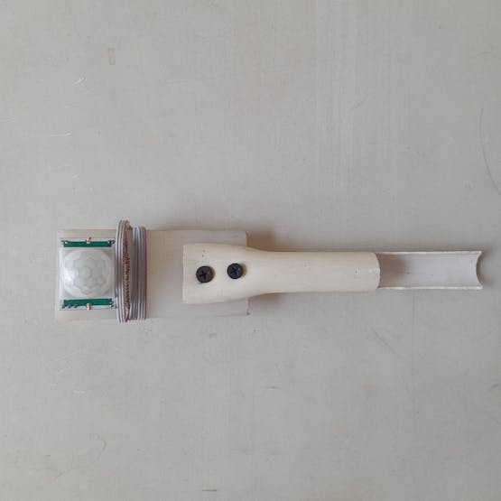

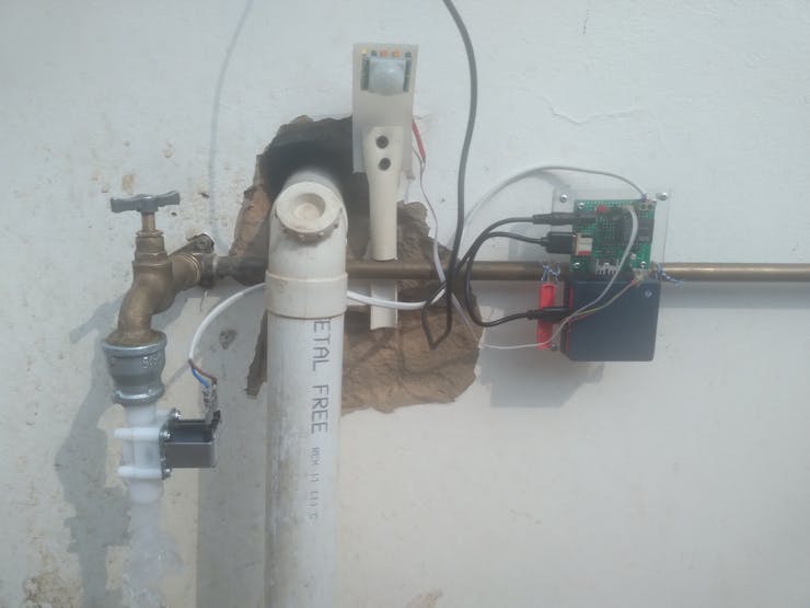

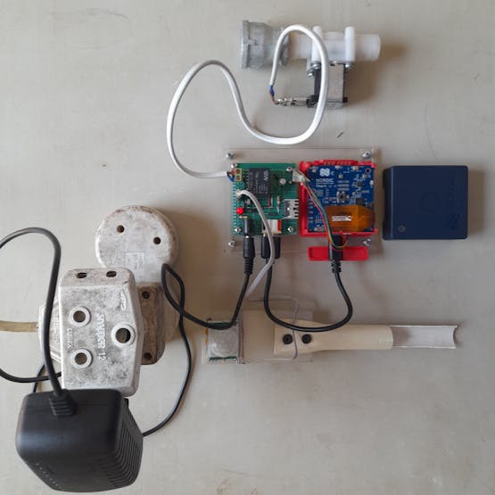

The demo video above shows how the final installation of the Smart Water Tap Leakage Controller IoT project works. The person in the video is a 30-year-old farm trainee fetching water after his launch. When he leaves the water tap open and walks away, it automatically closes the 12V water flow selenoid valve and saves water. When he comes back to the tap to fetch another cup of water, it automatically opens when the PIR motion detector sensor detects his motion near the water tap. This motion detector sensor can detect motion at an angle of 120 degrees, which I didn't want. I covered the bottom part of the sensor in order to reduce the angle so that it does not detect the motion of people passing by.

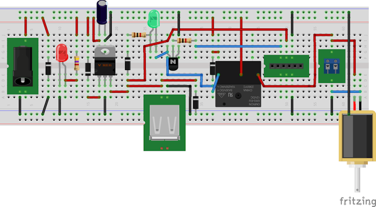

Figure 1

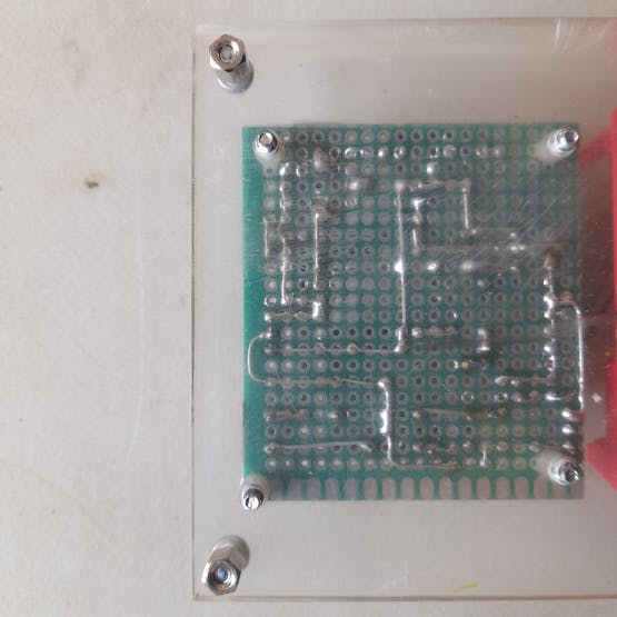

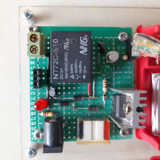

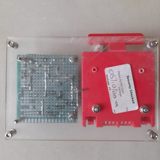

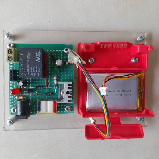

The image above (Figure 1.) shows the Fritzing Breadboard with components that I have used to build a circuit that detects the motion of people near the water tap and switches ON and OFF the 12V water flow valve. I used an 80K0960 general-purpose switching transistor to control the 12V relay. The ON and OFF states of the relay are indicated by a 5mm LED connected to the Collector of the Bipolar Junction Transistor (80K0960).
