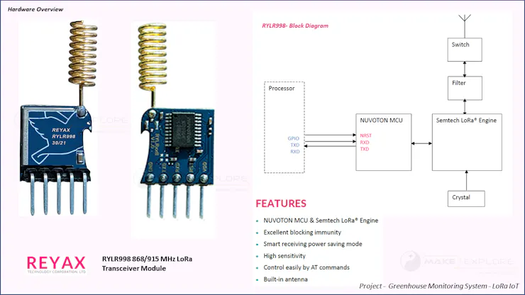

Hardware overview -
Getting started with RYLR998 module. This module is a UART Interface enabled 868/915 MHz LoRa, with Antenna Transceiver module. You can know more about this module and download the datasheets from its Product Page.
