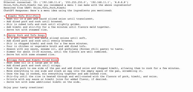

Chat GPT Recipe
Utilizing UART communication, we communicated from the Raspberry Pi 4 to the Raspberry Pi Pico and assigned the class values from the object expression to the pico.
#GPT prompt
while True:        if uart.any():            data = uart.readline().decode("utf-8").strip()  # Read data and decode to string            prompt = f"{data} Can you recommend a menu I can make with the above ingredients? "            print(prompt)            response = send_prompt_to_chatGPT(prompt)            print(f"Received from UART: {data}")            print(f"ChatGPT Response: {response}")        utime.sleep(0.1)
Get the api key value from the Open AI homepage, assign it, and ask GPT a question by plugging in a data list before the prompt "Can you recommend a menu I can make with the above ingredients query".
Result
As shown above, GPT will make menu suggestions with simple recipes.

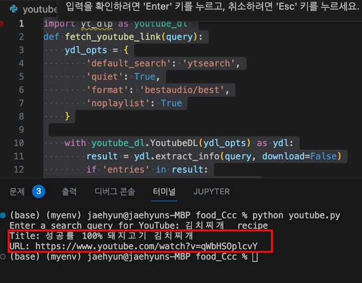

YouTube Crawling
We'll use the menu above to crawl and search YouTube to collect links.
(I'm Korean, so I'll do the preprocessing accordingly. You can do the preprocessing according to your own language.)
Regular Expressions
The menu suggested by the prompt was in an ambiguous position to crawl, so I asked it to print it out with * in front and back. The crawl will utilize a regular expression to extract data like *{data}*.
I wanted to crawl on the Raspberry Pi Pico, but the library could not be installed due to capacity issues, so I used the two-way communication back to the Raspberry Pi to crawl.😂
Crawling Code
!pip install youtube_dl
import yt_dlp as youtube_dl
def fetch_youtube_link(query):    ydl_opts = {        'default_search': 'ytsearch',        'quiet': True,        'format': 'bestaudio/best',        'noplaylist': True    }
    with youtube_dl.YoutubeDL(ydl_opts) as ydl:        result = ydl.extract_info(query, download=False)        if 'entries' in result:            video = result['entries'][0]        else:            video = result        video_url = f"https://www.youtube.com/watch?v={video['id']}"    return video_url, video['title']
if __name__ == "__main__":    query = input("Enter a search query for YouTube: ") # user query    url, title = fetch_youtube_link(query)    print(f"Title: {title}")    print(f"URL: {url}")
Result
This is what the crawl looks like to get the titles and headings I want First, I validated the code on my PC.
