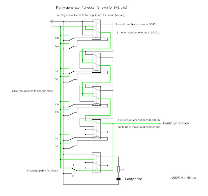

Parity generation/check
Simple parity generator/checker, using 1 relay per 2 bits, plus 1 for the check.
Propagation time 1 T. Simulation file for circuitjs provided.

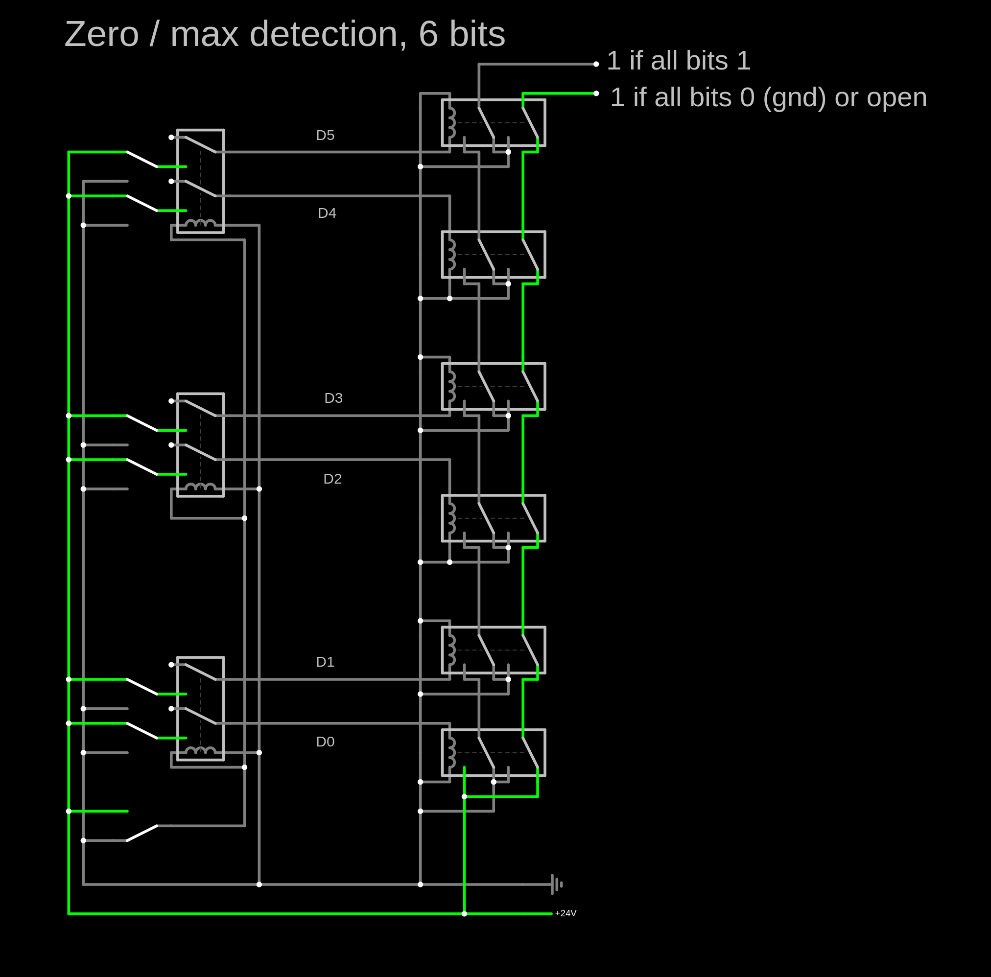

Zero and maximum detector
This circuits uses one DPDT relay per bit to detect both an all-zero and and all-one value.

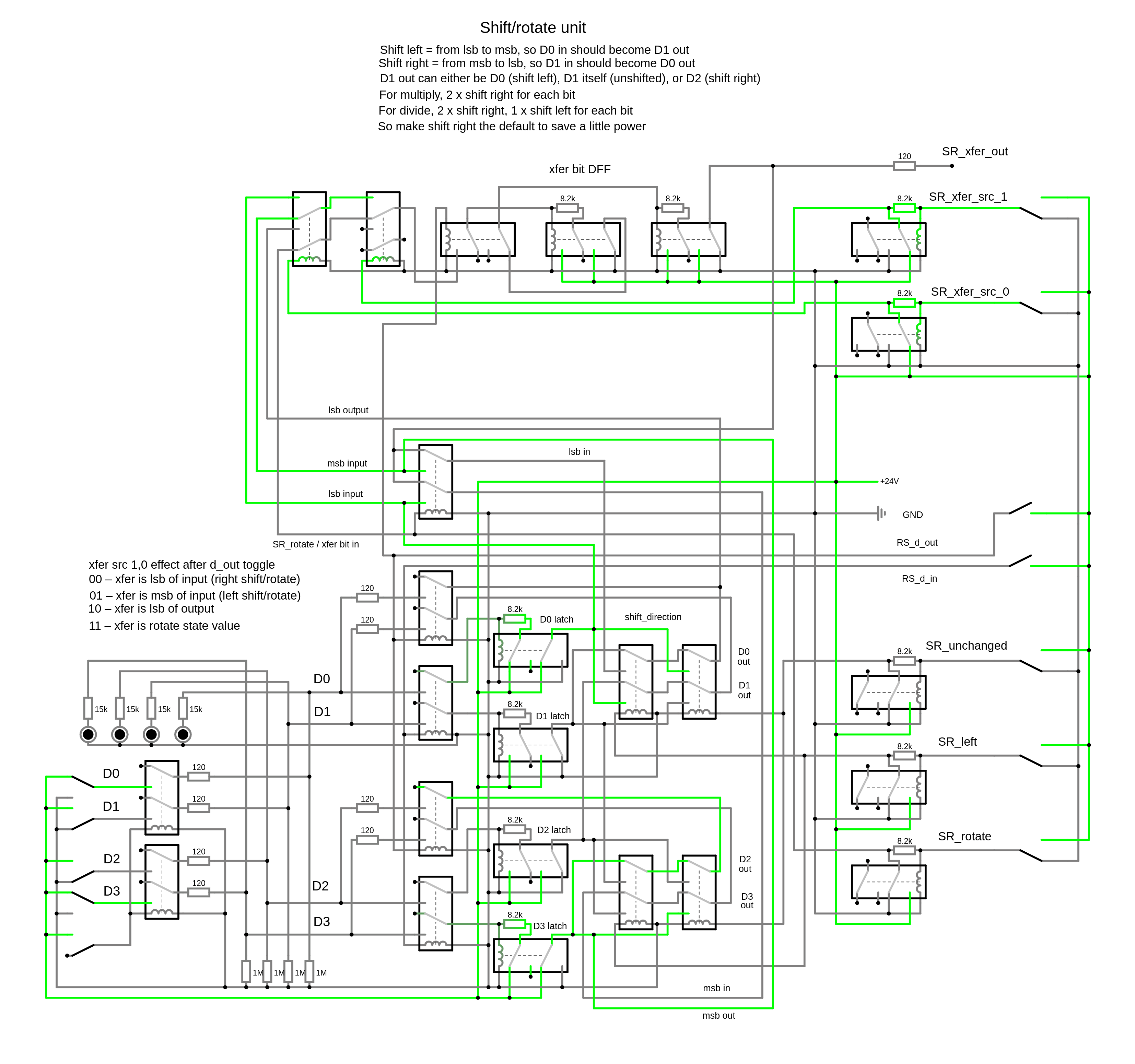

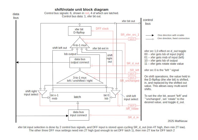

Shift /rotate unit
This 4 bit shift/rotate unit can do single- and multi word shifts, rotate, and also be used as scratch register. The input is loaded from a data bus and not changed, the output is selected bits from the input. The shift-in value comes from an internal D-flipflop, which can be set to 0 or 1 as desired, and normally gets set to the shifted-out bit at the end of an operation. For multi word right shifts, set the internal xfer bit, then shift the most significant word, then the least significant. For left, do the least significant first, then the most significant. For use as scratch register, the output is be the unchanged input.
Relays: 10 + 6 per 2 bits , DPDT only. Propagation time: 6T for load + retrieve changed value.
Control signals are shown with a latch, it is quicker without a latch but a latch saves relays in the control circuits (signals do not have to be kept active).
Relays are shown as 24V/2880 ohm, but can be any. For the latches and flipflop, see earlier latch description.
Note that signal d_out drives 1 + bits/2 relays, d_in drives bits/2 relays.
Signals driving the data bus have a self-resettable 100 mA fuse in series to limit current in case of logic failure (when one relay drives a signal line to GND, while another drives it to 24V). The schematic shows 120 ohm resistors, but that should be fuses.
A circuitjs simulation file is provided.

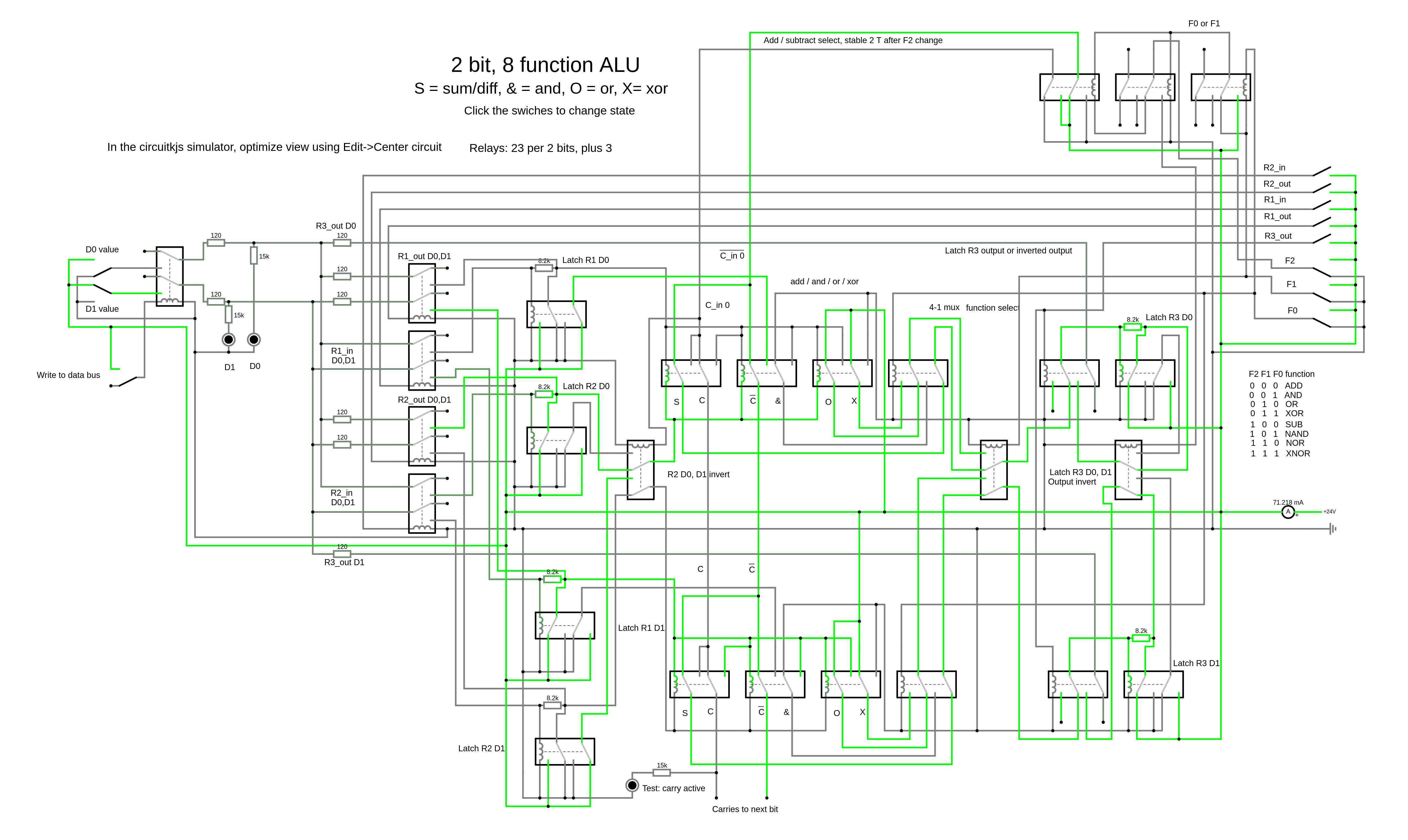

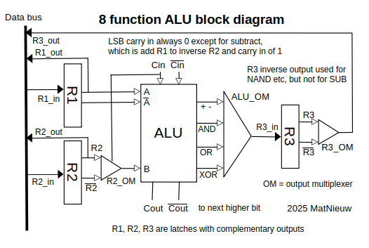

8 function ALU
This 8 function ALU, here 2 bits, does ADD/SUB, AND/NAND, OR/NOR and XOR/XNOR in hardware. It has two input registers, R1 and R2, which can read from, and write to a data bus.
The central adder/logic part is an extension of J. Allen's clever adder, simply by having 3 relays in parallel, which give 4 functions, one of which is selected for the output. Subtract is always R1 - R2, where R2's output is inverted (one complement), and the carry of the least significant bit set to 1 (normally always 0). An internal register R3 is set to the result of R1 and R2 two relay settle times after the last R1 or R2 change. This register can write to the data bus too, its input is then disconnected and its output connected to the data bus. This way an operation like (R1 operation R2) to R1 is easily done without having to use intermediate storage.
Three function bits F0-F2 select the operation (see diagram below), where F2 enables the "negative" version of an operation, ADD becomes SUB, OR becomes NOR etc. Except for SUB, the inverse of the R3 value is used in the case (the latches have both normal and complimentary output).
It can be easily extended to any number of bits, connection the two carry outs from the previous 2 bits to the carry ins from the next higher two bits. Propagation time is always the same, even if you have 32 bits.
It uses 23 relays per 2 bits, plus 3, and uses 8 control signals. In spite of the number of relays, it is reasonable fast (for a relay ALU): an operation like 1) load R1 and select ALU function, 2) load R2, 3) wait for R3 to have the result and 4) write R3 to R1 can be done in 11 relay settle times.
You can load the circuit simulation in circuitjs (see Tools section), and play with the switches: use the left relay and switches to set write a data value to the data bus, then R1_in to put it into R1, do similar for R2, disable the left relay and use R3_out to se the result appear on the data bus. Use the F0-F2 functions to select the operation.

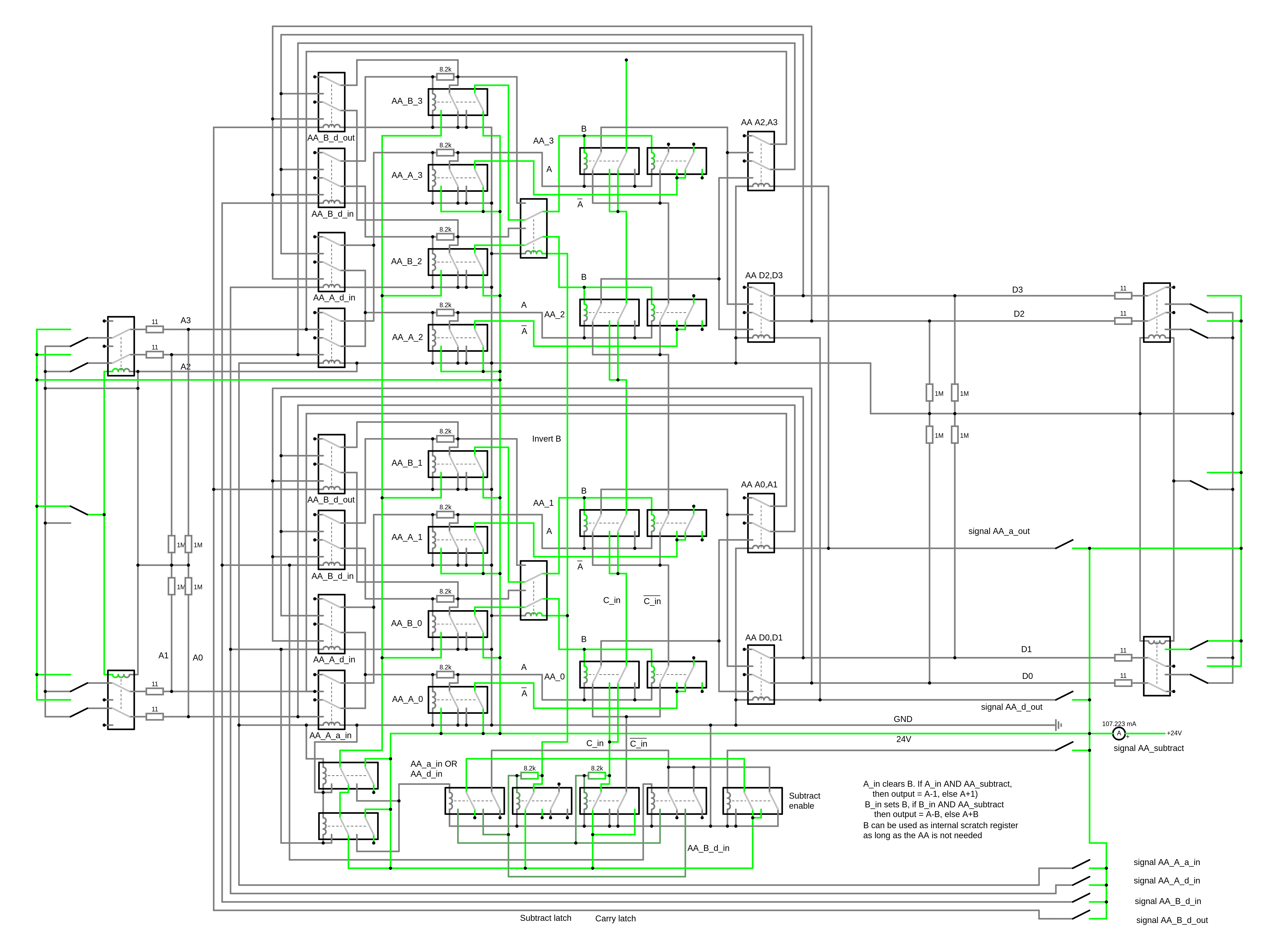

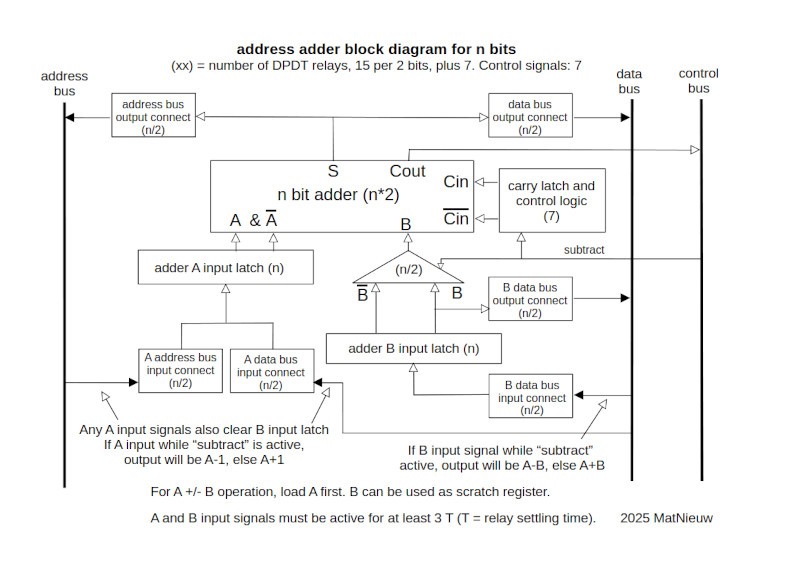

Address adder
The address adder (AA) is a simple fast adder (based on J.Allen's fast adder), with 4 functions.
It saves relays if there are both a program counter and refresh counter (each of which would normally required their own incrementer), and the address bus is more than 8 bits wide, plus it allows computed addresses. It can also act as incrementer/decrementer outside the ALU.
It is intended to be connected to both an address bus and and equally wide data bus (e.g. 8 bits). It has two input registers, A (input from both address and data bus, no output), and B (input and output to data bus). There is no output register, the output can go to either address or data bus.
It has 4 functions:
a) A+1, the default if A is loaded, useful for incrementing a program counter, refresh counter, or stack pointer.
b) A-1, if A is loaded while the subtract signal is active, useful for decrementing a stack pointer.
c) A+B, if B is loaded
d) A-B, if B is loaded and the subtract signal is active.
The load signals need to be active for at least 3 T.
If the AA is not used, its B register can be used as a scratch register by the control logic.
The AA carry-out is exposed, with an ALU that allows external carry-in double word add/subtract can be done without using memory for intermediate storage.
A typical usage scenario during instruction fetch might be:
1. Connect PC out, AA A in, and memory address latch to the address bus.
2. After 3 T, disconnect PC out, AA A in, and memory address latch.
Connect PC in and AA output to address bus, after 2 T disconnect both.
3. PC has update address.
At the same time, the memory content can go over the data bus.
This AA requires 15 DPDT relays per 2 bits, plus 7.
