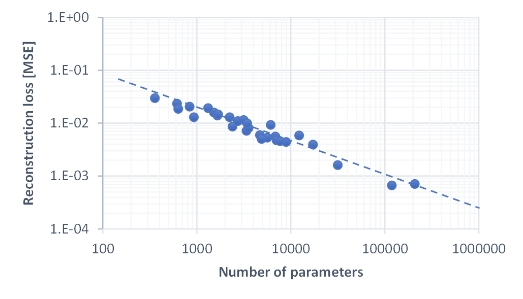

Lets have a look how these parameters relate to network size:
The figure above shows a log-log plot of number of parameters vs. reconstruction loss for all test runs. We can see that they roughly follow a line with a slope of -2/3, regardless of chosen network structure. This is quite fascinating and basically indicates that any added parameter improves the image quality and the image quality is inversely proportional to the number of parameters. There are diminishing returns, of course.
Looking closer (this is a lin-lin plot, zooming into the smaller models) we can see that there is a (weak) impact of parameter distribution. Increasing the size of dim4, which influences both the fc layer size and the number of channels in the 4x4 convolutional layer, leads to improvements that are slightly worse than the trend. In general, it appeared to be less beneficial to increase the number of channels by a large factor from one layer to another. Weights are more efficiently used, if each layer has a a similar number of channels.
