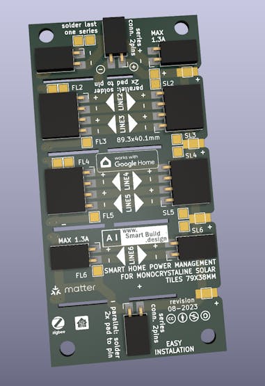

Prototyping a support for a Polycrystalline 78x39mm Solar Cell
Polycrystalline solar cells are known to break too easily when handing and assembling all together when building a solar panel.
To protect this kind of solar cells I've designed and order fabrication a support hardware electronics where any solar cell can be soldered , in particular the ones below i used for this testing.
This is a simple PCB for a direct fit on commercially available blue solar cell tiles with dimensions 78x39mm. This support hardware PCB is intended to be connected to the distributed Indoors power storage and installed at the ttop side or at the bottom side of transparent glass windows at a home or office. This PCB, when assembled with a blue solar cell tile, can be used to power a low voltage 4.2V indoor illumination network using ultra-low power micro LED strips. For instance, this one sold on AliExpress.
When connected in series and installed on several windows and networked, can power off the grid 4.2V DC LED lights on all rooms and compartments at a home or office. During evenings and at night until bedtime. If one intends to use it to power indoors LED illumination during the day is required a High Capacity Power Bank connected to all first tiles of all the series. For instance this power bank here. One important takeaway about this prototype project is the ability to be installed on any traditional apartment or home in a big city.
Support PCB for the solar cell
On the photo below is possible to see one solar cell placed in one of my apartment's windows for evaluation of aesthetics and total area required for an installation directly placed on the window. This one in particular requires 124mm of window glass estate, at the top or at the bottom and has an height of 80mm. This setup and installation is able to connect to existing home automation networks or systems (see my next iteration of this project to learn more).
solar cell comparison with a window size
Below is possible to see solar cell array assembled in series to output 4.5V DC and 1.3A and installed (taped) at the bottom of window. The solar cell support PCB works really well on protecting the fragile solar cell from breaking when handing and installing. Defiantly a must have when thinking on fabricating and assembly these kind of fragile solar cells.
