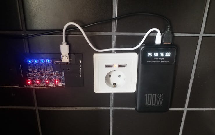

2nd Iteration of the "power wall" installation
The 2nd iteration of the "power wall" was intended to replace all the 18650 LiPo batteries with a regular 20,000mA fast charge power bank. I assembled in parallel 4 step up converters to boost DC power from the solar panels to a stable 5V DC. and connected it directly to the power bank using a USB A to micro USB cable (see photo below)
However to my surprise the power bank was not charging , or charging so slowly it was impossible to notice it. The other challenge was when powering the illumination LED light at night., as I come to understand, the power bank was not "detecting" the LED lights and thus not providing any power output,
C,ose up of the 2nd iteration of the "power wall"

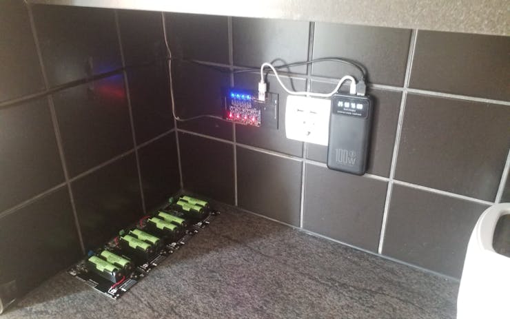

While I was searching and reading on the internet about this, i decided to add the LiPo batteries I had from the previous setup
2nd iteration of the "power wall" with a total of 44,000mA of storage
