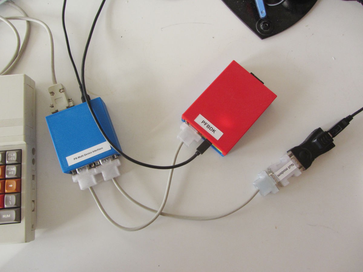

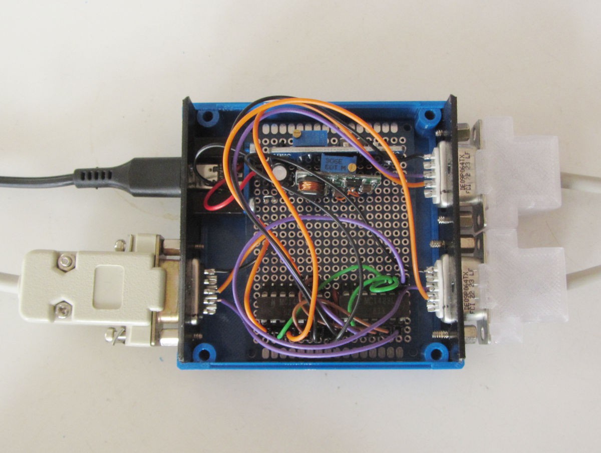

The SD-card management functionality is available from the PFBDK debug port (Arduino console or programming interface) and via custom EPSP-functions from the PX-4 (using native CP/M programs).
The management functions are (named by program):
- PFDIR4 - List a directory of the SD-card root directory
- PFMNT4 - Mount image files on the disk drives C:, D:, F:, G:)
- PFWP4 - Set/reset a drive Write protect flag
- PFNEW4 - Create a new, empty disk image.
The project is ongoing. Several items are on the ToDo list:
- Support for PX-8 SD-card management,

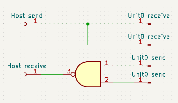

- Awareness for multiple slave devices; PFBDK now assumes to be the only device on the 'RS-232c bus', it should respond only to the addressed devices (one or two floppy terminals),
- The board should support a chain function, allowing multiple options on the 'RS-232c bus'.
Power is supplied from a computer (allowing debug logging via the serial port) or an USB charger/power bank. There is no battery charge or management on the PCB.
A planned new version of the PCB should include support for a proper CP/M NET RS232c bus. This means an extra chained RS-232c port.
