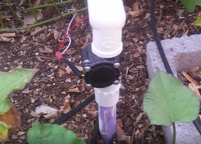

- We wanted to run our garden with no grid power so that it could manage itself indefinitely (even when the power goes out).
- We wanted to be able to water the garden either using a timer or by pushing a button.
- We wanted a raised bed since this garden was going to be in a desert with terrible 'soil'.
- Voltage regulator stepping down the 12v power from solar charged battery to 5V for the Pi. Battery is in the shed and panels are on the roof.
- RPi camera. Used for capturing time lapses and making sure everything is green when we are away.
- Raspberry Pi A,B,B+,2 and 3 should all work just fine here.
- Thermometer that uses the OneWire bus. It is hanging outside of the enclosure in this picture to get a more accurate temp.
- Motion detection that uses a regular GPIO pin. As a side note: some plastic (such as this particular box) is opaque to IR. That is why the sensor is hanging out.
- Simple board that wires two GPIO pins to the relays, first going through a darlinton array which both amplifies the weak GPIO signal and also provides some induction backlash for free (super important if you value your Pis!).
