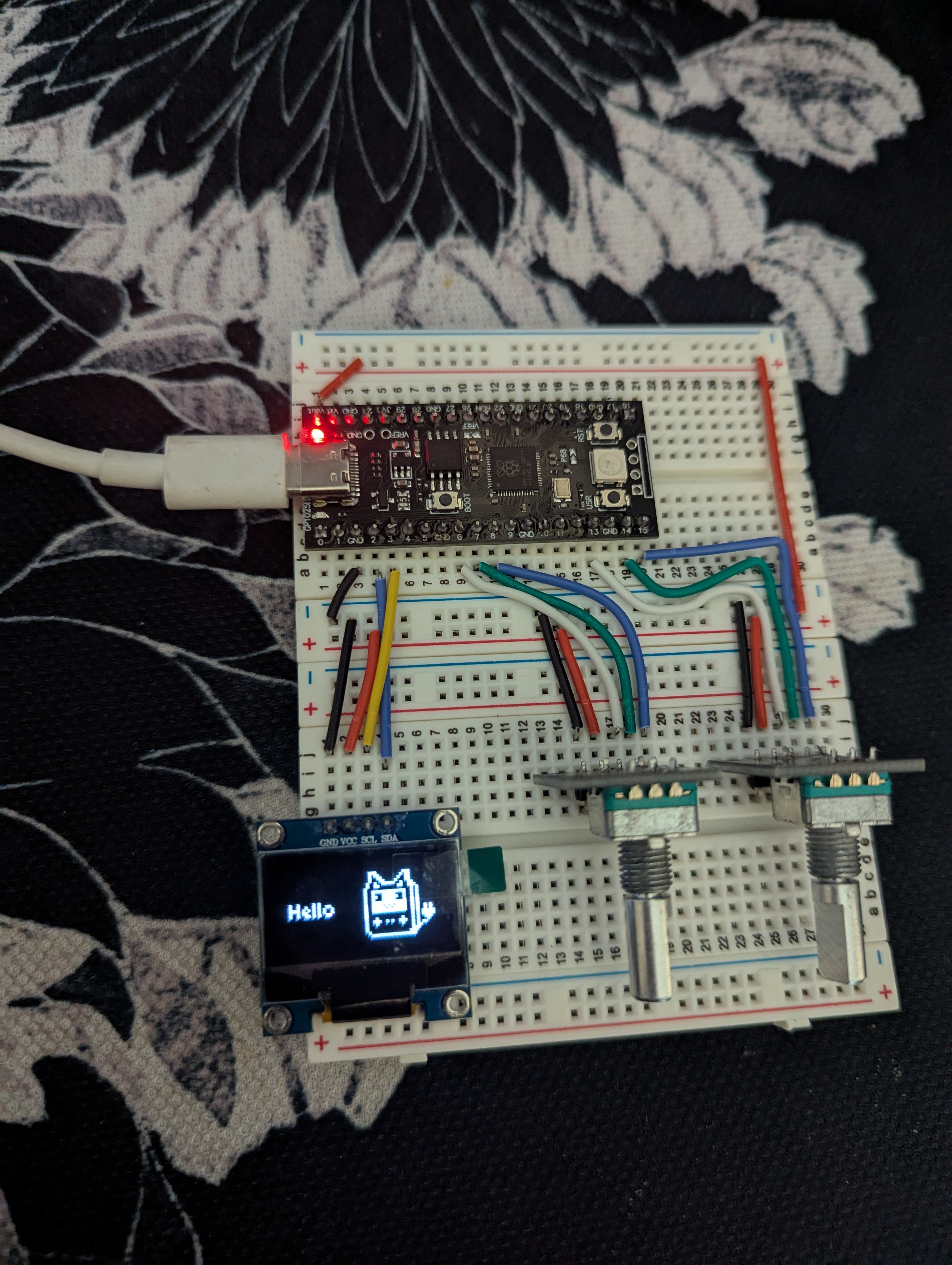

I have decided to switch to CircuitPython for creating the device firmware. I initially wanted to use QMK since I had spent a few days learning it to configure the Adafruit Macropad. However, I figured that most of the loafdeck (name WIP) functions won't be keycodes so there isn't a pressing reason for me to use QMK. One QoL improvement is the ability to import local .bmp images directly into bitmap objects, rather than needing to export, convert to byte array, and paste into firmware. This can be done either through the displayio or adafruit_imageload libraries.  I've begun trying to teach myself how to make 1-bit pixel art and uploading iterations of the screen art work will be more streamlined now.
I am using the Adafruit_displayio_ssd1306 library to display images and text. The displayio.TileGrid class is helpful for using sprite sheets, which will reduce the number of image files needed to be uploaded. A sprite sheet of arbitrary size can be uploaded as a "grid," and each grid can be split into "tiles" for easily calling the image you want. As a simple test, I went in GIMP to create an image with twice the height of my oled dimensions, 128x128 in this case. The top 128x64 of the image is one screen state, and the bottom half is a second screen state. I import the bitmap as a 1x2 tile grid, with each tile being the size of the screen. In circuit python, you can easily switch between which tile is being shown on the display. This is a very rudimentary test as grids and tiles can be any size and located anywhere on the screen.
Another good feature of displayio are the palette and pixel_map features, specifically being able to designate specific colors as transparent. This was useful for me as I was trying to create sprites for the left hand and right hand of the screen separately. The sprites I was using took up the whole screen, so the sprites would draw over each other rather than showing something on both halves of the screen. Setting black to transparent allows for this to work, although I may look into having smaller tiles instead.
Serial communication is handled by the usb_cdc library. The rp2040 actually has 2 serial ports available, with one disabled by default. The normally used serial port, identified as usb_cdc.console, is typically used for the REPL. This port would be usable for two way communications, but data can be interrupted and only one program can access the port at a time. I am experimenting with the usb_cdc.data port which is normally disabled, so is unaffected by the REPL data stream. I have gotten the device to output a message to serial if the first encoder is turned one direction. I used PuTTY to confirm the device was sending serial data that could be read.
I am very inexperienced with circuitpython and python in general, but I have attached my test code for reference. I pieced it together by taking from the few examples available and trying to decipher the documentation. I figure for someone with as little knowledge about (circuit)Python as I had 24 hours ago (no knowledge), this example could be helpful for starting projects that require two-way communication and updating a display accordingly.

NOTE: For usb_cdc to work, you will need to add a boot.py file to your device. Mine contains the following:
import usb_cdc
usb_cdc.enable(console=True, data=True)
 by default, console is enabled and data is disabled. I was told to NOT disable both interfaces.

New test setup, with RP2040 board
