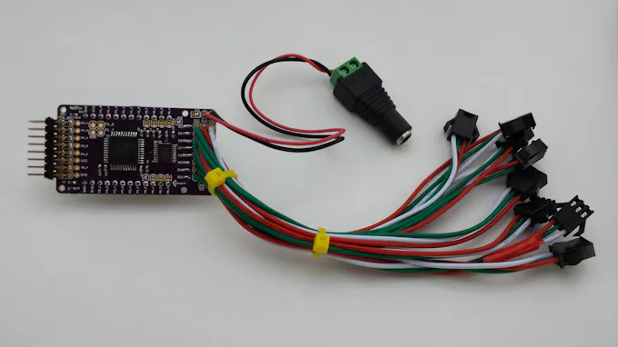

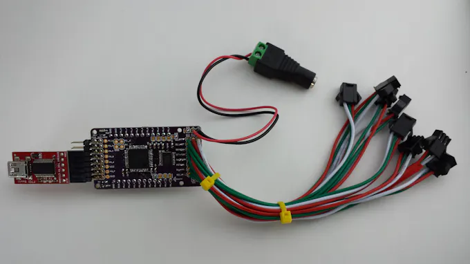

TSOC_NEOLED Driver Board
The TSOC_NEOLED driver board incorporates a Cypress PSoC4 device with a 74HCT245 driver chip to support longer wires for your LED arrays. The same firmware project can be loaded in any Cypress CY8CKIT-049 prototyping board as well.
The TSOC_NEOLED driver board can either be used as standalone LED driver, in conjunction with other thingSoC, or Mikrobus boards. It can also be used with Arduino, Raspberry Pi, Beaglebone, and other platforms as an I2C peripheral.
The TSOC_NEOLED looks to the Arduino like an I2C SRAM (memory) of 2048 bytes in size. Simply writing to the TSOC_NEOLED like an I2C memory causes the corresponding LED to light up on the display.
