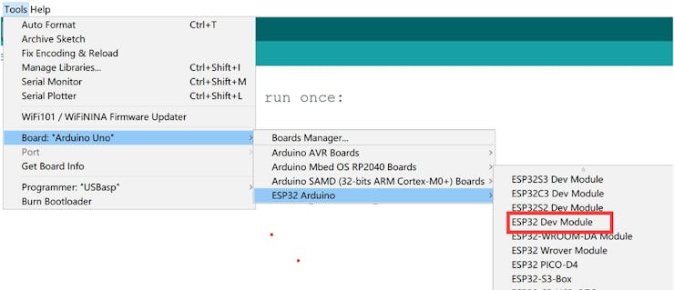

- At first, we need to prepare the environment for ESP32 development board programming in arduino, and you can cheak this guide.
- secondly,Install the libraries and files which will be used
