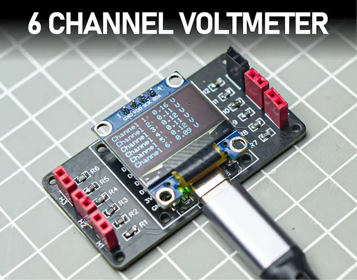

In this project, we are making a 6-channel voltmeter that has 6 voltage dividers and an OLED screen that will show the reading from the different voltage channels . All of this is controlled by Seeed Studio XIAO SAMD21

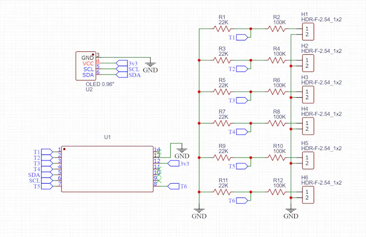

Step 1 : How i measured the voltage using xiao
Actually xiao only can measure the voltage up to 3.3v more than that will damage the mcu , so we need to use a voltage divider for that. As the name suggests, a voltage divider will help us to divide higher voltage into smaller voltage which can be measured using Xiao.We are using 100k and 22k resistors to build our voltage divider with this we can measure up to 0v to 18v. More than this limit will fry your mcu.

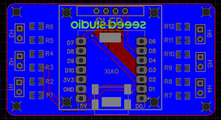

Step 2 : Schematics and pcb design
So we just need 6 voltage divider and 6 output of the is connected to GPIOs of the xiao. I designed the circuit and pcb EasyEDA then i exported the gerber file from it

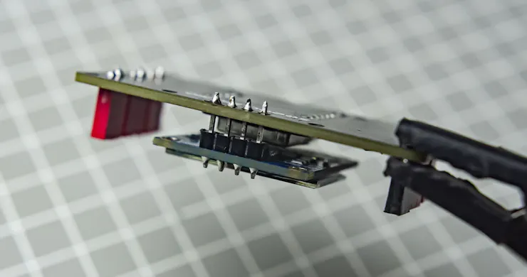

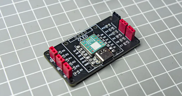

Step 4 : Assembly
Pcb assembly was straightforward. I just used my soldering iron to solder all the components. It was easy to solder the wire terminals, xiao, and OLED.
