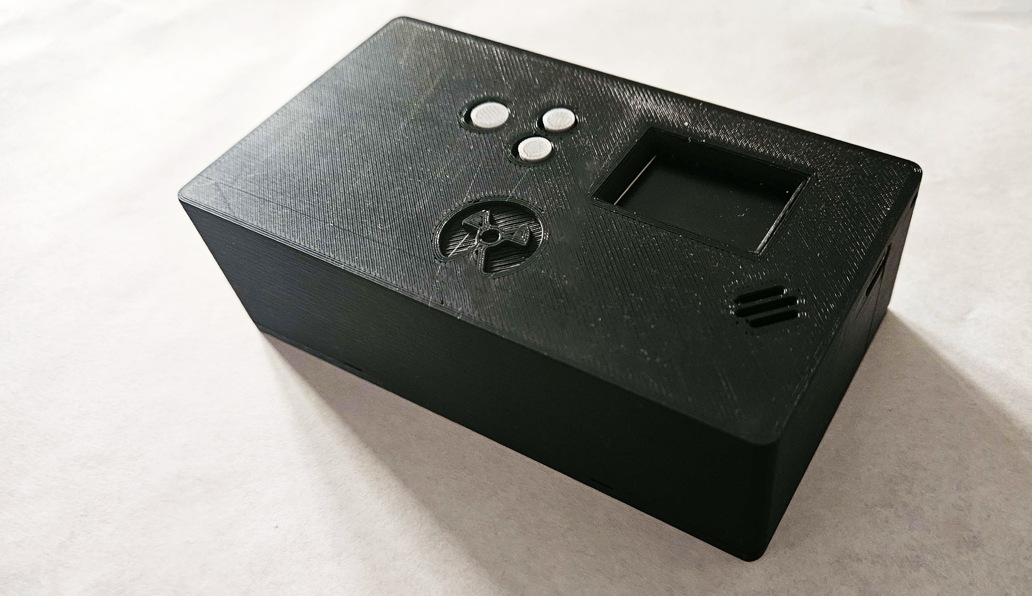

Introducing OpenRad, a simple radiation monitoring solution powered by the SBM-20 GM tube and TTGO ESP32 microcontroller. this project offers a user-friendly approach to tracking and measuring radiation levels.
Intro
With OpenRad, you can build your own dosimeter without complexity. The SBM-20 GM tube detects ionizing radiation while the TTGO ESP32 gathers and transmits data to its built-in website.
Additionally, MQTT helps with seamless communication between the device and any other device. allowing for easy integration with other systems and applications.
The code and design files are all available at the GitHub Repository.

PCB Design:
  • Single-Layer Layout for Ease of Manufacturing:
    • OpenRad's PCB design adopts a single-layer layout for ease of manufacturing, simplifying the production process and making it accessible for hobbyists and enthusiasts alike.
  • Compact by Design:
    • OpenRad's PCB is designed to be small and easy to handle, with components arranged to save space. This makes the device handy and practical...
