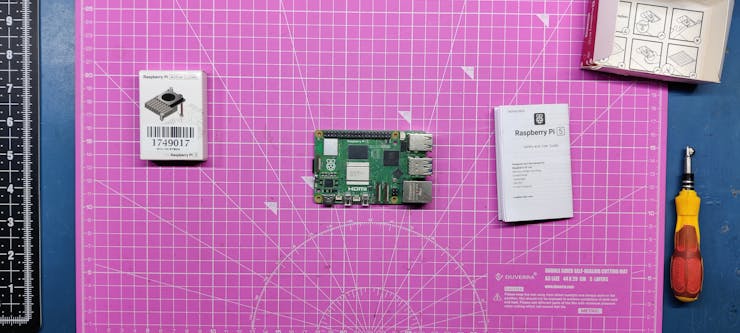

Raspberry Pi 5- Heart of this project
We opted for a little overkill approach for this project, purchasing both the latest 4GB Raspberry Pi 5 and the Original Cooler unit.
We got the Raspberry Pi 5 from Seeed Studio Market.
Regarding the Pi, this emulator project could have been carried out with a Pi4 or a Pi3, but the problem was that neither Pi4 nor Pi3 had the power to run PS1 or PS2 emulator games. Pi4 can run some games for a while before overheating, but Pi3 was underpowered, and I had created a few emulators with it. Therefore, the best course of action was to test out the new Pi5, and I have to say that it ran everything we threw at it.
Though there was a problem with the emulator we were using, we have not tried the PS2 games yet. We want to do so later on, and to make Pi even quicker, we are going to add an NVME SSD.
Adding the Cooler with the Pi5
After placing the cooler in the correct order and removing the thermal paste cover, we connected it to the Pi. Two plastic snap latches on the cooler were a really great idea for mounting heatsinks.
After that, we linked the JST connector on the cooler to the JST connector on the Pi5, and the system was prepared for some retro gaming.

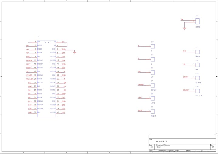

PCB Design
Just a few button boards and one GPIO shield are utilized on the PCB because there is no microcontroller employed in this project. This project, also took use of an audio board that was created for a prior project.
There are three boards made, which are the following:
The GPIO Breakout Board was designed to connect buttons and audio signals to the Raspberry Pi. It was made up of a 40-pin Raspberry Pi header and a few breakout pins.
The A-B button board, which is just a single button connected with four CON1 ports, will be used to connect a single button to the GPIO shield. Two PCBs will be used overall for the A button and the B button.
The D Pad Board, which contains four buttons connected to four different Con1 ports, will be connected to the GPIO Shield's UP DOWN LEFT and RIGHT ports, respectively.
We utilize the Cad model's outline for the layout of these three boards, positioning the switch in PCB Cad in accordance with the design's size and location.
