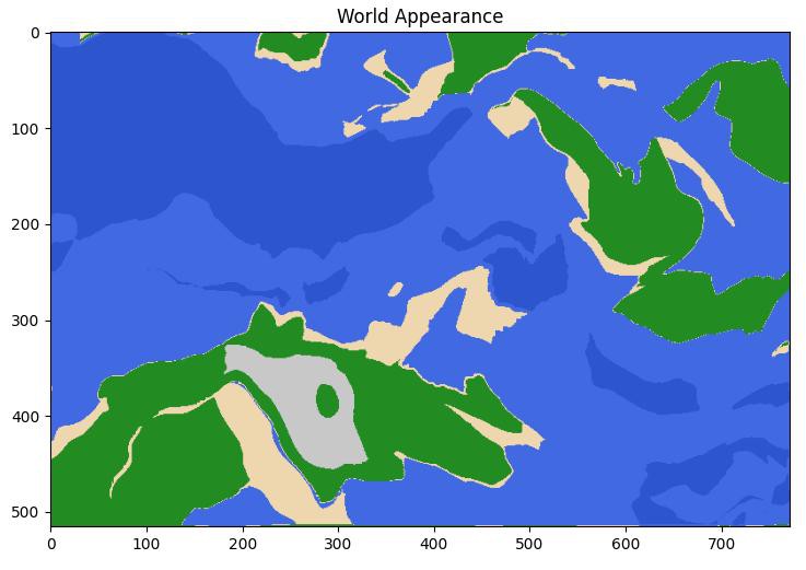

Most world gen uses perlin noise to create the heightmap, which is a critical feature of the terrain - perhaps the most important feature.  The problem, is that it isn't very realistic on a larger scale.  Here is a map of a rather large Minecraft world, generated with perlin noise like this, and it does not have realistic continents, islands, biomes, etc:
In real life, there are island chains, separated continents, deep trenches under the oceans, mountain chains, etc.  All of these features are created by plate tectonics.  But how can be simulate plate tectonics in a procedural generation algorithm?

Instead of generating the tectonic plates, it works far better to start with a square grid of tectonic plates, then project the x and y coordinates onto this grid using a bunch of cool math.  Here is the same world as the one I showed in the first image, but without coordinate transformation.  Note that faultines are still simulated:As you can see, it is very blocky.  All I did to get from this to the world you saw in the first image, was apply changes to the x and y coordinates.  This makes the blocky grid disappear, and allows us to bypass that tectonic plate issue.

For each of these features, a world config controls their strength, and the strength is then modulated with more perlin noise.  Each layer of perlin noise should have a different seed, although looking at my code, it seems I didn't do this.  Anyway, different regions of the world should have different coordinate-altering characteristics, leading to differences in the way the terrain looks and feels in different regions.
This coordinate remapping process produces a lot more interesting terrain in my opinion.

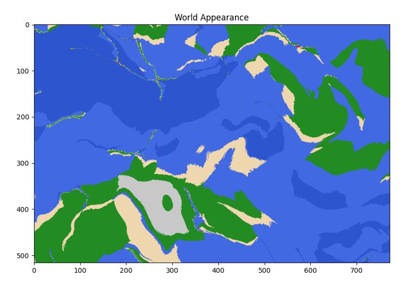

The methods above can produce a noisy and jagged map.  For this reason, I use a 5x5 average to smooth the terrain.  Here's what it looks like without smoothing:The smoothing may be too strong.  I don't know.  But it certainly needs some smoothing.

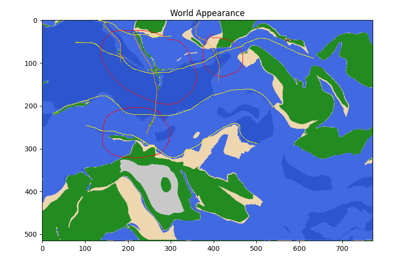

Some parts of the map still have evidence of the underlying grid pattern for the tectonic plates.  You can see this in the upper, leftish-middle portion of the map, where there is this odd plus-shaped island.  This is an artifact from the grid used to generate the map.  It's harder to see, but there is another artifact below that.  It is particularly visible in oceans.  Here, I circled them and drew lines to make it more obvious:The orange lines show the top-to-bottom dividing lines on the grid.  The yellow lines show side-to-side.  Red circles regions that look unnatural due to the grid showing through.  Now that I point out the grid, can you see the pattern in the volcanic activity, coastlines, and islands?  Suddenly it looks a lot more organized.  Ideally, this would be completely indiscernible, and for most of the map, it is.

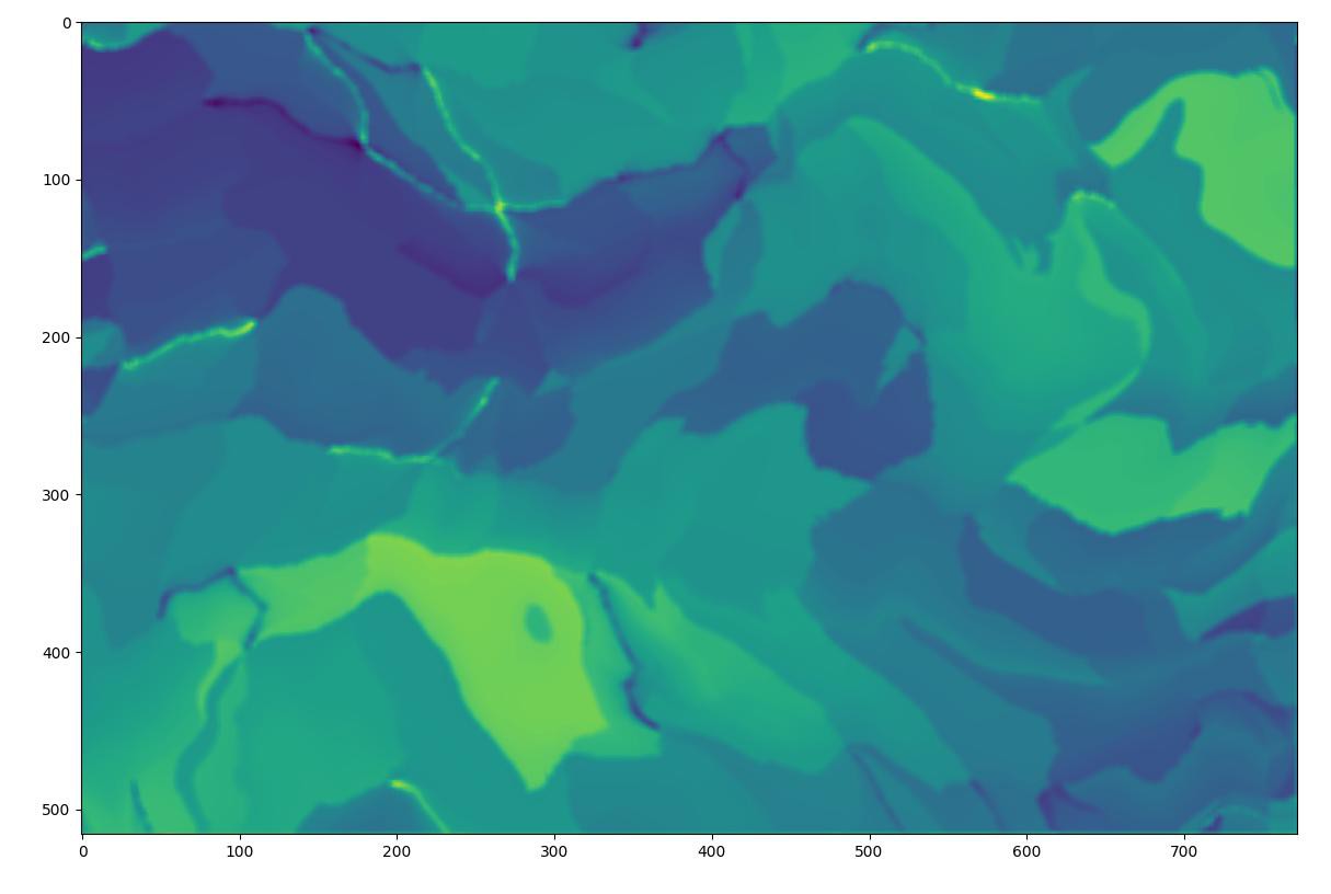

Real quick, here's an image of the heightmap this world has:Some of the trenches in the north are very deep, and some of the faultline islands have tall mountains.  Very fun.

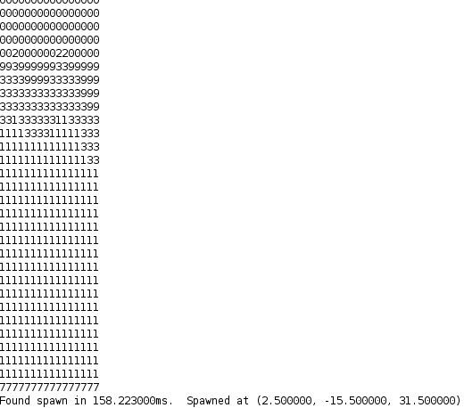

After I got an algorithm I like, I needed to port it to Arduino.  This was much easier, and the worldgen runs quickly too:You can see that the world has generated, although my ability to look at it is quite limited at the moment.  Each chunk generates in about 16 to 17 milliseconds.  Since it is not guaranteed that any particular chunk will have land, or be without volcanoes, I had to make a function to generate a few chunks until it finds one with a suitable spawnpoint.
