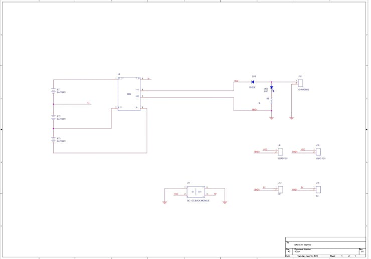

Battery Board
The BMS and the DC Buck Module were the project's two primary components; therefore, we began the electronics design process by creating a schematic for the battery board. A battery management system, or BMS, is used to control or effectively charge and discharge lithium cells while they are in use.
We are utilizing a 15A BMS, which enables a 3-series cell setup, which requires connecting three lithium cells in series with the BMS. This device has a nominal voltage of 11.1V and a maximum voltage of 12.6V.
The battery pack only requires 13 volts to be charged because it has both low- and high-cut features. This is because the cells require a voltage greater than 12.6V to be fully charged; therefore, 13V is sufficient to prevent potential deference.
The battery management system (BMS) controls the cycle of cell charging. If a cell has an uneven voltage, for instance, one cell has 3.5V and the other two have 3.7V, the BMS will stabilize the voltage of each cell and bring them all to the same level, meaning that once the battery is changed, all of the cells will have 4.2V.
Our objective in the PCB design is to mount the BMS on the board, as it has some pads on the bottom and all the components are placed on the top, enabling us to solder it as a module on a circuit and then install the battery pack on a circuit using an SMD 18650 Cell Holder coupled with the BMS.
In order to create a 3S configuration, we added three 18650 cell holders to the schematic and linked them all in series. Next, we connected the GND of each cell to the GND port of the BMS; the 3.7V of the first cell goes to the 3.7V port, the 7.4V of the second cell to the 7.4V port, and the 11.1V of the cell to the BMS 11.1V port.
To obtain the cell output, we use the VCC and GND ports on the BMS. This part is controlled by BMS ICs and quite a few mosfets. When the cell voltage hits a minimal cutoff threshold, which is approximately 2.5V, the mosfets cut the power of the VCC, preventing any device from totally discharging the cells.
In addition to the 12V ports, we also added a few more parts, such as an SMD diode coupled with an LED and a resistor that is connected to a CON2 port, which is used to charge the battery pack. The diode is directly linked to the VCC port and drops the extra voltage that is coming from the CON2 port.
When power is applied to the CON2 port via an LED and resistor, the LED illuminates and functions as a charging indicator when the charger is plugged in.
A DC-DC Buck converter module has also been added. It accepts a 12V input and steps it down to a stable 5V/3A for powering the Raspberry Pi.
Following the completion of the project's schematic, we created the board file utilizing the PCB layout from the Cad design, placing the cell holders on the bottom and all SMD components on the top.
