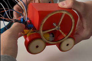

This article will not only explore the fundamental principles of the automotive differential, but also demonstrate, step by step, how to assemble this mechanism using 3D printed parts and a DC motor to transmit motion. With a detailed design and clear instructions, you will be able to understand and replicate the operation of this vital component. Read on to discover how 3D printing technology is revolutionizing mechanical systems prototyping and education, bringing complex concepts into practical, accessible reality.

The structure of the differential mechanism is presented below. See the complete structure. All parts of the mechanism were printed with SLA technology,...
