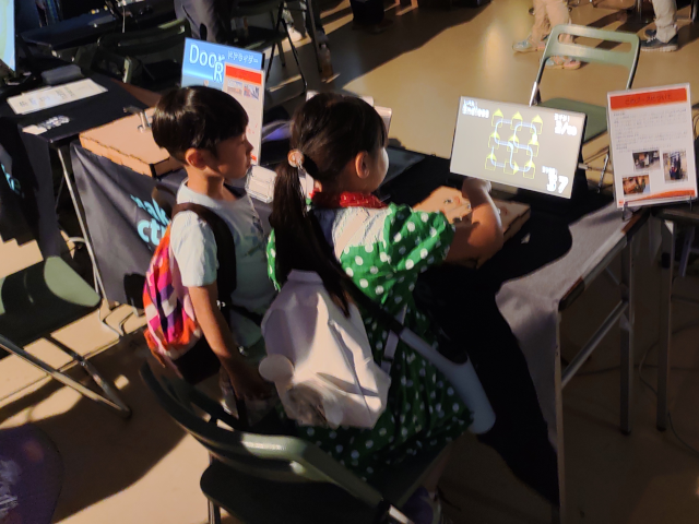

The game starts when you turn any cylinder on the title screen. When the game starts, the train will start running automatically. The panel on the screen is linked to the cylinder, and when you turn the key, the panel also rotates. You cannot rotate a panel when the train is on the panel. When the train hits a dead end, it will turn around. Your goal is to collect all the coins within the time limit.

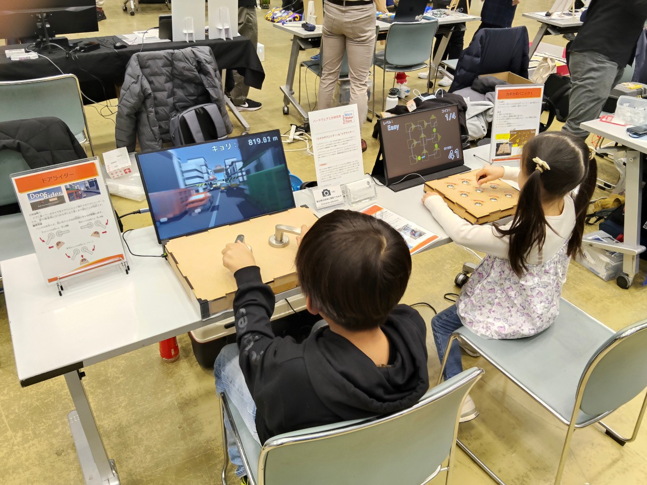

The controller has 9 cylinders, and you can turn any cylinder with one key. The rotation range of the cylinder is 90 degrees. So the cylinder has two status, Up and Right.
The outside is made of laser cut MDF (55mm thick).
The controller system consists of a Raspberry Pi Pico and multiple photo interrupter modules. The photo interrupter module can recognize the cylinder status, and the Raspberry Pi Pico collects the status from each photo interrupter module. Then the Pico sends this information to the game (PC).

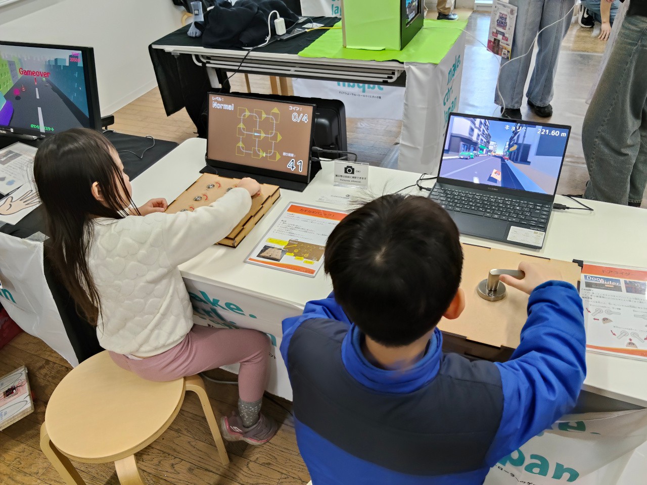

The level is selected by the cylinder you turn at the start. The time limit is 60 seconds and the coins you should get are 4 at any level.
  • Easy (left column)
    Small map, all coins are displayed from the starts, very easy.
  • Normal (middle column)
    Small map, only the next coin is displayed, easy.
  • Hard (right column)
    Big map, only the next coin is displayed, very difficult.
