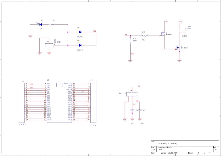

Following the model's completion, we created the project's schematic, which was divided into three main sections: the input section, the Pico Setup, and the Mosfet switch setup.
The input section comprised of an AMS1117 3.3V Voltage Resulator input connected in series with two diodes and a DC barrel jack whose positive was connected. We have added a 10uF 50V 1206 capacitor to the AMS1117's input side and a 1uF 50V 1206 capacitor to its output side.
There's also an LED connected with a resistor in series linked to the positive of DC jack before diode; this LED will act as a power indicator.
Next comes the Pico Section, where the AMS1117's output terminal is linked to 3V, and GND is connected to GND. The AO3400 Mosfet's gate is wired to Pico's GPIO0.
Two mosfets are utilized in the mosfet switch arrangement because the IRFZ44N is a high current, high voltage mosfet with a gate-source voltage of 12V to 20V. Because our pico GPIO can only output voltages lower than 3V, this is insufficient to completely turn on the mosfet.
In order to address this issue, we added an additional mosfet, the AO3400, and wired its source to the IRFZ44N Mosfet's gate and drain to 12V. In this case, the gate-source voltage of the AO3400 is less than 4.5V, which is ideal for The PICO.
