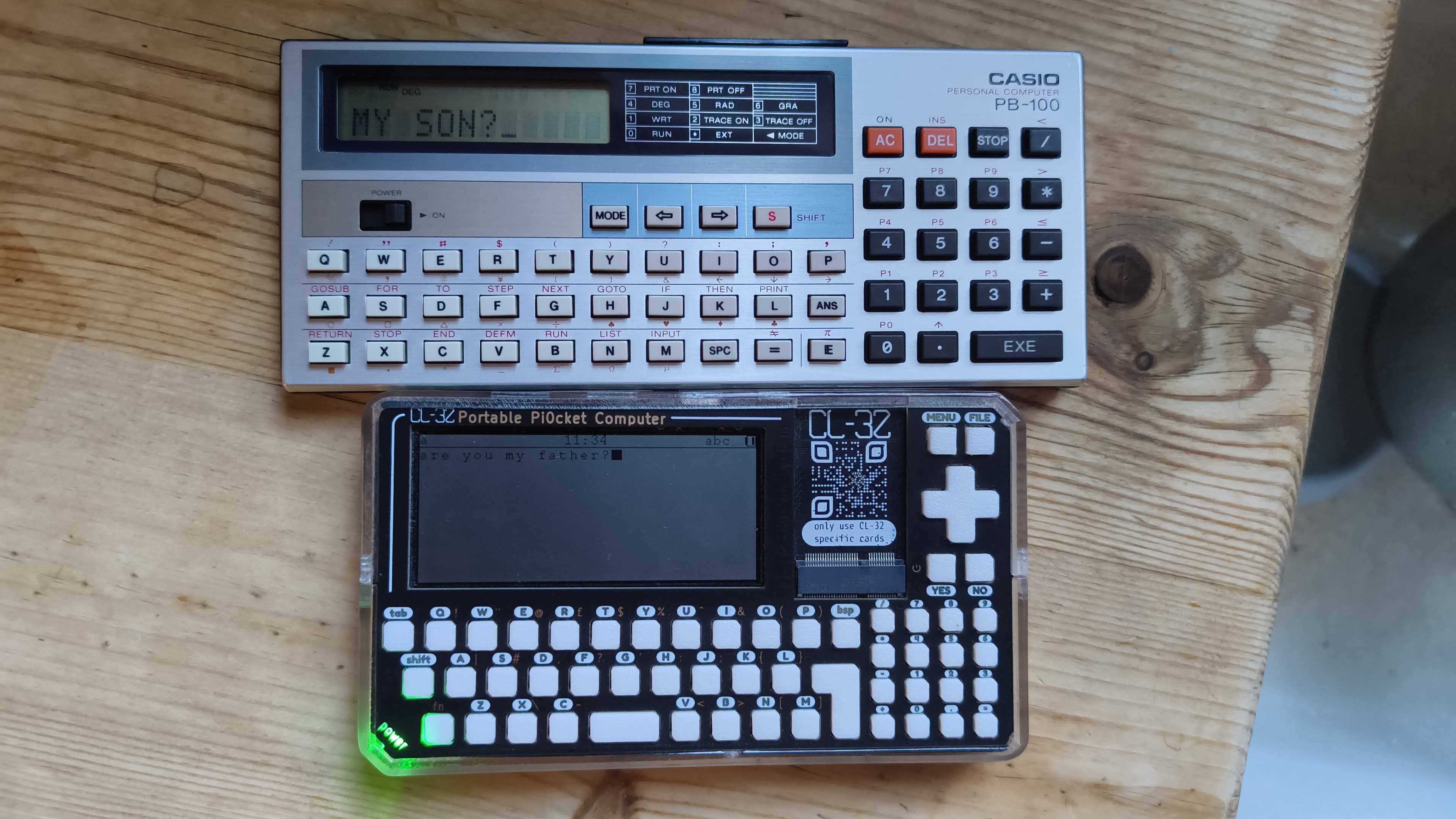

Things are going pretty well, although slowly!! When I spotted the latest retro contest I thought it was time to break that dry spell!!
This project is massively inspired of the pocket computers that are now super retro
You can see the influence here!! This Casio PB-100 was released in 1983, and is still going strong all these years later
It is not coincidence that I have the offset screen and that number pad over on the right. In fact someone mentioned that my device has a Striking resemblance to a rolodex AlphaCard
so yeah, what is old is new again!!
