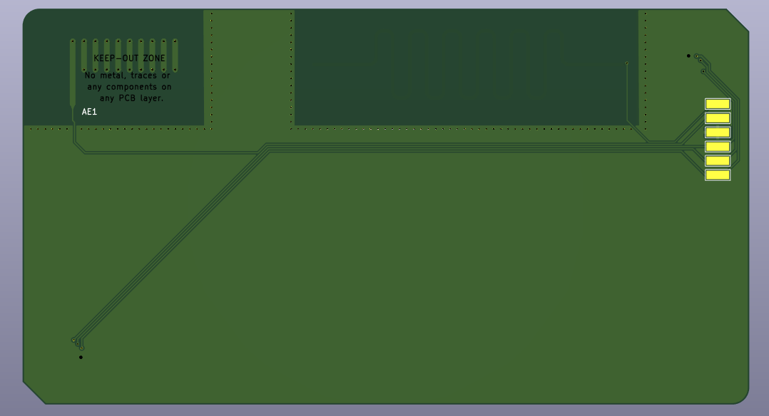

Speaking of which, i had the idea of trying to make the back PCB a bit more useful and bake in some small PCB antenna's.
I know they wont be great, but should allow some basic functionality, and no doubt the spring connectors between the boards will mess things up big time, but you never know until you try!!
The antenna on the left should be LoRa frequency, and the one on the right should be good for 433mhz for some general wireless shenanigans.
