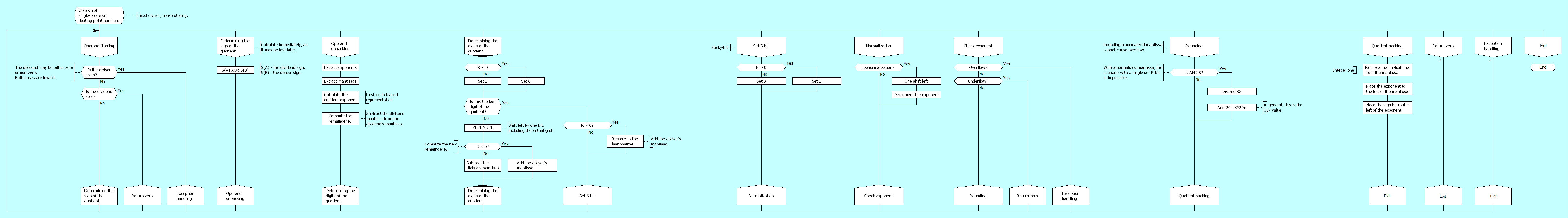

To prevent the input of invalid numeric strings, a simple finite state machine is implemented to parse key presses. The state diagram is presented below:
The current state is stored in the stack as the address of the label to which the program should jump during the next keyboard interrupt.
