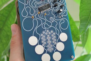

This video covers the original idea, the three different designs I went through, and the final outcome, along with me handing it over! It was such a fun and over the top build.
Part of what makes it funny is the track, The Shipping Forecast that it related to, was actually originally meant to be a joke that djh0ffman spent far too much time on, and so me putting this amount of effort into this followed that path too... The track is below the video.
This is the Amiga Protracker MOD of Shipping Forecast
This is the list of parts from the video:
• Compatible with ATTiny85 Digispark: https://amzn.to/4fMXetc
• AAA Battery Holder: https://amzn.to/4cgPlsW
• 2W 8Ohm Speaker: https://amzn.to/4cjELBe
• Deluxe Paws Seagull with Chip in Mouth: https://amzn.to/4dbHJt1
• Genuine DFPlayer Mini (beware of fakes!): https://thepihut.com/products/dfplayer-a-mini-mp3-player-for-arduino
• Vibration Sensor: https://amzn.to/47e7k2q
• 2N7000-D74Z Mosfet: https://amzn.to/4dKIn0U
• PCB Design: https://www.pcbway.com/project/shareproject/The_h0ffinator_f27a7f44.html
• Source Code: https://github.com/RobSmithDev/h0ffinator
• Tinkercad PCB and Speaker Box Design: https://www.tinkercad.com/things/hInKjIx1hZ3-way-too-rude?sharecode=r1AbtKWk9Oygoa5iFuZ_c0MesyJj0AxJ1bbJgIq4ER4
