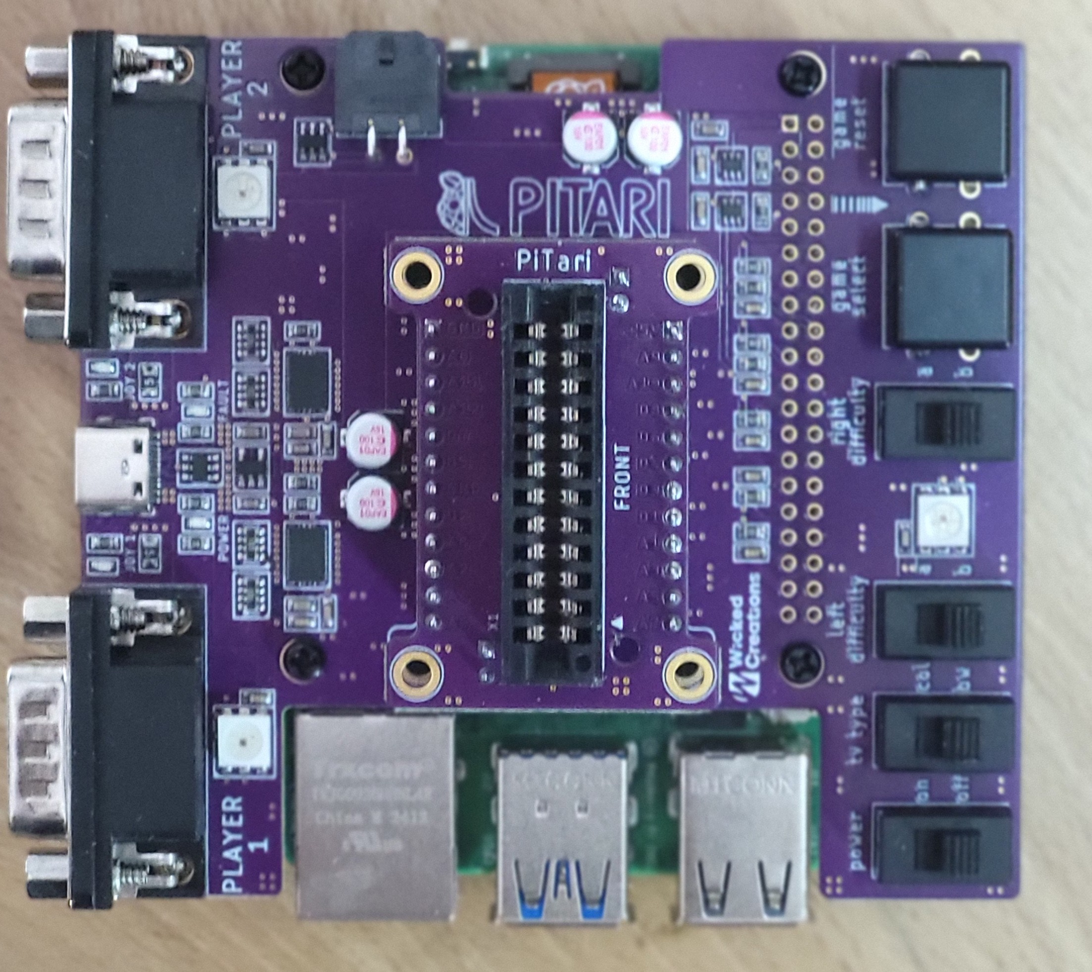

We’ve just received our first PiTari PCB samples! Holding these purple boards in hand is a thrill: the reproduction of the original Atari 2600 buttons and joystick ports looks and feels incredibly authentic. Combined with the Raspberry Pi’s standard HDMI output and crystal-clear audio, it’s like capturing the look and feel of vintage electronics with the convenience of modern-day hardware.

As I barely finished the first board design for the PiTari Raspberry Pi HAT, I realized — this could be done better. And by better, I mean easier. And by easier, I mean easier for me. Easier to design, easier to debug, and definitely easier when it comes to writing the software.
So, I asked my good friend and electrical engineering wizard @AnthonyL to take a look and, well… before I knew it, we were redesigning the whole thing.
Before we even contacted a board house for early-stage PCB production, we were already improving the concept. Since we needed at least one I/O expander to handle all read/write operations to the Atari 2600 cartridge’s EPROM, we also added voltage level translators — to safely bridge the cartridge’s 5V logic with the Raspberry Pi’s 3.3V logic.
Enter the NXP PCAL9722: a 22-bit general-purpose I/O expander with some very attractive features. It has built-in bidirectional voltage-level translation (between the SPI interface [1.1V–5.5V] and Port P [1.8V–5.5V]), which means it can potentially replace an entire chunk of our original circuit.

We also ditched the I/O expander from the joystick ports. The Pi has enough GPIOs available, and we figured this might even reduce potential input lag.
Oh — and we swapped out the old-school power screw terminals for a USB-C connector, because… it’s 2025. Why not?
We also tossed in a few SK9522 RGB LEDs... because they were lying around and, honestly, blinky lights just make everything better.
