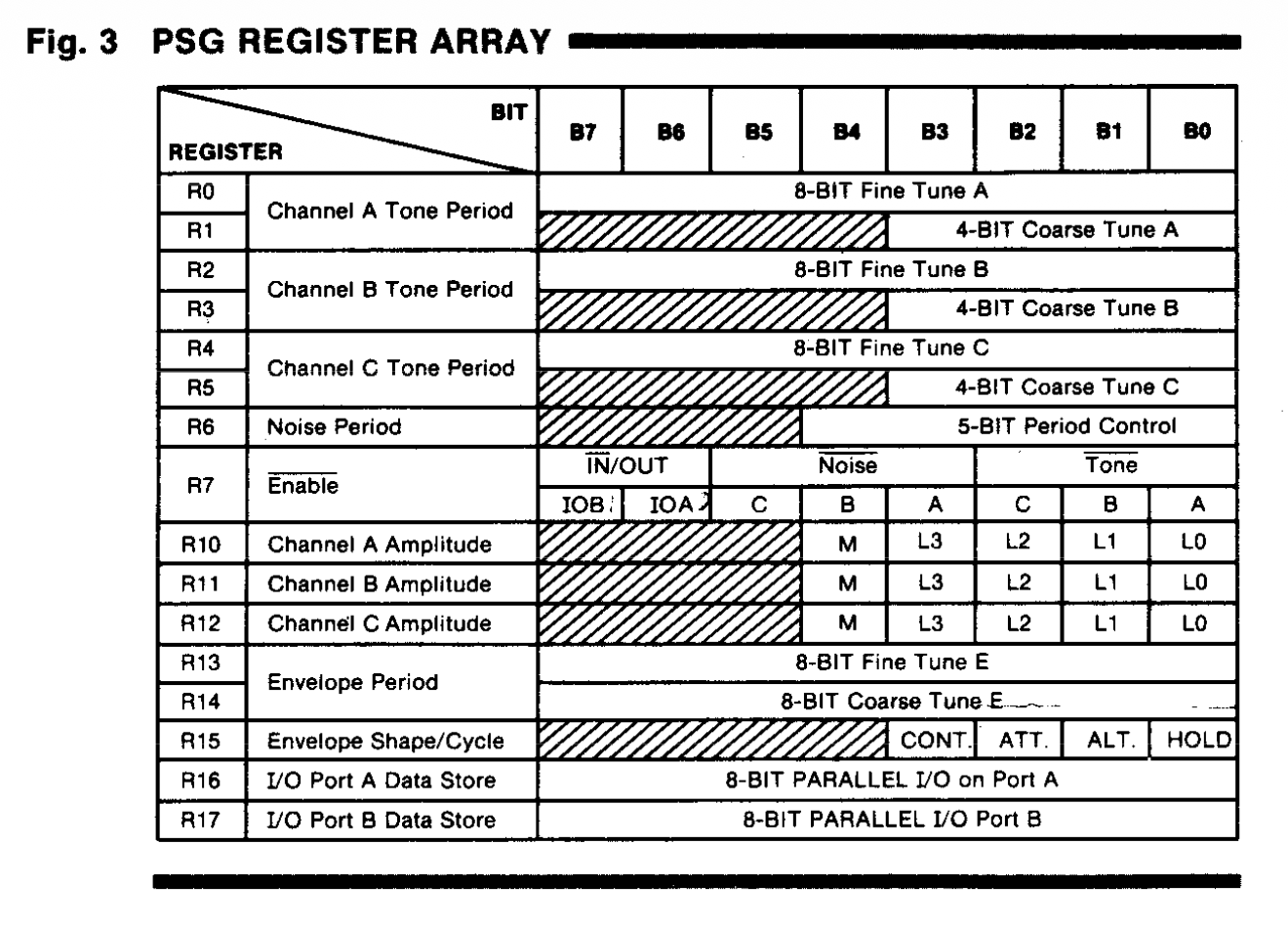

So I gave the Mockingboard a stab back around 2019 somewhere. I started by finding documentation on the AY-3 and trying to code an AY3.cpp module. I never got very far; it's fairly complex, and it wasn't clear how I would test that it was performing correctly. And I was sort of pigeonholing it into the role of a sound engine, instead of a general sample-rate fixed-point generator. On the shelf it went, until I decided to look at it again in April. After getting the audio buffering WSOLA driver working well, I wanted to hear what audio could have sounded like if I'd had the money around 1985.
Instead of trying to make a cycle-accurate hardware reproduction in software, I went for an approximation. I wired it in to the WSOLA layer of my SDL build, so I could test that things sounded right; and did a substantial amount of playing something in another emulator (mostly Virtual ][, still my go-to) and seeing if it sounded more or less the same as what i was generating.
Starting from the inside and building out: the AY takes 16 register values and elapsed time, which are output as samples. The datasheet is still king:
From those, the output sample is: for each of 3 channels, if the gate is high, add a table-driven amplitude; sum; clamp. That's it, straightforward DAC. So I started by finding references for the 16-value amplitude table...

Some notes here: this clamps at 0x1FFF (8191) so that 3 voices summed stay under 16 bits without overflowing. That peak made sense to me, but I'll admit this is about where I got stuck last time around, and it's not like I've spent significant time researching how the Mockingboard worked in the intervening years. No - my research here was in source code for other emulators. I needed something to get myself started so I looked at the AppleWin and KEGS source code. They both have tables too, and by reading the source and then trying to understand the data through the datasheet for the chip, I understood just about enough to wrap this in a .wav file generator that could give me the 16 (well, 15) sample amplitudes (volumes) represented in the table.
Also note here: I'm pretty sure I just calculated my numbers as a normalized log table. The datasheet's curve gave an approximate response, that's the ballpark I'm modeling here.
The chip's got 3 channels, so I need to mix them (add the values). And there's a noise generator (which I clearly modeled on the...
