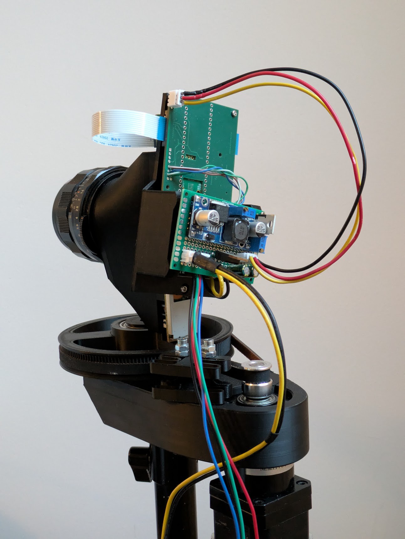

By using a RP2350 to directly interface with the ADC found on the sensor assembly it allows for high quality data capture and direct control over exposure. To store the data a SD card is used which allows for high speed data storage using the 4-bit SDIO protocol.
Pi pico connected to the sensor assembly

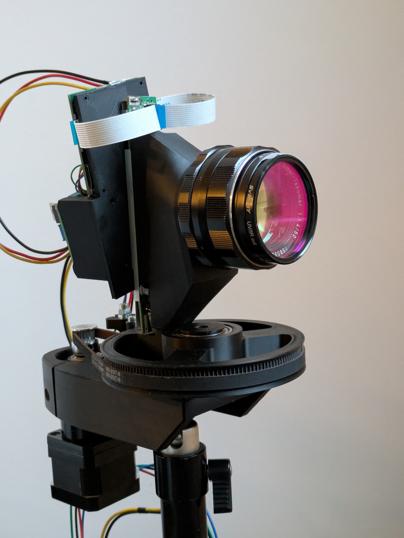

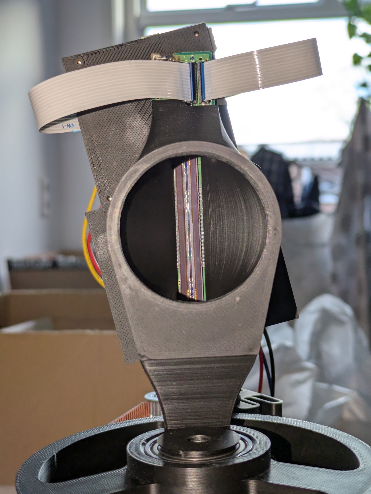

The panorama mechanism uses a 3d printed base that mounts to a tripod. It houses a geared stepper motor  and a rotating platform connected to the base by two large diameter deep groove bearings. On top of the platform a camara body is mounted which houses the sensor with the electronics and a lens mount. The rotating platform is driven by a belt connected to the geared stepper motor. The lens m42 lens mount allows for a large of range of lenses. Note with a different focal length the scan angle per line has to be different.
Linear CCD as it sits in the camera body
Backside of the PicoPan
Front of the PicoPan

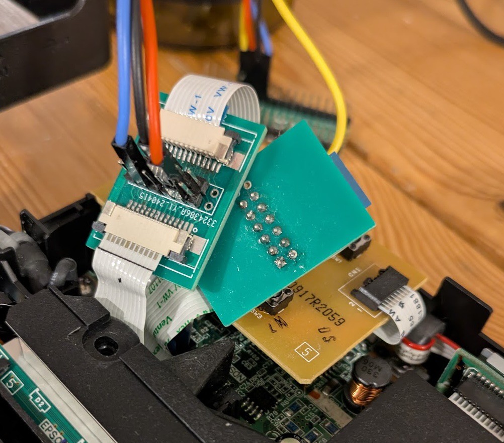

To get the data of the AFE it uses a 8 bit parallel DDR data bus. For configuration it uses a serial interface. As the CCD has no public datasheet i captured the data being sent from the main board from the scanner to the sensor board.
FPC sniffer board made to capture the data being sent from scanner main board
This sniffed data is then used to reconstruct the register settings of the AFE.
