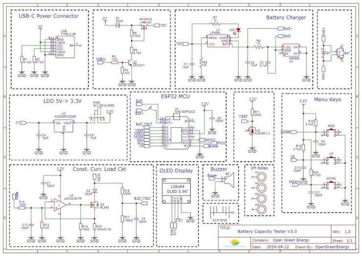

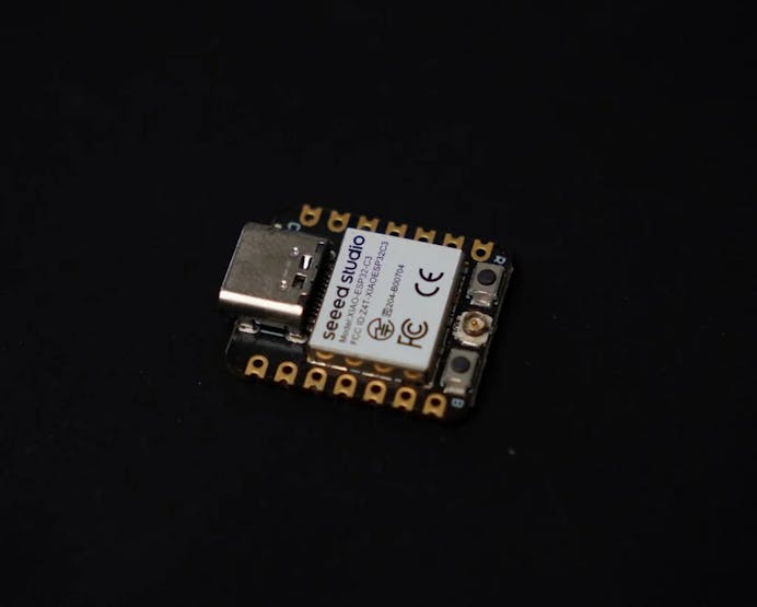

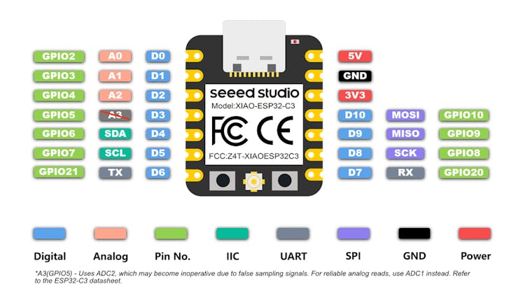

1. XIAO ESP32 Microcontroller:
The new version uses the XIAO ESP32 instead of the Arduino, providing a smaller footprint while adding WiFi capabilities. This allows for remote monitoring and control, enabling users to track battery testing results from anywhere.
2. Integrated Charger Circuit:
Unlike the V2.0, which required an external charger to fully charge the battery before testing, the new version features an integrated charging circuit. This allows users to charge and test batteries in one go, making the process more streamlined and convenient.
3. Compact SMD Current Sense Resistor:
This version replaces the bulky ceramic resistors used in V2.0 with a compact SMD current sense resistor. This not only saves space but also improves efficiency by reducing heat buildup, making the tester more compact and easier to handle.
4. Onboard Battery Holder:
It includes a 18650 battery holder directly mounted on the PCB. This enhancement removes the need to connect batteries externally through screw terminals, which was the case with the V2.0 model. Now, users can simply insert their 18650 battery into the onboard holder for quick testing. Additionally, a JST connector is provided for connecting LiPo batteries or other battery sizes that don’t fit the 18650 holder, offering more flexibility in the types of batteries that can be tested.
5. Firmware Upgradtion:
The current firmware now supports four modes:
  • Charge Mode: Direct battery charging with the built-in charger circuit.
  • Discharge Mode: Continuation of V2.0’s battery capacity testing by discharging.
  • Analyze Mode: Automatically charges, pauses, and discharges to measure true battery capacity.
  • IR Test Mode: Measures the internal resistance of the battery condition evaluation.
6. Cutoff Voltage Setting: Users can now set the discharge cutoff voltage using push buttons and the OLED display, eliminating the need to modify and re-upload code.
