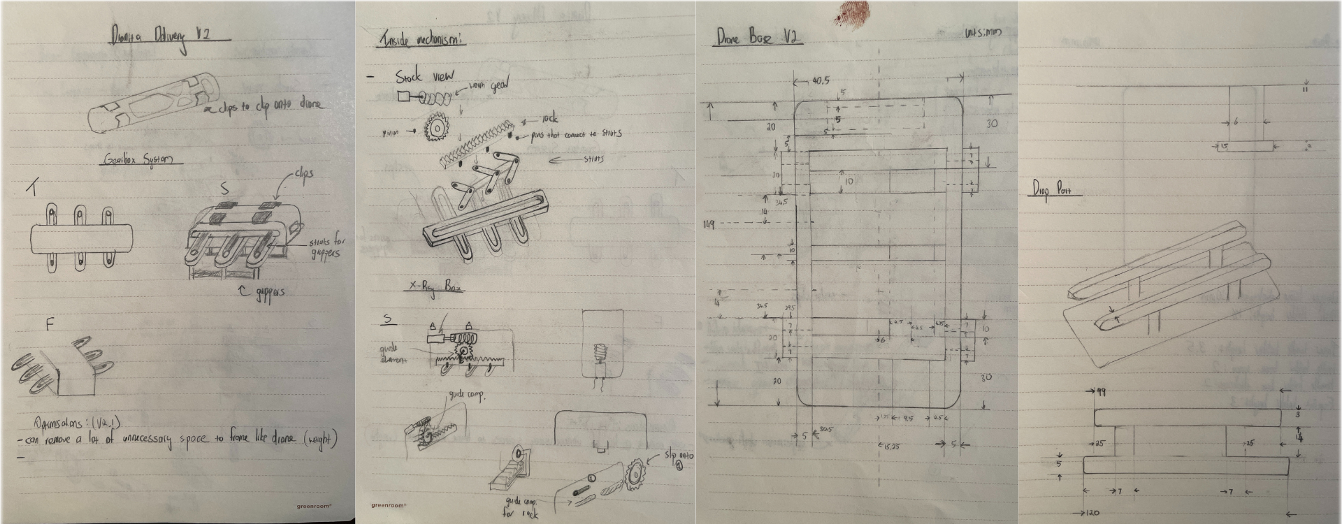

    Now stick with me here, because this is where things get exciting 🧐. Designing these components turned out to be both a fun and challenging process, requiring multiple iterations to get just right. The main goal was to create a design that’s easy to assemble, compatible with a wide range of drones, and both robust and practical.
    (a few early sketches ✍️)
    After finalizing a design robust enough to handle multiple drops, we can now take things to the next level by leveraging, wait for it…

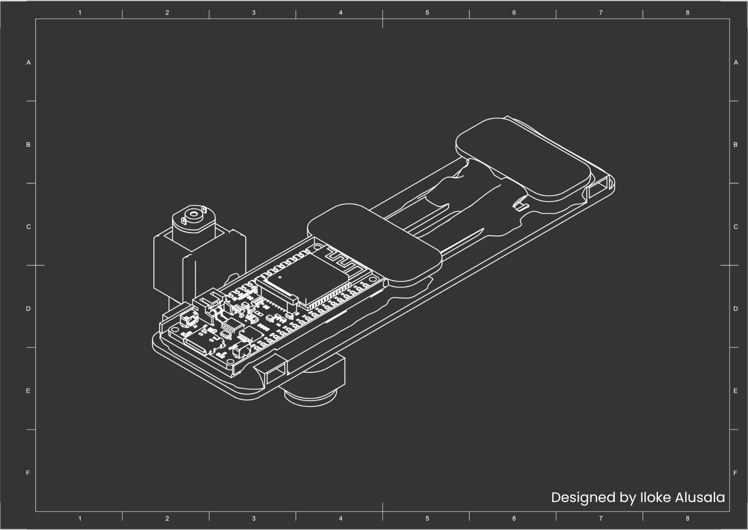

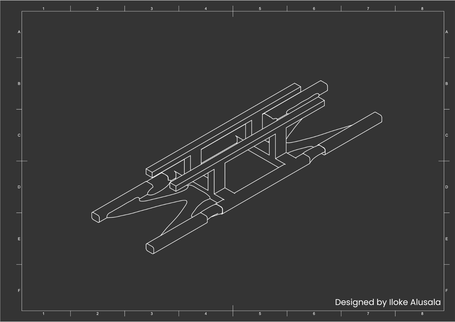

    After considering all factors, I developed the final drop mechanism, which consists of two parts:
    1. Droke: The component that attaches to the drone.
    2. Flatch: The part that drops along with the package.
    The Droke
    The Flatch
